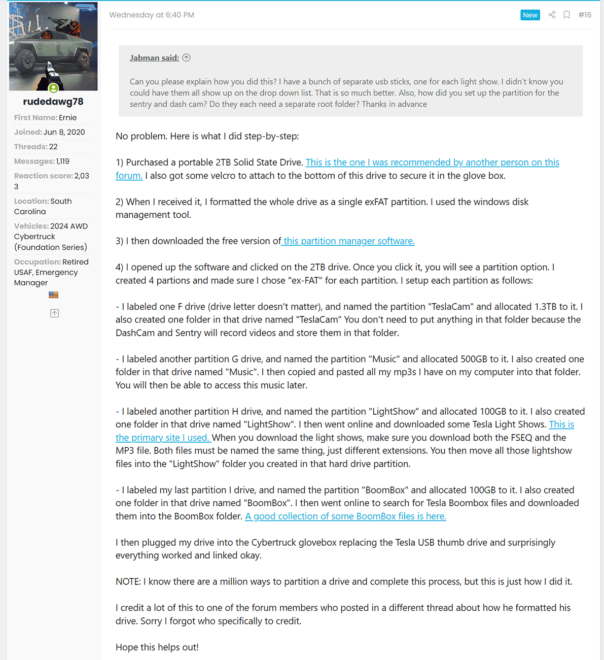

This is a great post... My question is why did you allocate so much space to the Boombox? 100GB seems like a ton
It really is waaayyyy too much. No reason really. I think I felt that each partition has way too much that it required, so way not over allocate the BoomBox partition. lol
You really could just do like 5GB (still too much) and push the rest to TeslaCam or Music.

@panthar - from what I understand you can. Look at @rudedawg78 's post above on partitions.
