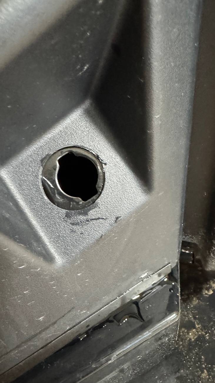

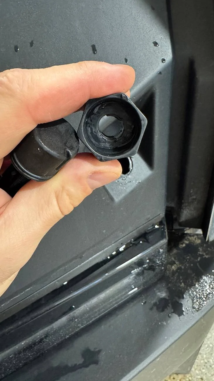

On the frunk it's rubber stoppers that are easy to adjust. Twist the rubber stopper left pull it out for height, in for depth, twist right to lock it.
Here are more pictures of the stoppers if needed
