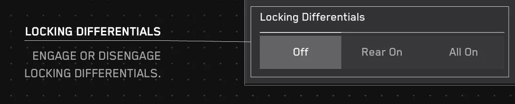

On a side note, this is the first I've seen of the off-road guide. A few pages later there is also a picture of the controls showing that we can set the locking diffs to Rear On or All On.
Tesla Cybertruck NPS Definition of 4WD vs CT Off-road Mode 1733774094332-v2

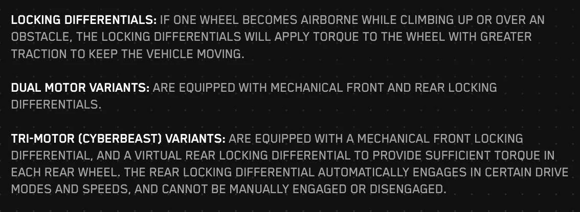

Then listed on page 15 of the document we get this nugget:
Tesla Cybertruck NPS Definition of 4WD vs CT Off-road Mode 1733774364465-vi
Seeing this doc for the first time I'm much happier with the idea of going pretty much anywhere I would be comfortable or even find a bit challenging in my CT. If the government wants to fine me, I'll just pull up these specs.
