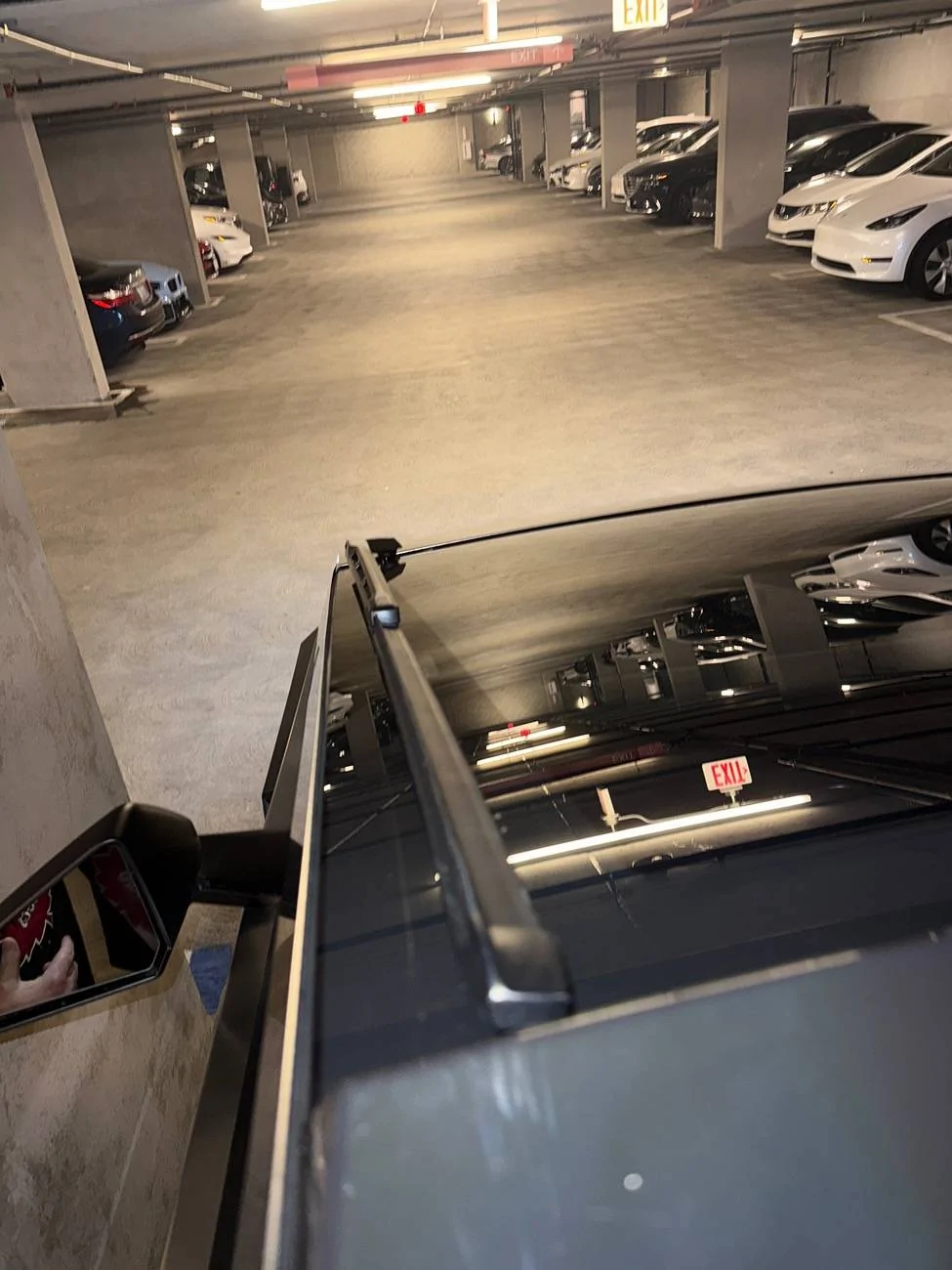

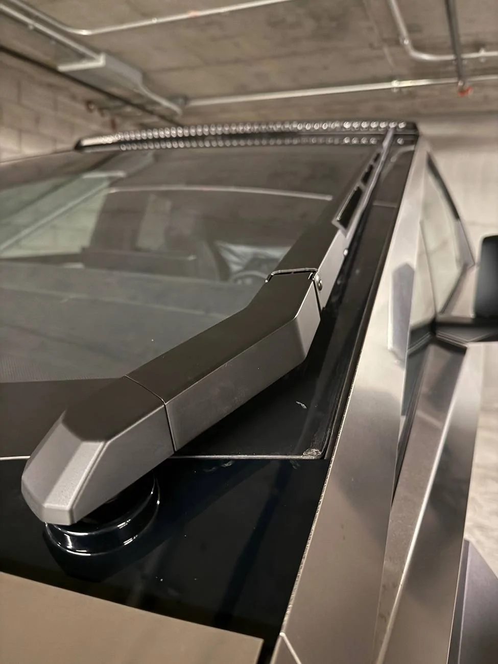

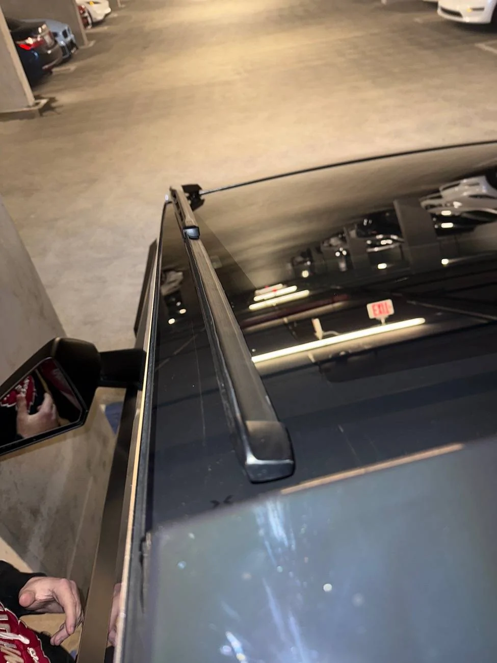

I can take a picture in a bit, see if that shows you anything. But I probably won't video the wipers fluid bc I wanna be moving so my clean truck doesn't cry fluid.
Cybertruck26
Chris 🇺🇸 🇮🇪 🇨🇦
Apr 10, 2023
859
504
Bay Area, CA
Cyberbeast (07/2024 delivery)
Veteran, Engineer, Space 🤓
Interesting you got a different part number than I did… Can you tell a difference in the blade from before?
Best I can do in my garage.
