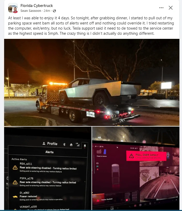

The Error seems to be redundancy sensors. That sounds to me like it's the front SbW steering.
If so this "Critical Warning" is obviously a new one for Teslas, in that no other Tesla's have SbW. The question is, is it a false positive (code bug, momentary comms or sensor) or an actual failure of one of those, and is the "Critical Warning" intentionally overly sensitive to these events to make sure nobody gets hurt because of them?
From memory, there are three redundancy sensor and comms systems on the SbW, but only two mechanical actuation redundancies. So this could be a 1 in 5, or a 5 out of 5 system failure.
Can you enter the Service mode and maybe find out the exact error code and explanation of that?
I'm sort of hoping it's the same across all of them, so it has a common cause that can be fixed with a recall. If they are different, it might be a wider issue.

They did not other than the LV Harness being faulty and replaced. So tomorrow I am going from the S.F. Bay across the state to Reno, NV then to South Lake Tahoe. Good test.

Update: I picked up my Cybertruck Wednesday, March 7th after they replaced my Low Voltage Wire Harness. I drove 15 miles home without an issue.
This morning, I drove from the SF Bay Area to Reno, NV, then over Mt. Rose (8,911 feet) down to South Lake Tahoe for a total of 318 miles. No errors or alerts.

Hey man, so I’ve identified 4 of us now that have the same issue, almost certainly centered around the 48v harness. The other 2 are located here in Florida and are currently waiting 2-3 weeks now for updates from Tesla. Seems to be a bigger issue than anyone is reporting on.
