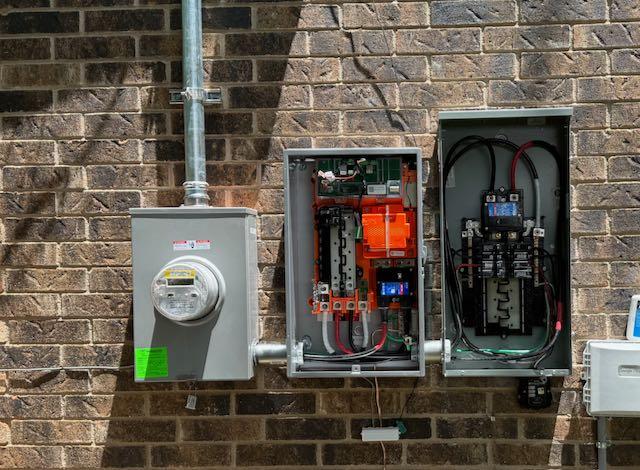

I recently completed my PowerShare installation, after a few months of waiting (the delay was due to the utility company).
The work was by Smart Charge America, and they did a great job. My cost was $7,700 but that included whole new electrical service, since my 80's-vintage equipment was inadequate.
Tesla Roadster 2nd gen My PowerShare Experience IMG_0107
Everything outside is all-new:
Tesla Roadster 2nd gen My PowerShare Experience IMG_0115
The cost breakdown:
EVSE: On-Demand Delivery, Mounting, Configuring, Syncing, Testing, Ongoing Training$ 149.00
Scope of Work: TESLA 3V Backup Gateway (TESLA SUPPLIED)$ 2,127.00
Scope of Work: Install TESLA Wall Connector (TESLA SUPPLIED)$ 2,133.37
Scope of Work: 200A UPGRADE SERVICE to HOME Electrical System$ 2,700.00
Municipality: City of Austin, Texas: Permit/Inspection - FULL PURPOSE$ 349.00
Electric Utility: Austin Energy: Disconnect/Reconnect Coordination$ 225.00
This did not include the $500 for the WC pedestal that I purchased myself, and the installation cost included trenching and a concrete pad.

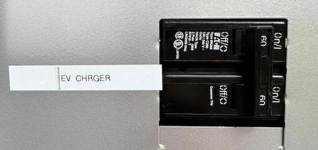

Tesla Roadster 2nd gen My PowerShare Experience IMG_0186
I guess they did save me a little money in lettering by leaving the "A" out of "CHARGER".

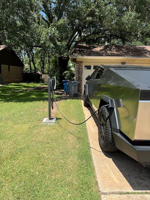

Tesla Roadster 2nd gen My PowerShare Experience IMG_0133
The finished product!
