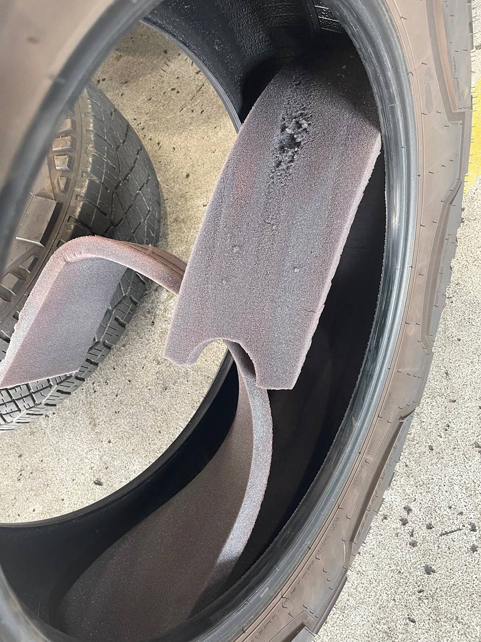

I guaranteed it is foam separation in one of your tires. Same exact thing happened to me. Brought it to the SC and I told them that it is the foam in the tire. I took it out for a test ride with a tech and he said it was a front inverter. I told him it was a tire or multiple tires. He said it was an inverter. I said IT’S THE TIRES!!! So they proceeded to give me a loaner and put a new front inverter in. Fast forward 3 days later…………..Picked it up and started on my way home. 4 miles from the SC is the highway which I merged onto and at 71 miles an hour it started shaking again. Turned around and headed back and asked them if they test drove it. They said yes they did, but couldn’t go too fast since the speed limit in the area is 45. I said the highway is 3.8 miles from here and no one decided to take it up to the speed in which I told them it happened. So make this boring story short, I told them the tires are bad and to check them. Here is the result………
Tesla Roadster 2nd gen Motor induced vibration? IMG_2356
THE FOAM SEPARATED.
So I got a new inverter out of the whole ordeal and fucked up tires that they won’t warranty. That’s a whole other topic that was addressed in a previous post.
