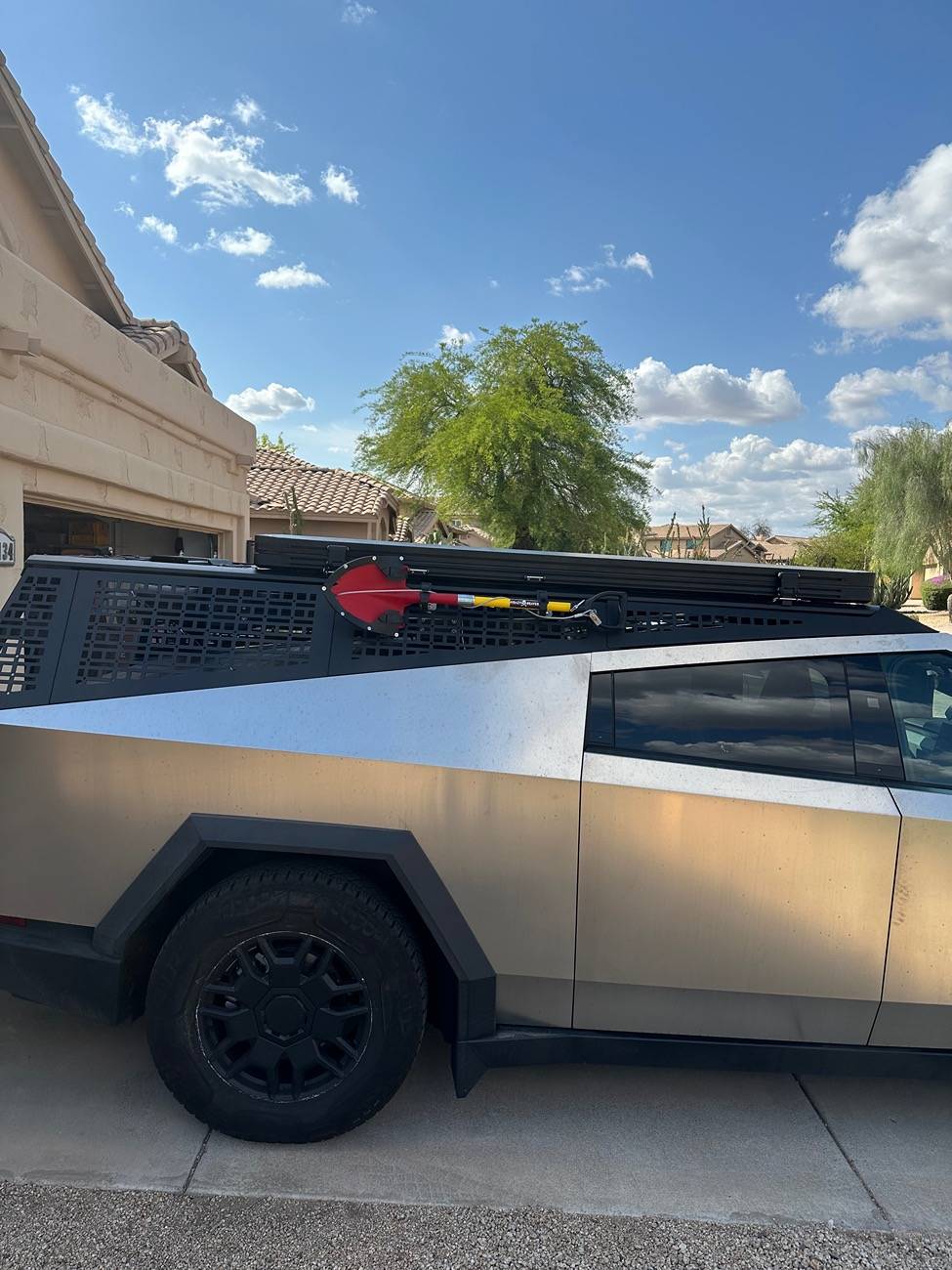

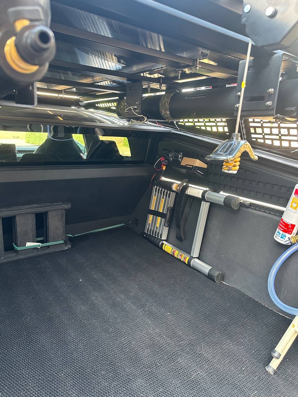

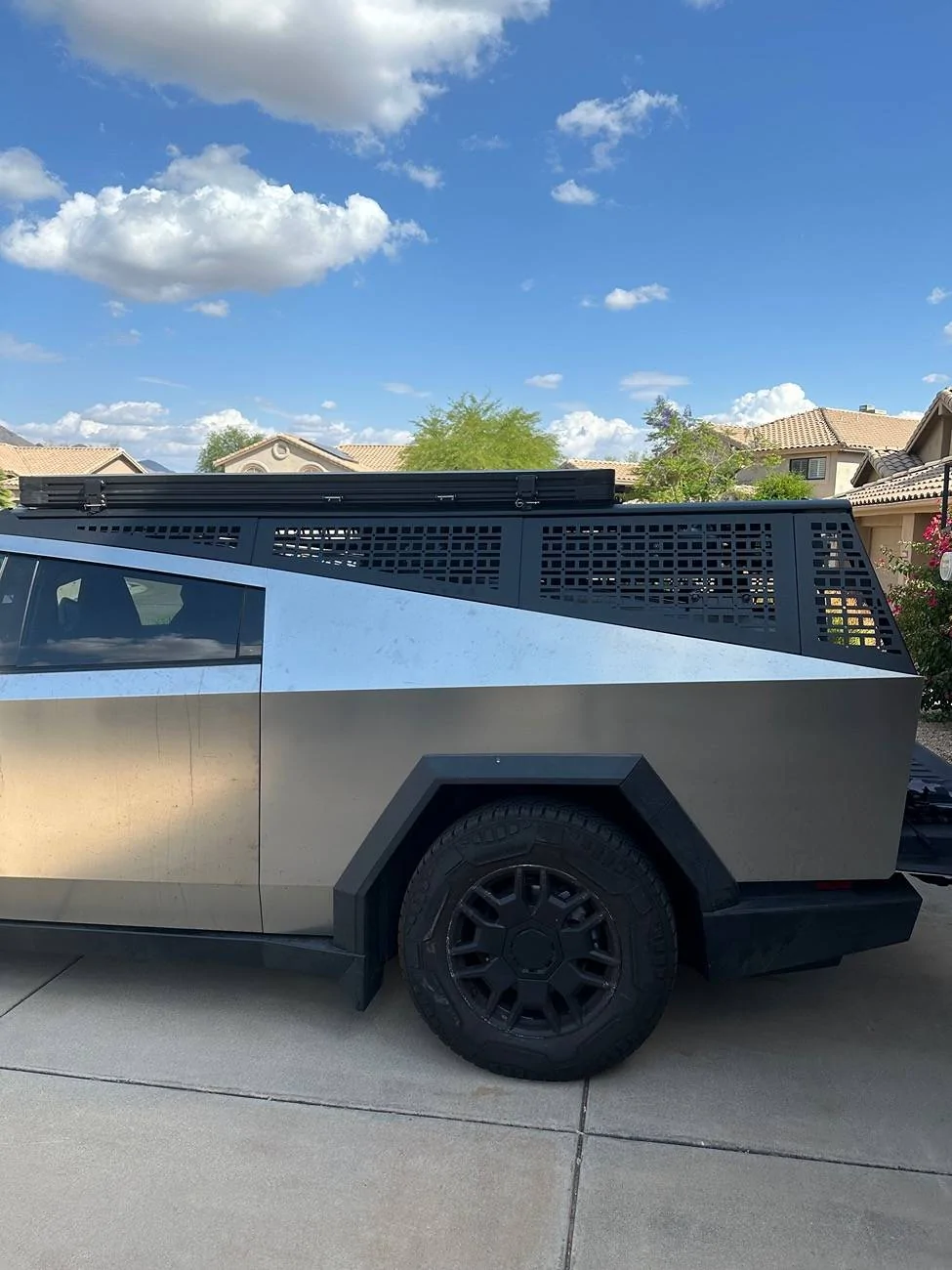

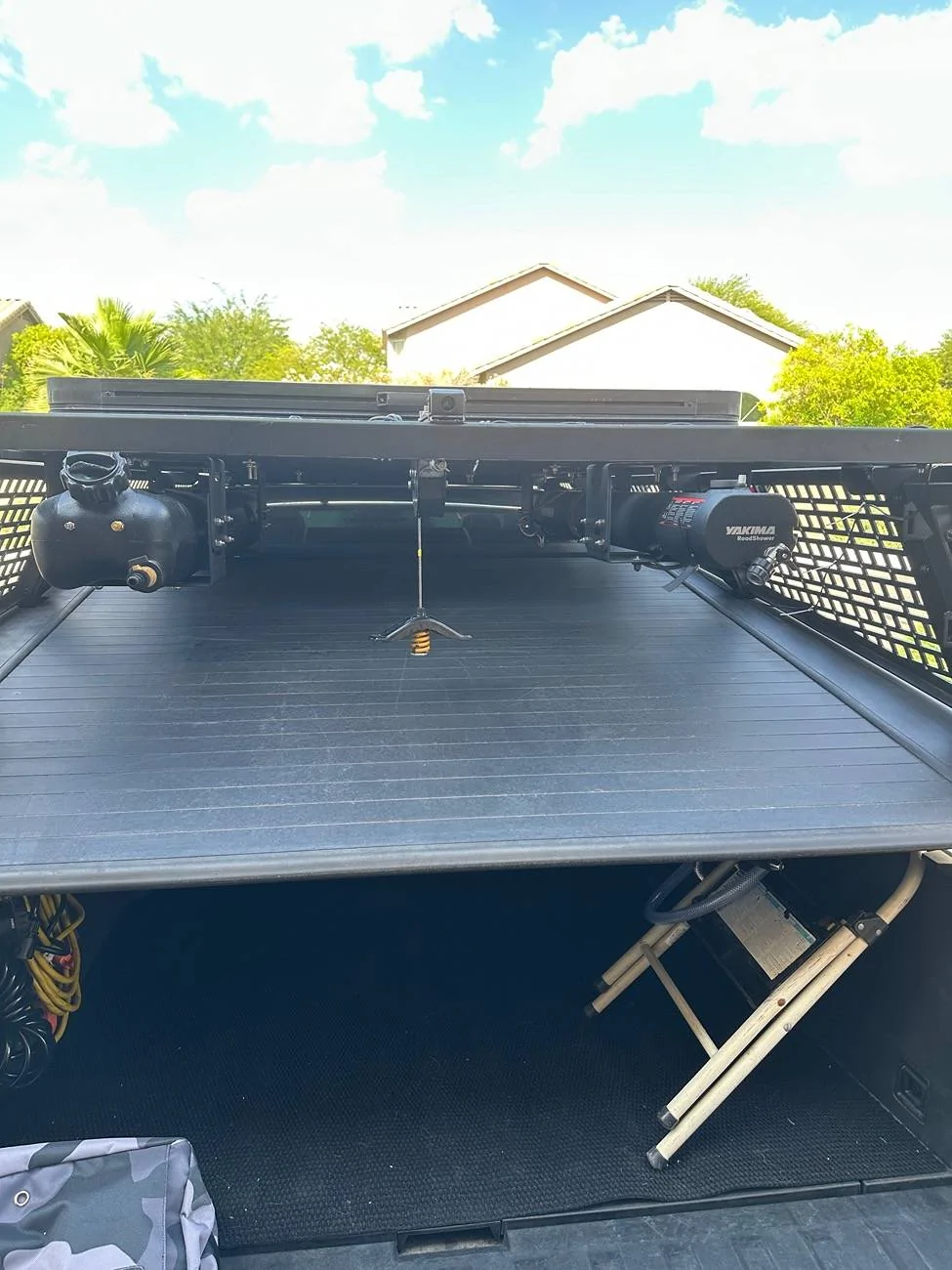

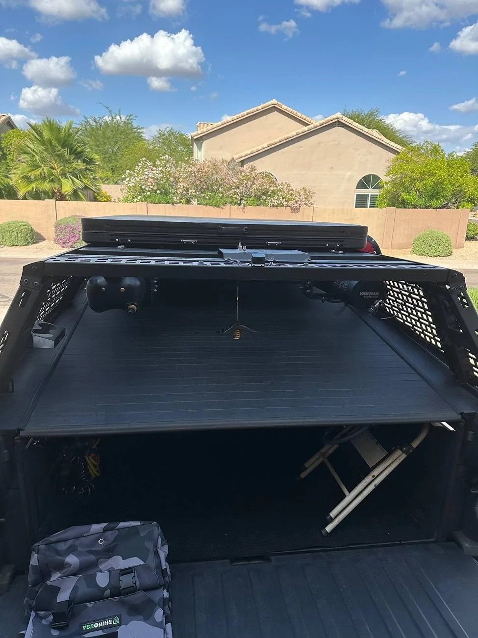

I’ve got the Mars Basecamp installed on my Urander roof rack. I love it! The Urander provides for so much utility. The Basecamp fits on 4 of the Urander crossbars and actually connects to 2 crossbars. The Basecamp is big enough for my wife and I to sleep comfortably in (I’m an even 6 foot).
I had trouble with the Urander wind deflector at first and had to keep trying slightly different installs to stop it from vibrating at highway speed. Basically I moved the rubber front lip as far OFF the wind deflector as I could while still keeping it attached, and I moved the wind deflector as far forward as possible to where the front rubber lip was in direct contact with my roof glass: no more vibration.
I did not like the self-inflating mattress that came with the Basecamp. I ended up buying an iKamper 7850 4-inch mattress and it is a tight fit, but works and I’m much more comfortable.
I dented the Basecamp and scratched the roof rack he-manning the Basecamp into position with a winch and some tie-down straps. I’d suggest getting 2 or 3 friends to help lift it, because where I dented the edge of the Basecamp it broke the water seal, so I had to RTV over that to make it water-tight again.
I think my range loss isn’t too bad with the Basecamp. I estimate 20-60 watts per mile, depending on speed and wind.
I added WaterPort’s “under” rack mounts with an 8-gallon WaterPort Weekender and a 4-gallon Yakima Roadshower. The Roadshower is aluminum and allows for a little easy engineering where I added a heating element and a thermostat that runs off the Cybertruck roof 48v accessory feed. If you search posts in this forum for “Water Heater” you can locate some detailed instructions and a parts/nomenclature list. It is pretty awesome that the Cybertruck with the Urander allows this functionality. My hot water heater design only uses about 200 watts an hour and heats the 4 gallons to 118 degrees within about 70-90 minutes.
l also added Cybergirl’s Lipert winch spare-tire system for hanging a spare tire off the bottom of the rear of the Urander, but I’ve got to move that a little bit as right now the spare tire is a little too close to my WaterPort Weekender and my Yakima Roadshower.
I’m going to add a 270 awning and a privacy shower-toilet stall. Would you recommend the Urander 270? I was looking at the TarucaUSA 270 as well.
Cheers, mate! Enjoy your awesome truck!
We’re going to Zion National Park in a few weeks. Gonna be great!

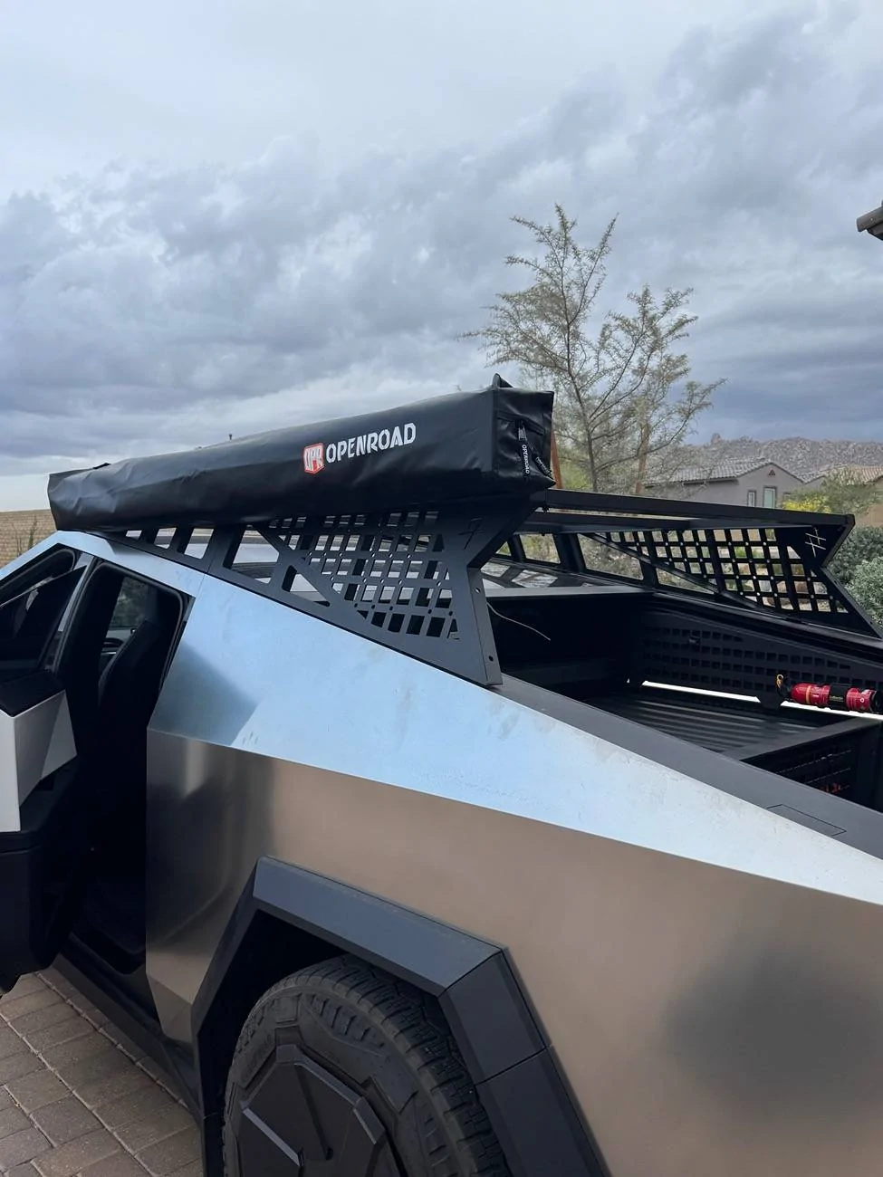

Impressive setup! I have the Basecamp ordered and looking forward to using it this summer. If you’re looking for a 270 degree awning, I just installed the OpenRoad 270 degree awning. I’m impressed with the features like the built in lighting and the ability to zipper on side walls. Only 1 issue where the cover is too tight around the hinge side so waiting to hear back from customer service.

Thank you for the recommendation!
