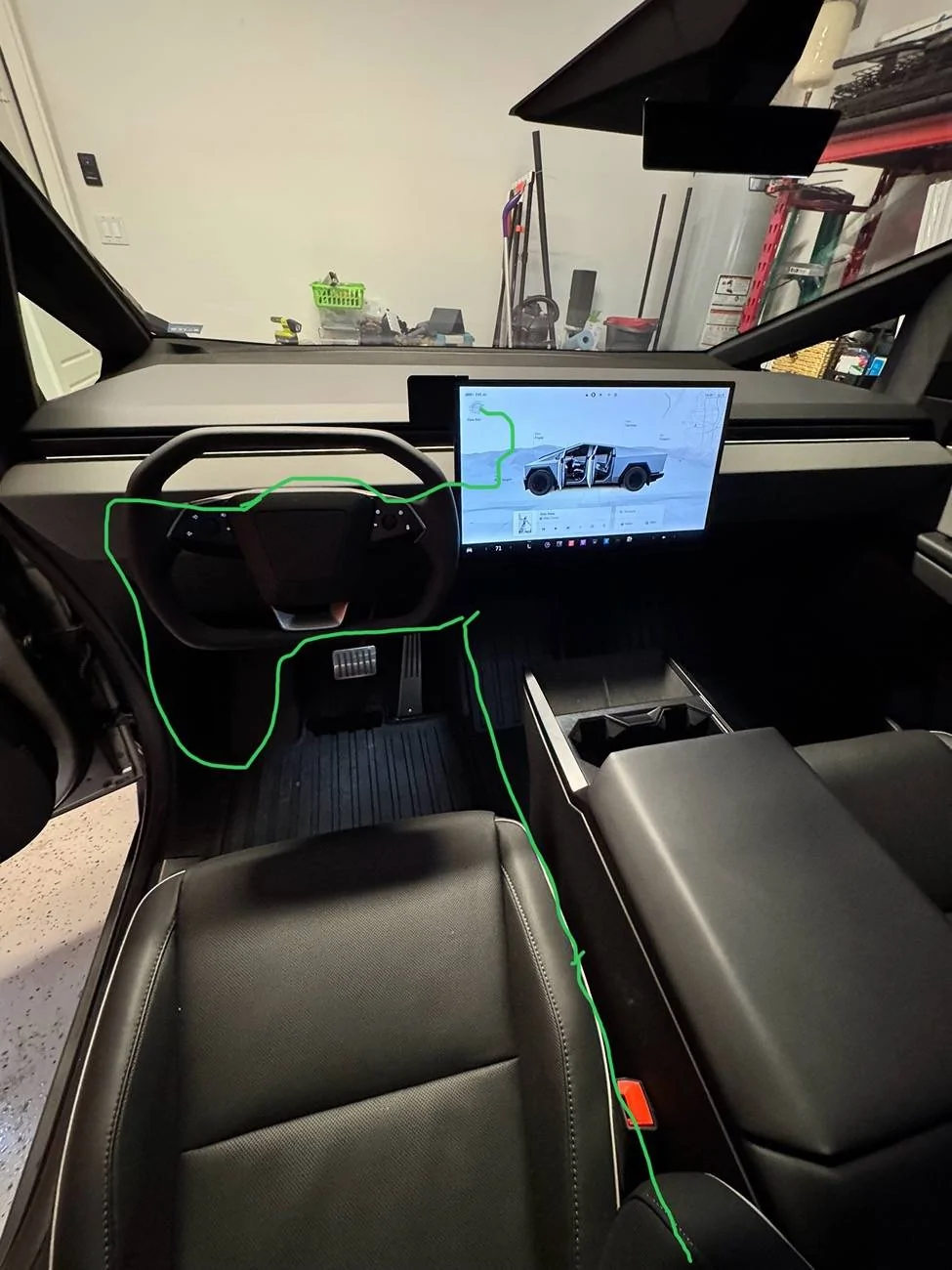

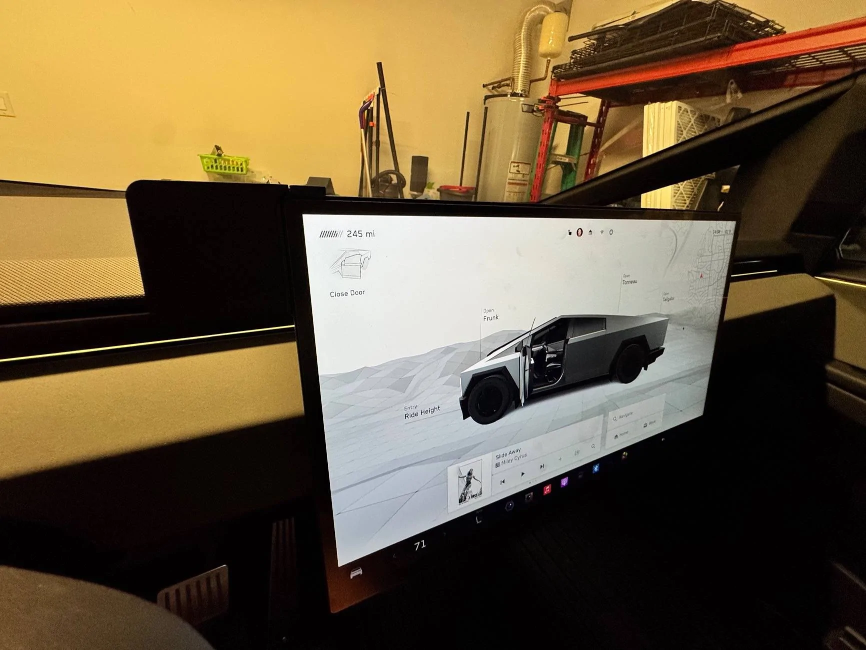

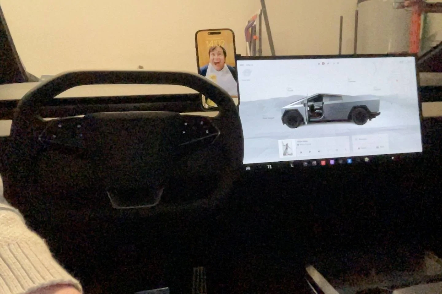

Unsponsored/solicited review on the MagBak Cybertruck Wireless Charger. I liked the design since it looked the "most OEM" of all the MagSafe chargers I've seen.
Installed yesterday, and I love how it looks. I hate, hate, hate wires... and other than the wire coming out of the side of the device (which is behind the screen) and the rear USB C plug in... I was able to route them all in the panels. Had to order a longer USB-C extension (4 feet). Was able to lift the front panel and route to the car's left side, run down the base and behind the floor panels. Lifted the center lip and placed under there.
Love the placement and the clean look. Would love to design a 3D Print file to hide the back wire... but that's just me being peculiar. Also need to pull open the center console panel and see if I can somehow route the USBC in there instead of the back, so it would be 99.9% wire free.

I tried and had a hard time running down the center… about gave up lol and then tried a new direction.
