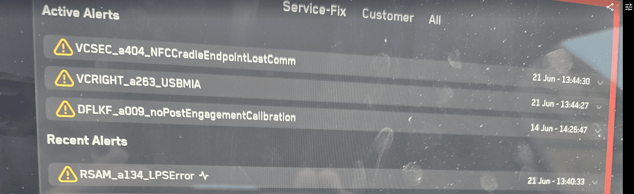

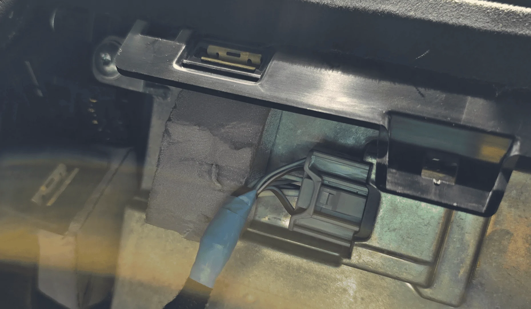

I went ahead and cracked my center console opened and unplugged the wireless charger. It was very easy and can be done in under 5 minutes if you have a plastic pry tool. Start at the top, just behind the charging pads.
There is an error that is only visible in the Service Mode. I am not sure what impact this will have. Also it disables the forward ambient light, as they are on the same control unit.

Wow, I admire your dedication. Wouldn't this no longer allow the usage of keycards?
That is right, you can see in the error codes that NFC is no longer working.
As a side note, I was hoping to do a MOD and put USB ports on the front of the center console, but as you can see in the pictures, the USB outlet is not very accessible and the wiring harness is way more complicated. There are about 50 wires going in for 1 USB-C port and an ambient light.
Even the orange cable going to the 12v outlet has 5 wires... why would you need 5 wires for DC? Maybe its wired in parallel with a 5th wire for a switch? Its actually the 120v outlet.

I made an edit I think after you quoted me, you're correct, its 120v.
It may be using the wires to handle power into the plug and then power to the back plug.
