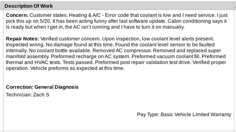

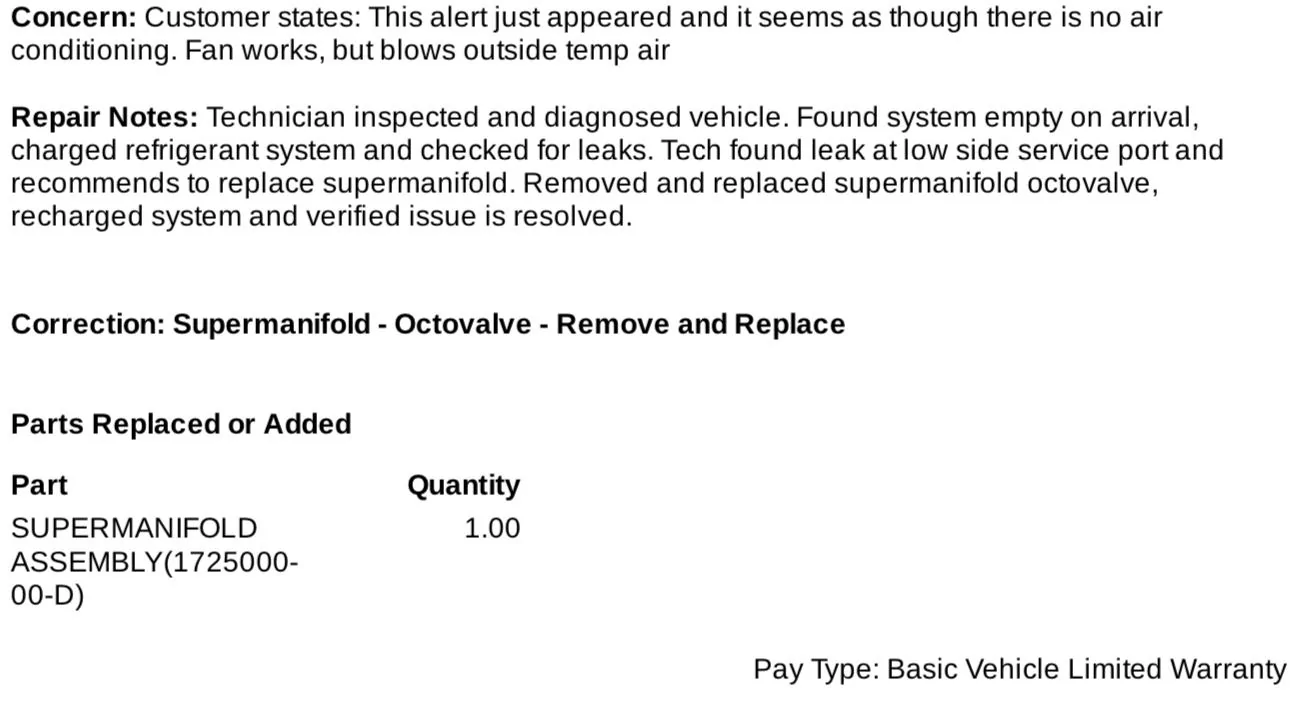

Yes, I experienced the same issue and error. My issue was a leak at the supermanifold. Luckily it occurred two days prior to an already scheduled appt for other issues and they had the part in stock (thank goodness)

Similar situation for me. First time Tesla owner and I sold my gas car after having my Cybertruck for 2 days because I knew I would never want to drive it again! I love this truck! At 1100 miles I got a Low Coolant error and am having a flatbed come haul it to my service center. I plan on driving it from Denver to Phoenix in a couple weeks, so I am glad the problem happened now but also hoping this will be the ONLY problem!

I got this same error last week they couldn’t find any leaks but coolant was low… they think it just didn’t get filled all the way off the production line. I hope this is the problem for all of us… but it might be that we all are experiencing the early stages of another recall sadly.

My leak was at the Coolant Bottle. I got Coolant Low, Powertrain / HVAC performance limited. They replaced the Coolant Bottle and I was good to go. It was in the shop for 4 days waiting for parts. I got it back on the 25th.
