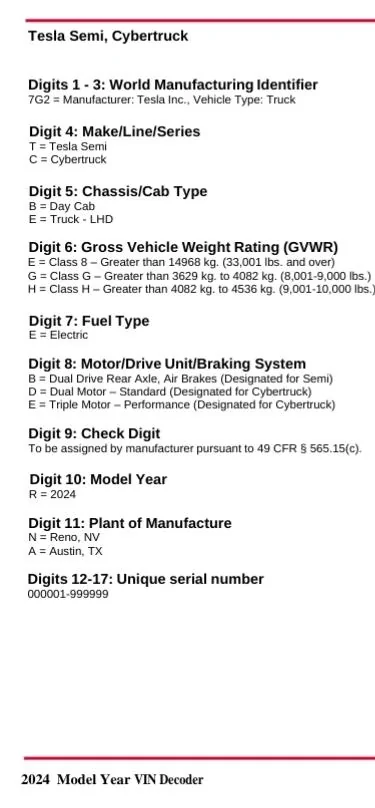

Also a 7G2 here for FS; could it be because they are manufactured in Austin instead of Fremont?
4,046
4,803
That's Tesla's World Manufacturing Identifier for trucks.
Manufacturing plant is the 11th digit, A=Austin
7G2 = Manufacturer: Tesla Inc., Vehicle Type: Truck
5YJ = Manufactured by Tesla Inc., Vehicle Type: Passenger Car (Designated for Model S & Model 3)
7SA = Manufactured by Tesla Inc., Vehicle Type: MPV (Designated for Model X & Model Y)
