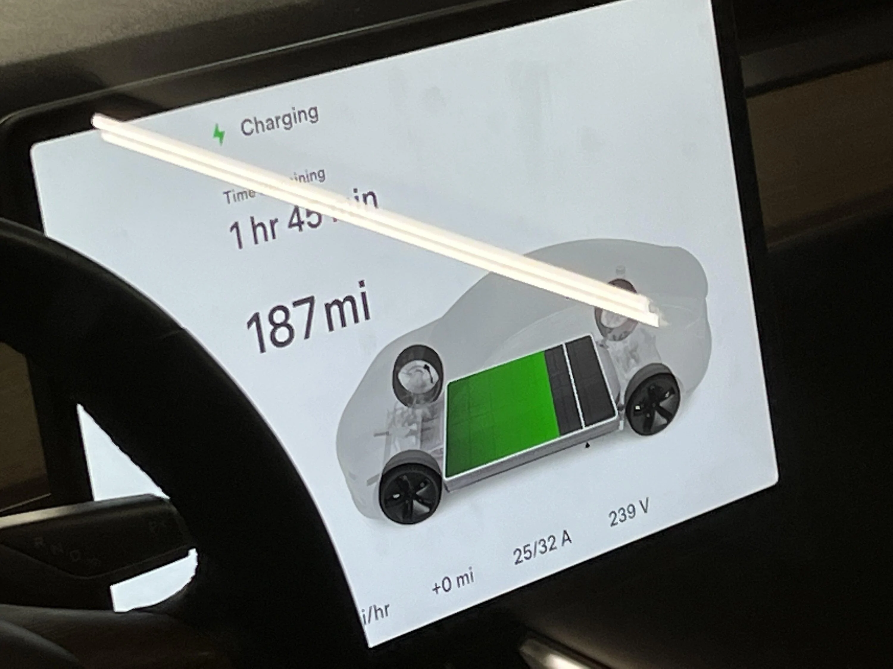

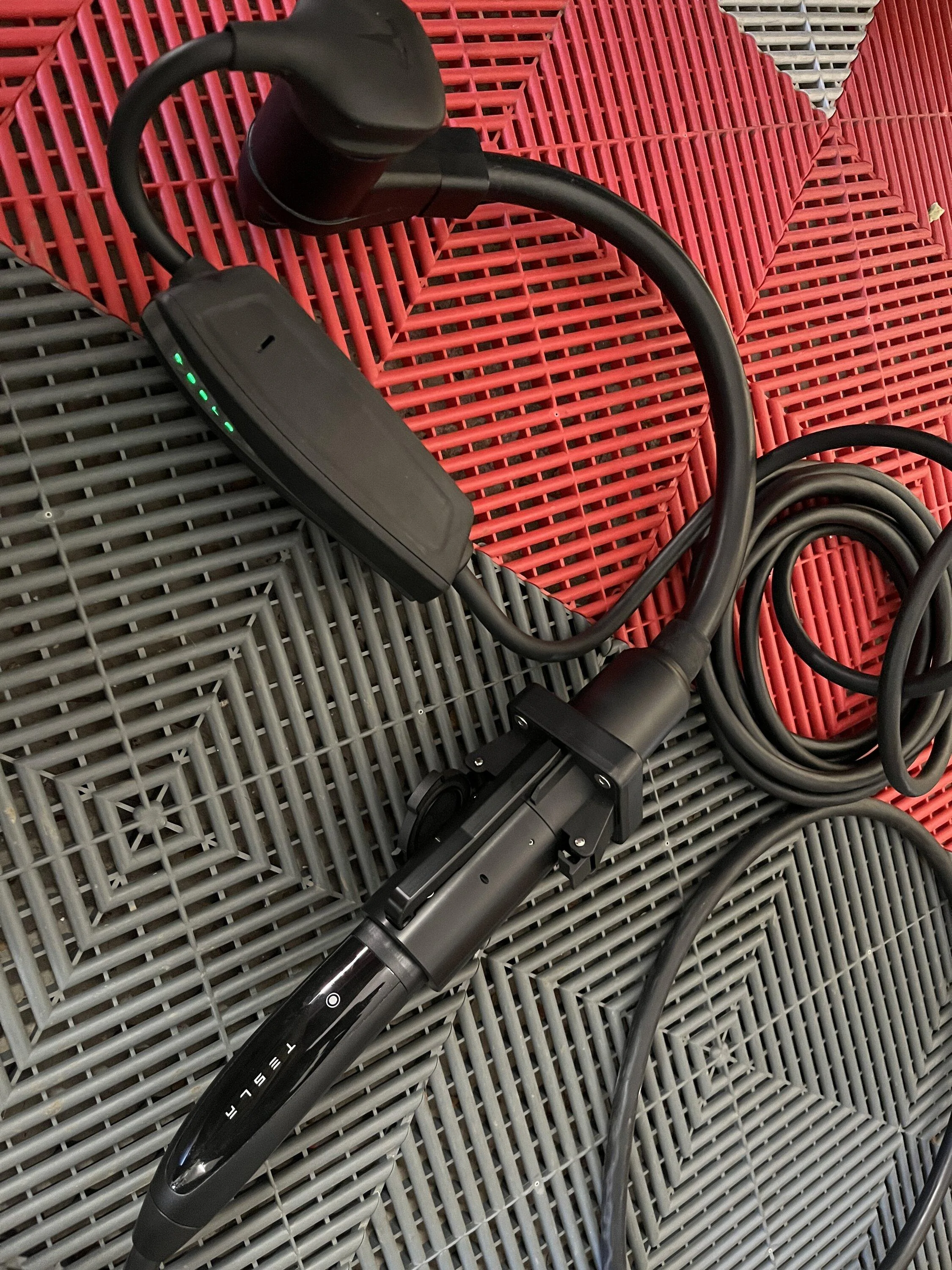

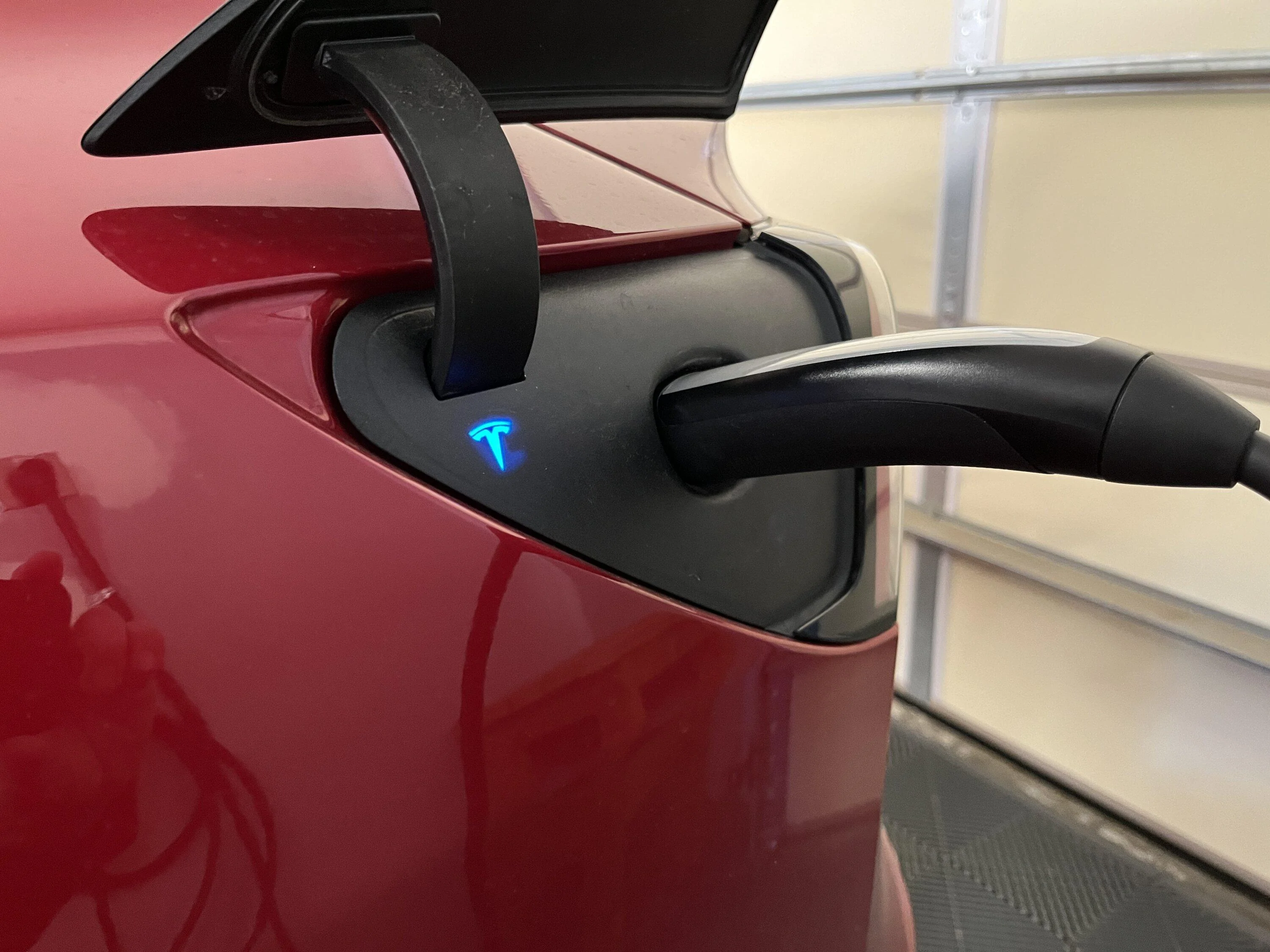

But then I realized that might not work, as I'd be pluigging a charger into a charger. Would the comms work? So I did a little test, and it did work. See picture below. That's my Clipper Creek J-1772 plugged into the Nema 14-50 converter, and then the Tesla charger plugged into that. The car charges no problem.
The question I have is..... HOW? How are both chargers getting through on comms to the car? I do note that as soon as I plug in the J-1772 to Nema 14-50, the Chargepoint charger shows active, even though the car isn't plugged in. Maybe it's the adapter doing that? And then only the mobile charger does the comms?

I suspect the J1772 to NEMA 14-50 has a built in resistor to mimic a car signaling "ready to charge" on the control pilot to ground circuit. That convinces the first EVSE to close it's contactors and energize as far as the 14-50 receptacle.
https://en.wikipedia.org/wiki/SAE_J1772
Therefore, be careful regarding water, shock, etc on that cord. As in, I would plug things in from the car toward the upstream EVSE, not the other way around.
Remember to tell your Tesla to downrate below the capability of the J1772, since it will assume the 50a plug can do 40a, and the j1772 equipment might be set much lower.
Otherwise you might trip the station and then you have no power...

Tesla adapters tell the car what adapter they're using so it can auto-set the charge rate, remember that you'll be bypassing this.
