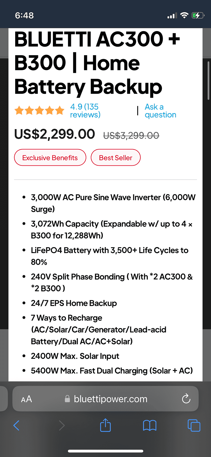

RoboTaxi

This with the max solar input of panels would work well. The hardest thing about the solar generators is finding ones that have a large solar input.
That's pretty good input for the price! Good find
