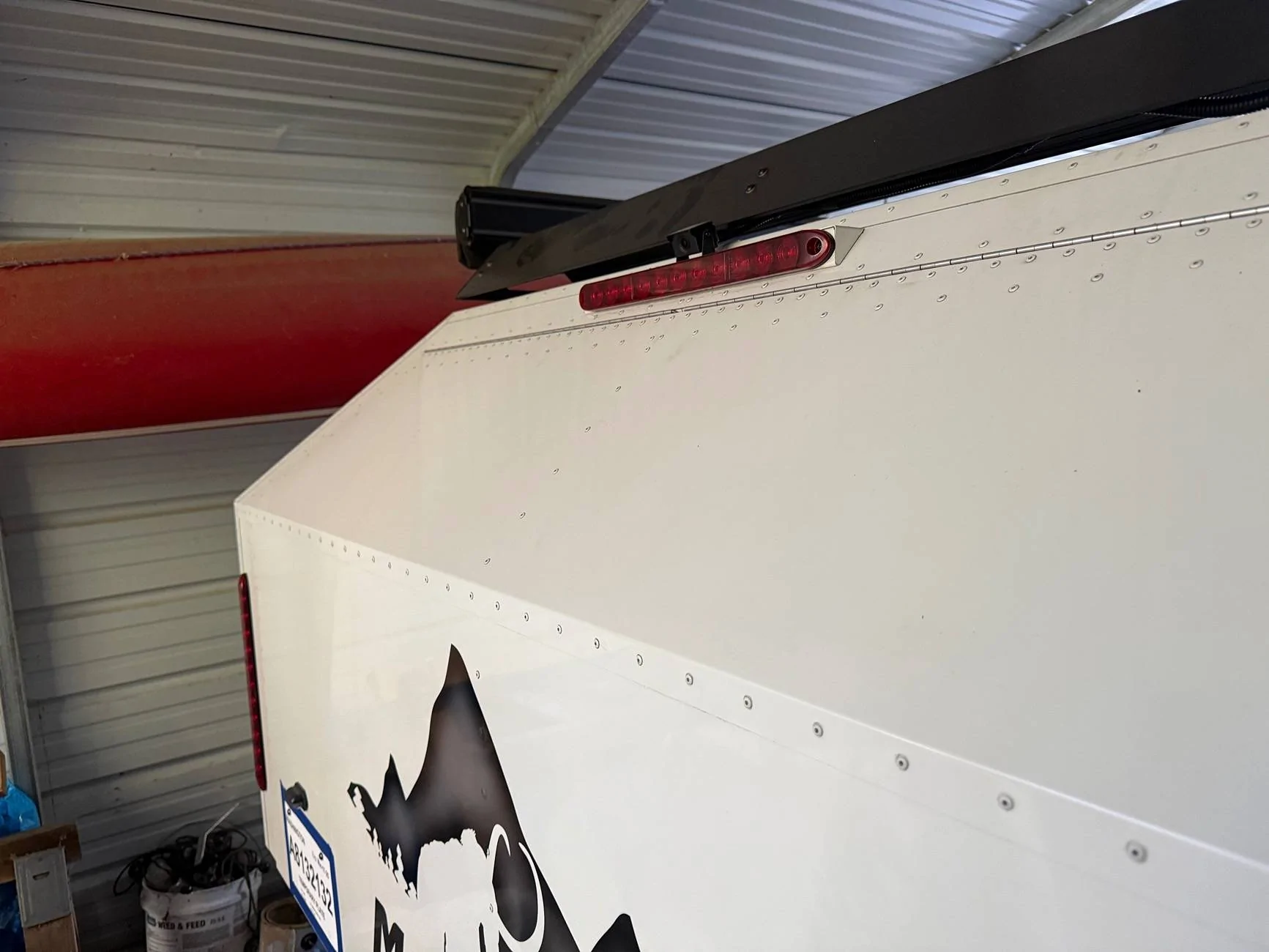

I need to be able to see behind my trailer when I’m backing up so I don’t run over anything. This is the view I now have from the rear camera on the trailer. That is with the screen scrolled down so I can see the edges of the trailer. I can scroll up on the screen/mirror to see the road behind me when towing.
Tesla Cybertruck Hansshow trailer and truck back up camera installation IMG_2994
I chose the Hansshow Cybertruck Media Rearview Mirror 8.2"Dual Channel Recorder. I installed the rear camera at the back of my trailer,

The rear camera cable was fished through the rear body and through to the hitch area. The excess cable is coiled up and stored behind the rear sail panel. The coiled cable you see here is in a temporary location that interferes with the tonneau seal, I eventually tucked it in lower down.
