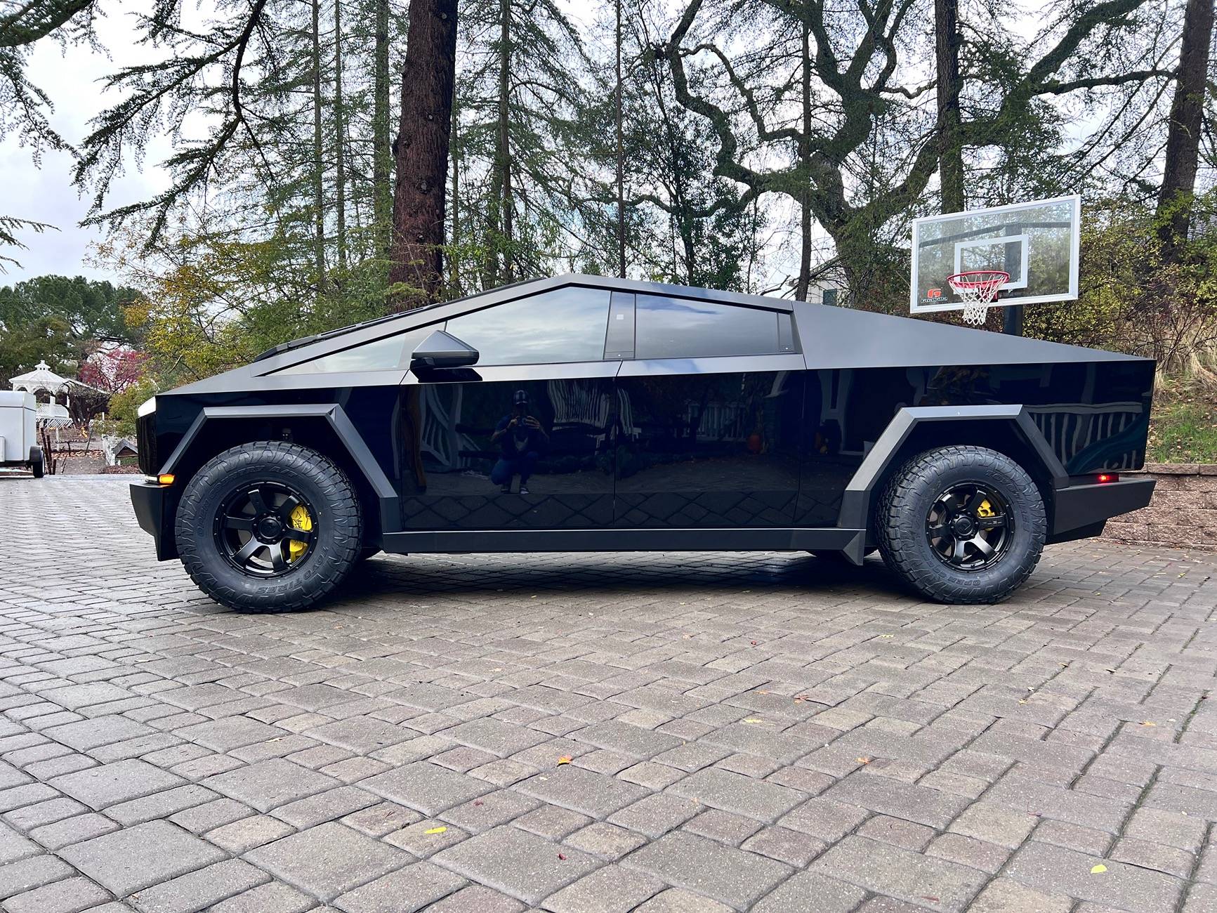

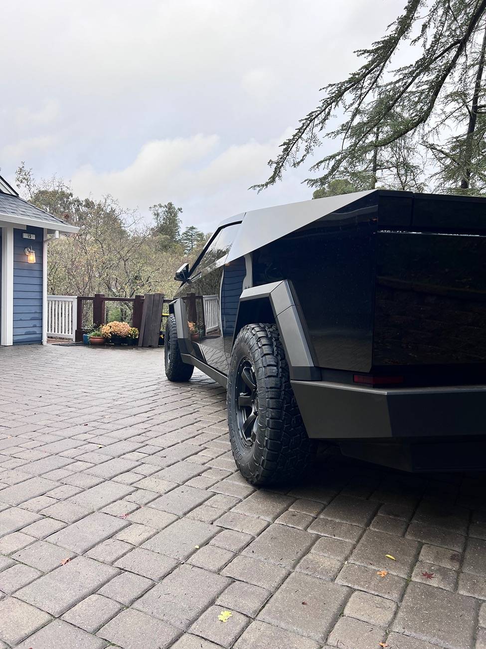

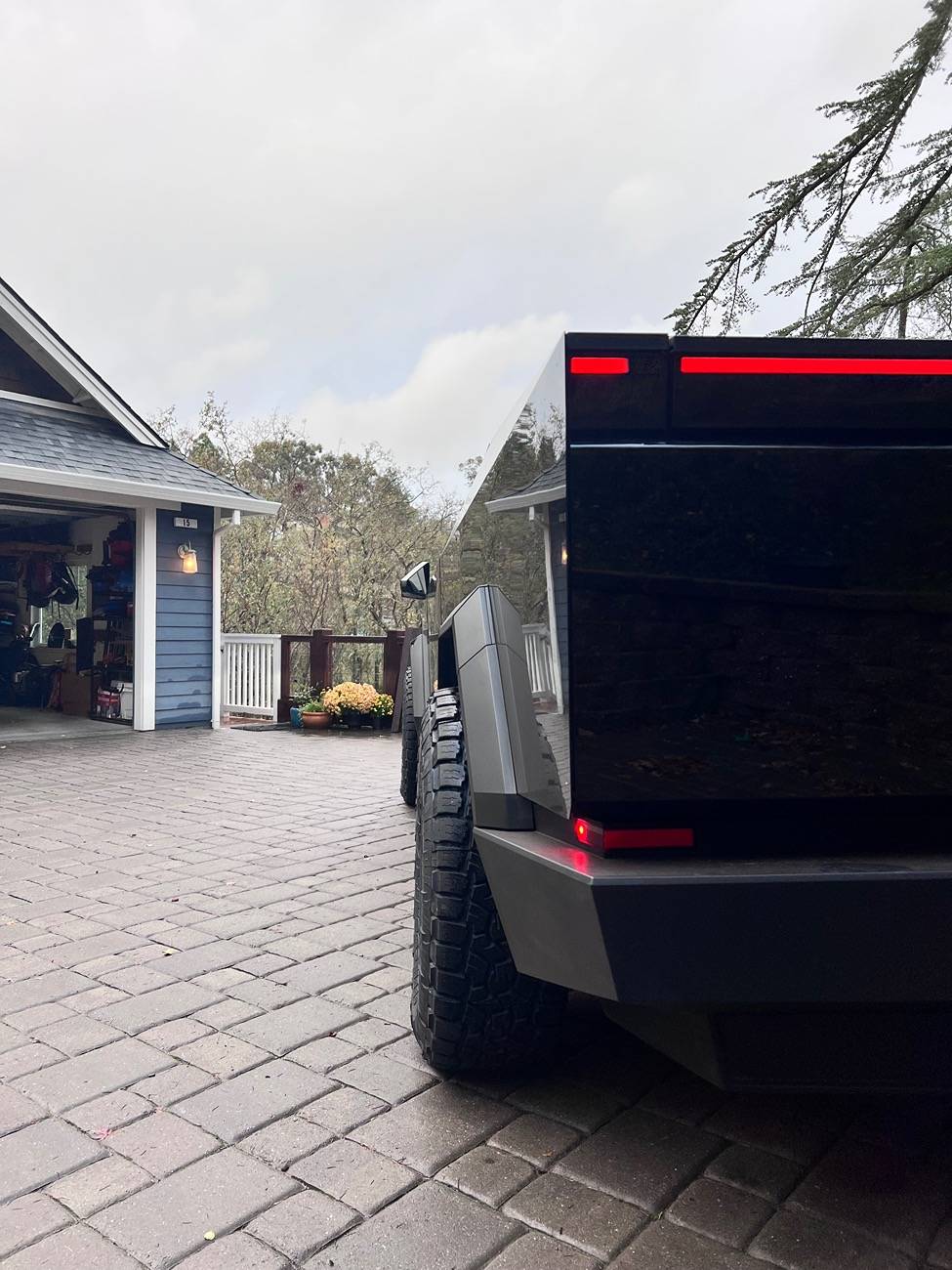

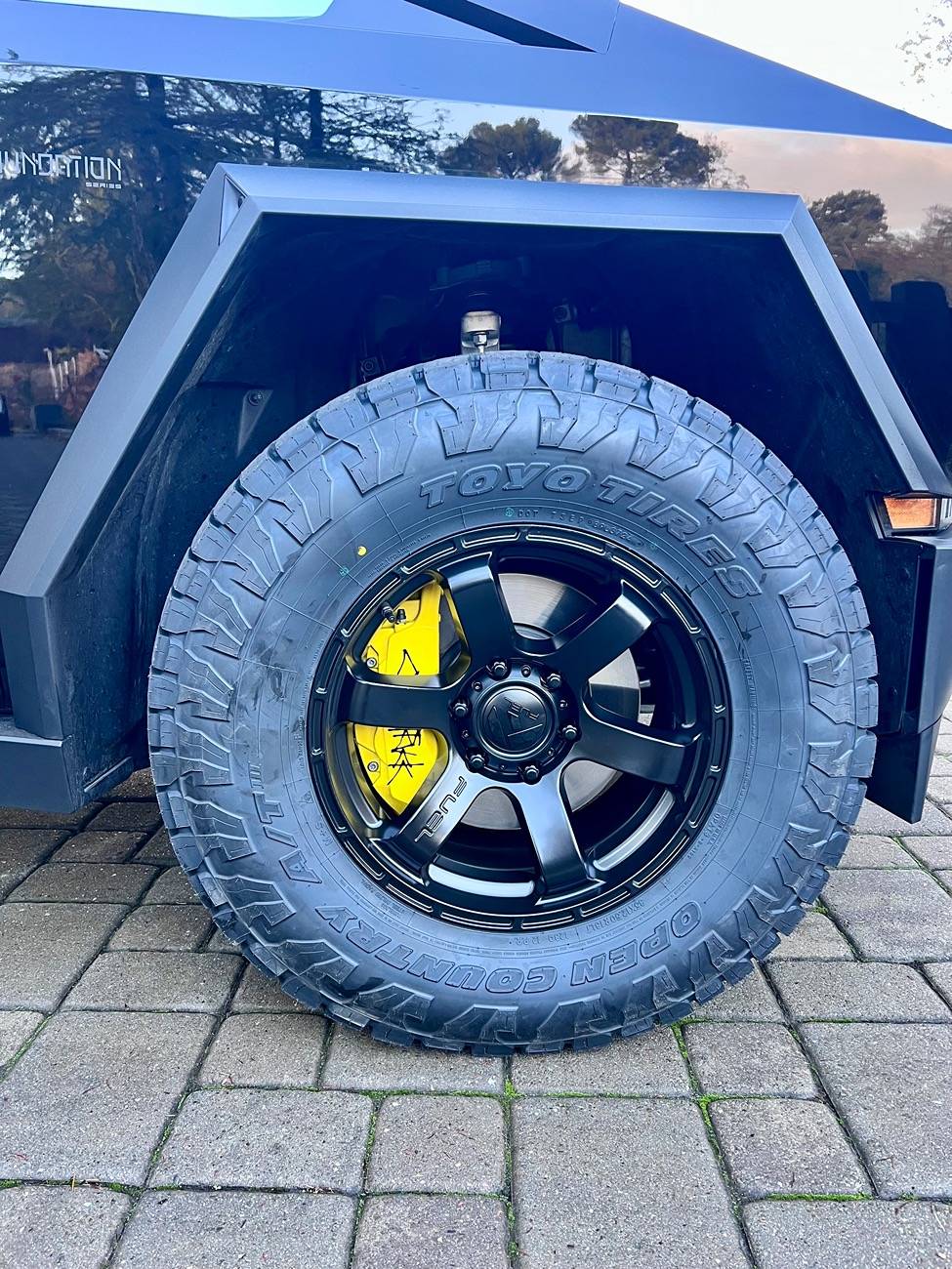

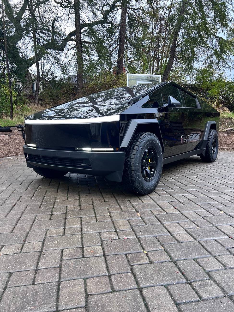

Wheels: Fuel Rush 18x9”, +20mm offset
Tires: Toyo Open Country AT3 35”X12.5”
Fitment: removed harmonic extension and other than a very light rubbing on the backside wheel well at full lock it needed no modification. Little heat gun and press was all that was needed.
Range: TBD

how does it drive compared to stock tires?

Nice tire choice ! I got them on every vehicle I own except the M3
Thanks! I was between these and the falken Wildpeak AT4W. The Falken’s were out of stock and I was convinced by the folks at 4 wheel parts these are better for what I do (highway, rain and snow, not much off road) anyhow. Happy with the choice! Great in the rain today…

They are Great and last. I had a set on my duramax then got the RT for my Bronco and literally today got some off offer up for my work truck that are called “CT” comercial grade. Havnt tried these yet and honestly never heard of them till looking them up last night but all the rest have been great and a great warranty , for my taste if you take the sidewall aggressive look and longevity in one tire they are one of the best

look pretty damn good! Range will suffer im sure but worth it if you're not doing long distance all the time!

Very nice I like the wheels and the poke!
