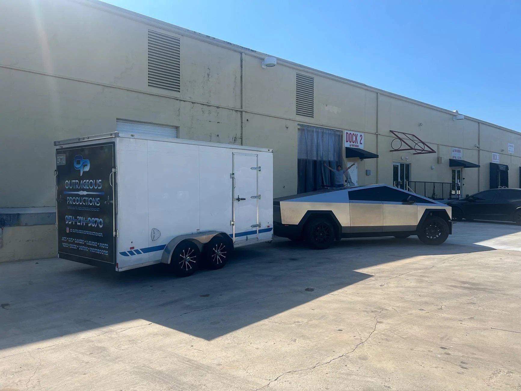

I drove my enclosed 14x7x7 trailer from Davie florida to Tallahassee Florida this past week. 500 miles should normally charge maybe 1-3 times without trailer. With a trailer full of furniture for my sons house, I had to stop about every 80 miles for a charge. The normal drive of 7 hours turned into a 13+ hour journey that was tiresome. I hit superchargers at Buc-cees, and Busy Bee, some were 250kw, some were 150kw. For some reason, my CT did not charge close to the specs, many time sub 100kw. I am not sure why? Maybe the batteries are running all day that they cant handle high watts? anyone have same issue. Last time I travel with trailer for long distances

80 miles between charges seems really bad. The worst I've seen is usually half, so around 150 miles. Do you know what your usage stats were? BTW, it's not the weight, it's the aerodynamics that seems to make the biggest difference. Is you trailer really tall? Or really square without curved edges? Maybe post a picture of your setup.

I drove 63-67 mph the entire trip. With the trailer on, the computer doesn’t factor in the extra weight. But on a full charge of 310. It’s about 2/3 loss. So every 80-100 miles I’d get to a full charge. Yeah .39 -.49 cents per watt on charging. $200 each way. !! Good thing I can nap and watch Netflix while charging
