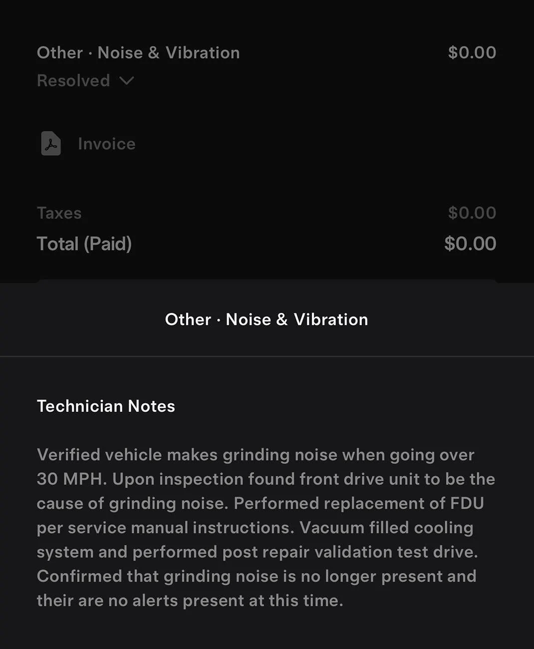

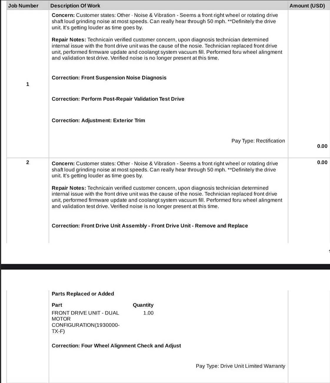

Wind noise could be front drive unit issue. My CT had wind noise coming from front dash area. I thought it was air intrusion from windshield seals. Not it.
bad bearing or component in the FDU (front drive unit)
Tesla replaced it and the noise is gone. Super quiet ride now. Check the screenshot from recent service visit. Maybe same issue
