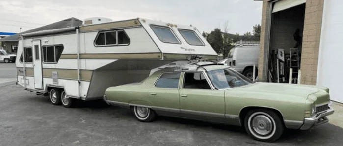

With the Cybertruck the goose-neck ball hitch might be on a frame above the vault/bed cover and mounted to the Cybertruck rack/sail-pillar mount points instead of being mounted to the Cybertruck' roof.
The stress on roof disadvantage of the 1970s Harmon Shadow goose-neck hitch with aerodynamic trailer might not apply to the Cybertruck yet still gain the benefits of reduced sway and increased range from a better aerodynamic silhouette.
1970s Harmon Shadow | RV Flashback
Most bizarre trailer I've ever seen. From Let's Make A Deal circa mid 1970's.
1970s Harmon Shadow 5th Wheel with 360 degree swivel hitch
May 12, 2009
Harmon Shadow roof mount hitch - Think you need a truck to tow a fifth-wheel trailer?
06/14/2013
By Kurt Ernst of Hemmings Motor News
https://www.hemmings.com/stories/2013/06/14/think-you-need-a-truck-to-tow-a-fifth-wheel-trailer
Fifth-wheel travel trailers can offer up many advantages compared to their more conventionally towed counterparts, but chief among them is resistance to the phenomena known as "sway." As we explained in our Skills 101 article on towing a trailer, sway can be caused by excessive speed, improper trailer loading or even the currents of air created by passing tractor-trailers; fifth-wheel trailers are resistant to sway since the hitch is (generally) located over the rear wheels and not far behind them.
In the early 1970s, Harmon Industries introduced a travel trailer it called the Shadow. Meant to deliver the advantages of a fifth wheel trailer without the potential drawback of having to buy a pickup truck as a tow vehicle, the Harmon Shadow required buyers to mount a purpose-built receiver and ball assembly atop the roof of their car. This mated with the corresponding high-mounted trailer hitch, giving buyers an incredible amount of stability and maneuverability.
Using a Volkswagen Beetle as a tow vehicle (not something we'd recommend), Shadow owners could pirouette a full 360 degrees, making backing the trailer into a tight parking space a snap (assuming a spotter was used to correct for the driver's total lack of visibility).
At the height of their (brief) popularity, Shadow trailers came in sizes ranging from 18 to 27 feet in length, offering camping solutions for families and budgets of all sizes.
Meet the 1971 Harmon Shadow Gooseneck Trailer, ā€œThe Most Beautiful Trailer in the Worldā€
19 Jul 2022
By: Elena Gorgan
Photos: From Colton Graham on Facebook
https://www.autoevolution.com/news/...st-beautiful-trailer-in-the-world-193881.html
The Shadow trailer was ā€œby far the most sensible, safest, and most comfortable way to travel!ā€ according to brochures at the time. Its highest selling point, though, was the fact that it didn’t attach to the towing vehicle in the traditional way but through the roof hitch. Like the El Chico designed for the Volkswagen Beetle that would come three years later, the Shadow boasted the ability to allow the towing vehicle a 360-degree turning ratio. Somewhat like El Chico, with which it’s often and mistakenly identified with, the Shadow burst onto the scene as a truly revolutionary RV – and then just as quickly disappeared.
As fancy as these options were, they had nothing on the roof-mounted tow hitch. Harmon Industries claimed it did away with the risk of jackknifing, thus increasing safety, and improved car performance and gas mileage, because the trailer sat closer to the towing car than a regular one. The Shadow had electric over-hydraulic brakes and an aerodynamic silhouette that ā€œsubstantially reducedā€ drag, so it was easy to operate whether on the highway or in tight camping spots.
The Shadow was, in short, RV perfection – at least on paper. The reality was that, on the road, it placed too much stress on the roof of the towing vehicle, causing irreparable damage. Early buyers found out that the patented steel plate wasn’t removable as advertised. Or that the rear wheels of the towing vehicle would lift off the ground in case of sudden braking. Or that the entire roof would be torn off in the same scenario. Or that the trailer would tip on turns or in high winds because of the high gravity center. Life-threatening stuff, you know.
