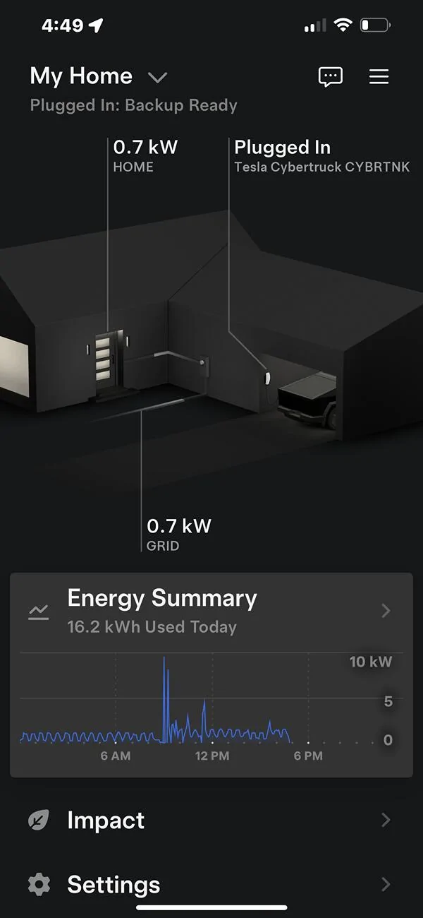

I have the same problem where it says home not connected under the Cybertruck controls menu. However it says Plugged In: Backup Ready.

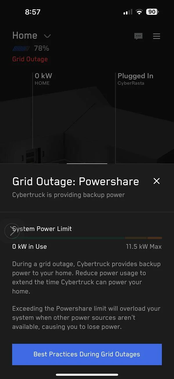

I am having all kinds of challenges with my PowerShare. It only covers part of the home, and if there is a small energy blip, it kicks off, but does not turn back on and I have to reset at the PowerShare box. This is happening very frequently now and worse of all, it is connected to my AC and fridge. I am at the point where I just want PowerShare gone and my old box put back. It’s horrible!!!

Pictures from 3:31, then 8:57 tonight and 9:25 and it is raining and this time it will not come back on.

It has never worked properly. By reset I mean hitting the reset button. Also turned off the main connect switch let it sit for a few minutes then turned it back on. Spent an hour on the phone with Tesla customer service and at the end they advised me to call an electrician.

What does you app look like? Here's mine for reference while charging. If different, photos of your installation might help.

My screen looks just like yours. I had an electrician come out and look at it, they said the wire that was used from the panel to the charger was a 6 gauge instead of a 4 gauge, and that the PowerShare unit appeared to have a fault inside. At this point I am done. Told they to come and take it.
