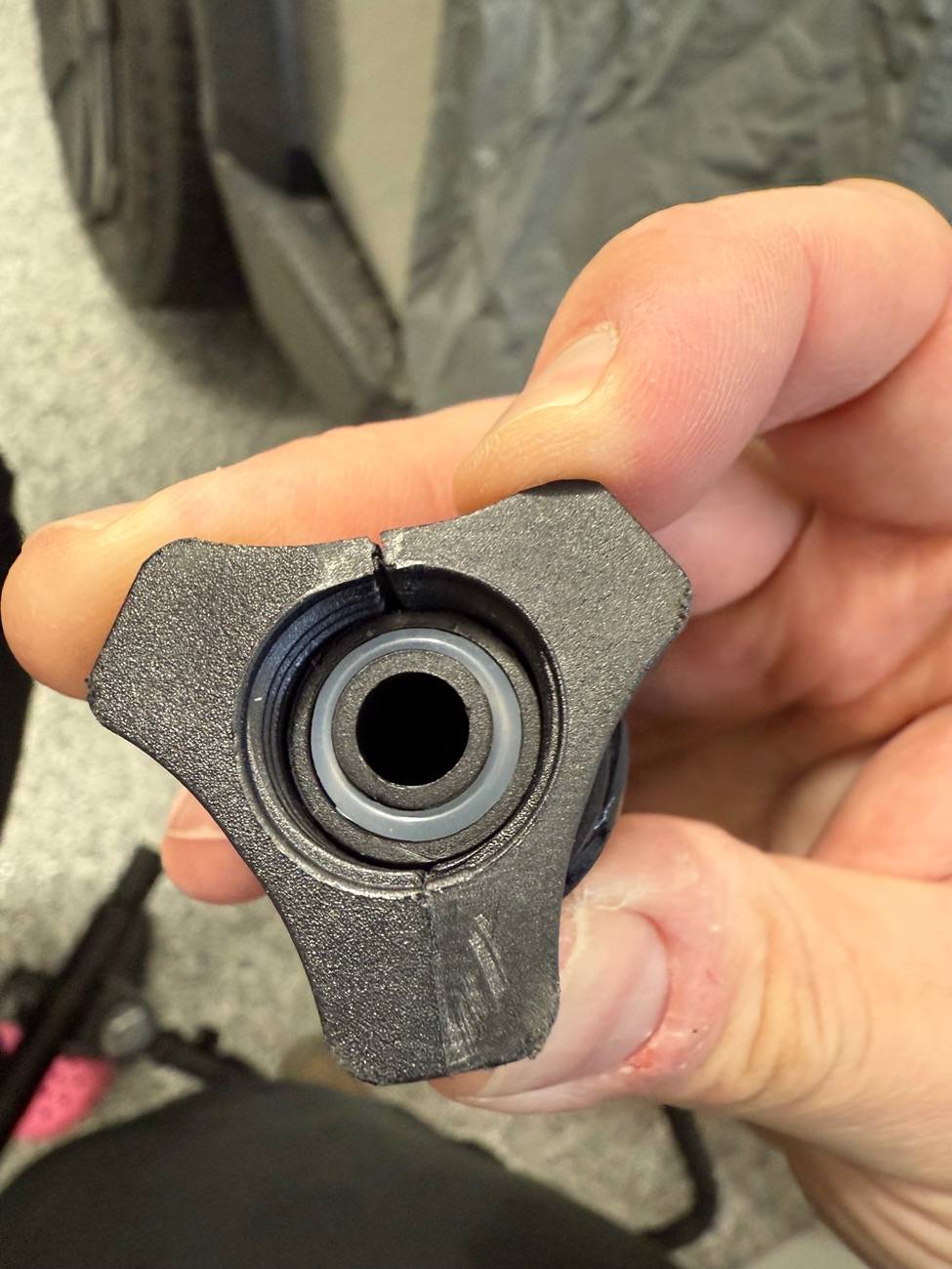

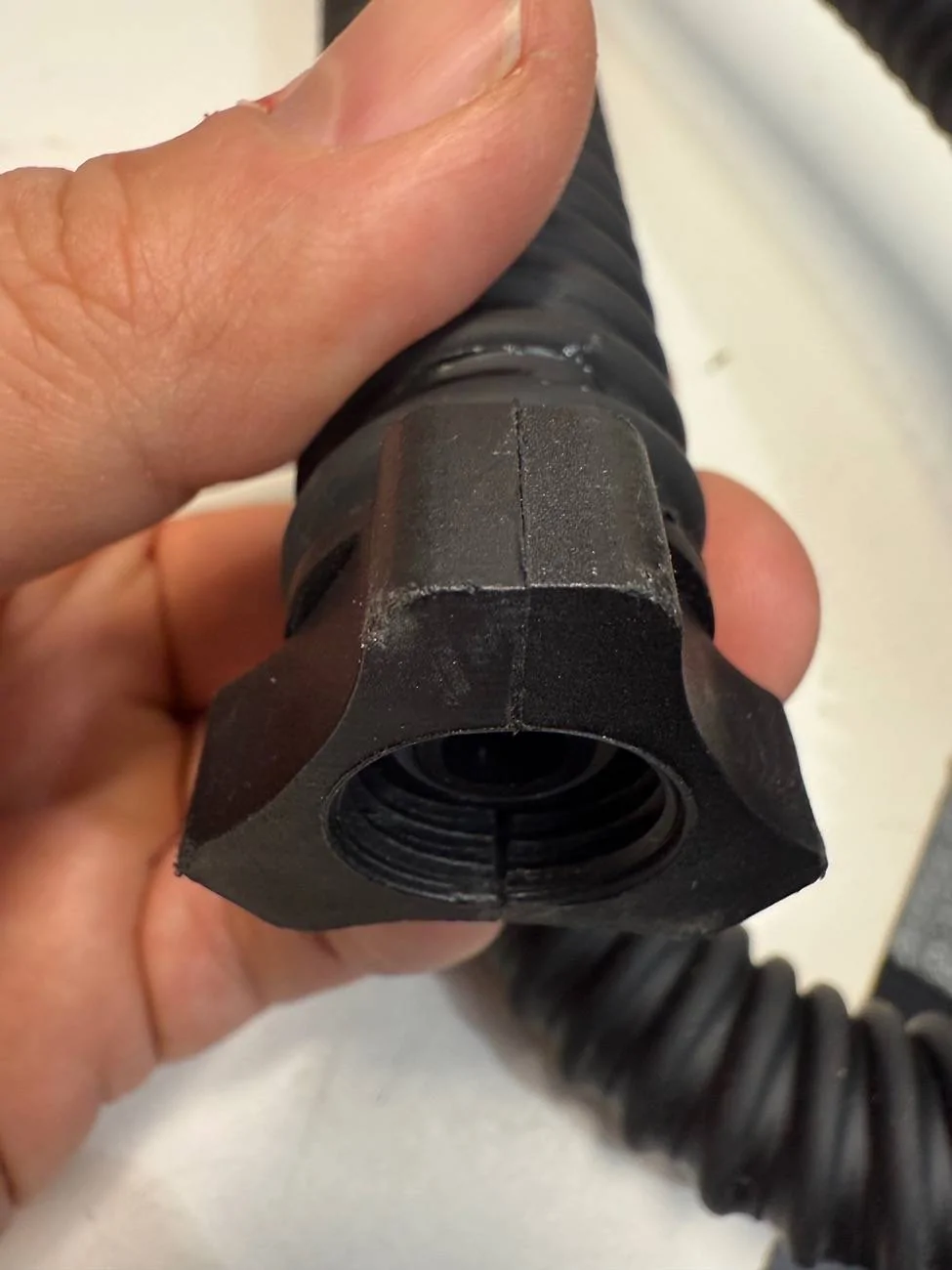

Hello, I recently added the Cybertent to my truck. When attempting to inflate the tent for the first time I head air leaking out with every pump. Upon inspection I discovered that the female threaded part on the end of the air hose that attaches to the tent fitting was split. I can't imagine that this is how the pump is supposed to function but the threads are so separated, I can't imaging that this part broke. Additionally, based off of Youtube videos, it seems that the newer tents may have a different setup here as the older ones seem to have a removable adapter.
Could you share what your hose end looks like?
Thanks,
Brian

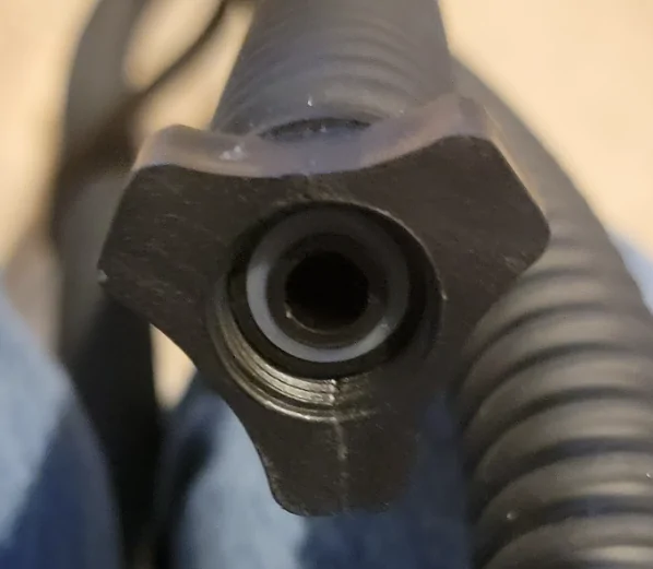

Mine looks the same except maybe not ass severe. Just looks like a seam where the die met on mine. Yours looks worse but as long as you were able to make it finger tight without the threads slipping it should not have been the source of the leak. The O-ring around the port does all the work there.

@TickTock thanks for the photo, I believe mine is defective as it is not connected at all. This confirms my suspicion. Thank you!

And yes, the other valves are closed. The air is clearly blowing out where the triangular piece with the female threads is split and not sealing. Some air goes into the tent but the rest blows out. The gauge on the hand pump is not holding pressure so it takes lots of pumping and it's not clear what pressure the tent is inflated to.

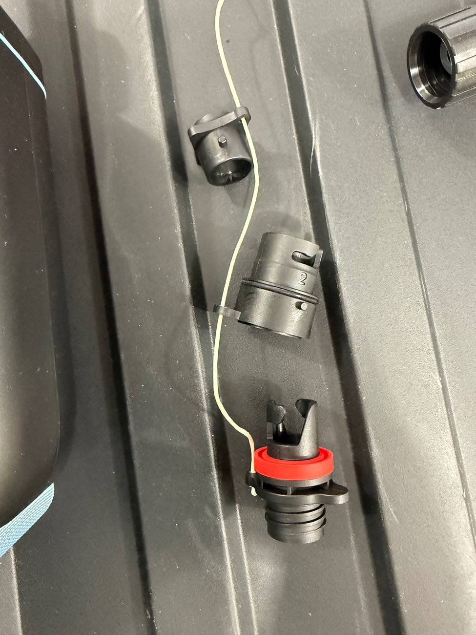

The newer (2025) tents have a pump with an air hose that has the fitting on the hose. The older tents (2024) had an air hose with a hose and a separate adapter. The tent uses 'Boston Valves' and that is what you need the adapter for. I've attached a photo of my setup. You can get the adapter you need in this kit. I bought the Topump paddle board pump and it works wonderfully with the tent. I use it with my Exped air mattress too. The only way I was able to find adapters for that was buying the Exped Mega Pump so pricey but I have a backup electric pump now.
https://www.amazon.com/Vkinman-Infl...boston+valve+adapter,sporting,188&sr=1-6&th=1
Tesla Roadster 2nd gen Cybertent Air Pump Fitting - 2025 Version IMG_8444
