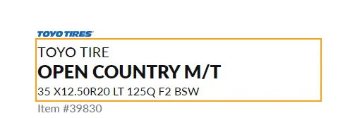

I’ve asked multiple reps at the dealership questions about the Cybertruck and they are so clueless it’s actually kind of hilarious. Anyone else see that? They can’t answer any questions about anything aftermarket whatsoever. But I’m curious if any tire people out there know if it’s possible to use any tire on the cybertruck? I have Toyo Open Country M/T’s on my Jeep right now, and I think it’s my favorite aggressive tire. I want to put some on my new Cybertruck whenever it comes (not worried about range, I drive minimal distance for work) Is this tire possible in a 35 on the cybertruck? I saw a YouTube video where they did Nitto Grapplers and he mentioned tire choices are limited. No clue why. What about a mini lift or spacers? I want to treat my CT like a truck, but can’t find any info on what you can do to this thing. Any guidance would be appreciated!

The main issue is the weight. I can go get nice and cushy C load range 35s for my wrangler, but I can't get a nice and soft tire for the truck. So even if you do find the one or two options that come in a crazy load range and are the right size to fit the truck, the road noise and comfort will be pretty terrible.
As for the tire you're asking about, it only comes in a Q speed rating, so the car can go faster than the safe speed limit of the tire (99mph). It does look like it comes in a high enough load rating though. You'd also need extra offset outward to avoid rubbing I believe, since they are wider than the OEM tires.
Tesla Roadster 2nd gen Changing tires on Cybertruck. Anyone know?? 1713898965833-wk
The included picture is the exact spec that seems to work the closest, but it's still not a 1:1 replacement.

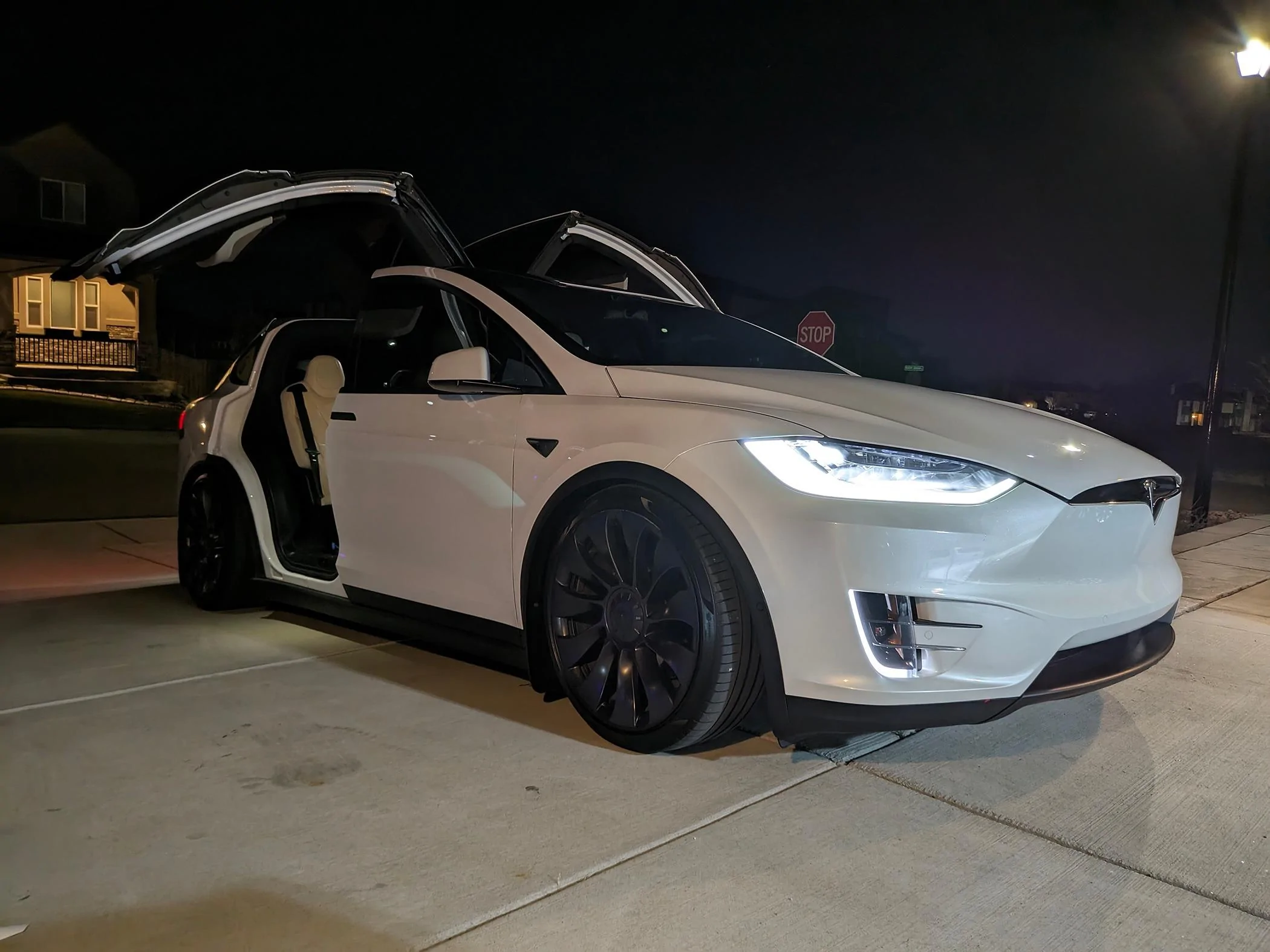

I just put my model Y rims on my model X and I've seen one whole other person do that on the interwebs

I was at the Parachute, CO Supercharger 4/21 and saw another Model X with the Model Y 21 inch performance rims. I was leaving so didn't ask him about his motivation. Looks cool.
