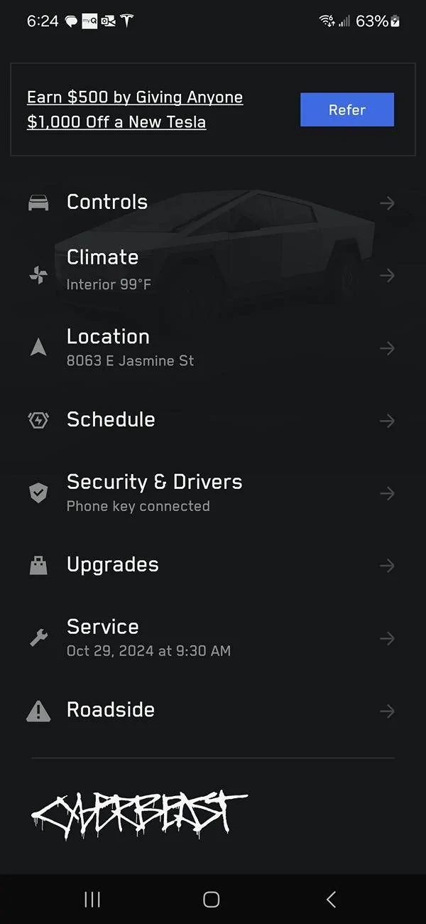

I think you’re referring to charge “stats”. You need to turn on road segment data sharing in settings.
  1. Check your Data Sharing settings from the vehicle touchscreen under the ‘Software’ tab and opt into the road segment sharing option.
    Note: It can take up to 24 hours for the change to reflect in the app.

RE: Update
No "Charge Status" selection in the Tesla app.
Just rebooted the FCB and "Charge Status" is still missing in the Tesla app.
