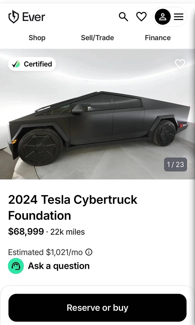

Don’t know what you paid, but prices are dropping and great deals are starting to be out there.
This Foundation dropped $1000 overnight and it’s already wrapped.
Getting closer
