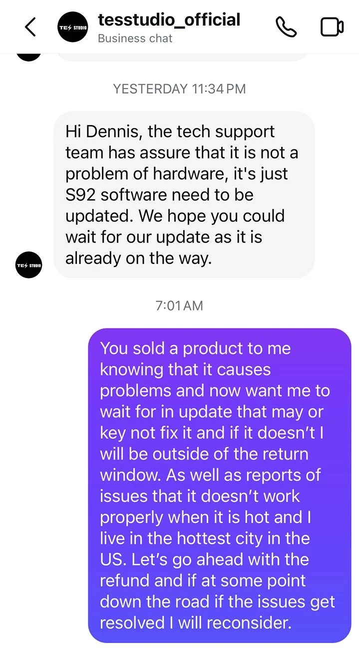

Same issue with this latest version. The harness still kills the connection to the right side tweeter.
There's a handy testing tool in the service menu BTW.
Working on a solution...
Speaking of wiring harness issues it seems that the mirror harness also prevents downstream items like the 10.88 screen and the Hansshow LED strip from functioning. I have reported to Hansshow and I hope they make a corrected harness.
