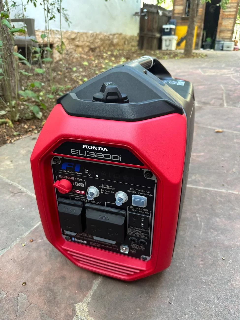

Have about 10,000 miles on my Cybertruck. Things have been fantastic.. Gone to Colorado, to Vegas, to Kanas City, to Chicago, to New Jersey and back. Never for one moment have I had any charging issues. Super Charging infrastructure is amazing. That said, I am going somewhere that is very remote and will be using the truck from some time with limited charging access. As an emergency backup plan we have purchased a generator. In addition to camping, we will be using this generator as a charging station in the unlikely event we need to. It's a honda EU3200i. It has 2 20 amp 120v outlets and 1 30 amp 120v twist plug. Done some initial testing with what I have, the 20 amp outlet only chargers at 12 amps, with my version 2, mobile connector. I want to use the 30 amp 120v instead. Not sure what exact adapter will work or what the mobile connector / Cybertruck will allow to flow. Anyone here have any suggestions, experience, adapters, websites or whatever might help me accomplish our goal?? Thanks so much.
Tesla Roadster 2nd gen ADVICE - on a generator charge tempImageqXeL7I
Tesla Roadster 2nd gen ADVICE - on a generator charge tempImageGLsIWg
Pops
Dec 31, 2023
965
1,284
Houston, TX
MY, CyberBeast
The generator you have is only rated for 21.7amps on the twist outlet. I believe that is a NEMA L5-20. Each of the other outlets are typically only able to do 15amps max individually(20 combined), and that is part of the reason you are only getting 12amps.
1) You would need a NEMA 5-20 to NEMA L5-20 to get the max amps out of your generator.
Here is one on Amazon $15: HERE
2) You will also need the Tesla NEMA 5-20 adaptor for the Mobile Charger. That will be more expensive. This adaptor alone might take you to 15amps, making the first adaptor optional.
Here is one on Amazon $62: HERE
Edit: Its cheaper from Tesla
NOTE: Save your money. Even with all these adaptors I suspect you will only get 16amps instead of your current 12amp. The limitation is the Tesla mobile charger @ 120v.

Valid point. OP with your generator you could charge around 30% faster than you are now for around $60-$80 in adaptors.

I really appreciate the effort here. I also happen to have a Version 1 mobile connector, I think that will do a high amperage. ANOTHER Question ----- I have one of these ground bonding plugs, that is needed to basically trick the GFIC. It goes in one of the 20 amp outlets. For some reason the Version 1 mobile connector wouldn't work. When I swapped it with the Version 2, it did. Any thoughts? Furthermore, I'm told the Ground Bond will still "trick" the 30 amp (aka the 21.7 outlet) plugged into the 20 amp outlet? You agree?

Another thought.. BTW cost is of no issue. I need faster charging rate. Forgive my ignorance her, but if I bought a NEMA L5-20 to and 30 TT or NEMA 14-50, with the mobile connector adapters I have, would that somehow get me to a higher amperage than 16 amps?
Spacenoddle
Nan
Jan 21, 2024
478
410
kenmore
Not really, the max you can get from this configuration is 16A. The UMC adapter has been programmed to limit to max 16A.
I would choose other inverter generator with 14-50 outlet to max out the charging rate. It might not give you full 48A due to the generator size and UMC MAX at 32A, but you can manually dial down to the max output of your generator.

Getting a larger generator is not an option. I guess we'll go with the Nema 5-20 in the regular 20 amp outlet. Is the Version 1 UMC max at 16A too?

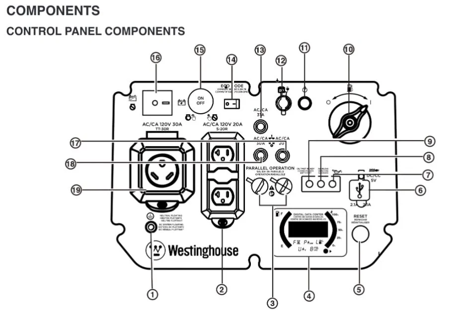

I tested my iGen4500 generator charging my Model Y Std Range. I limited the amperage to 24A and the generator displayed 75% load. The car’s UI indicated that the charge time from 59% to 80% (15.75 kWh) would take 5 hr and 40 minutes. That's 2777W to the battery vs 2880W to the charger for an efficiency of approximately 96% which matches your efficiency claim. The generator consumed 1 lb of propane in 24 minutes. So, 1 lb of propane added 1.1 kWh of energy to the battery (24 ÷ 60 x 2.777 = 1.1 kWh).
1 Gallon of propane = 4.8 kWh
The full 20 lb bottle of propane will add 22 kWh of charge to the battery in 8 hours. At 500 Wh/off-road mile, that's 44 miles of added range.
If that's not enough I can fill the generator tank (3.4 gallons) with gasoline for another 44 miles of range in 8 hours (3.4 gal Ă· 0.42 gal/hr charging at 24A)
1 Gallon of gasoline = 6.5 kWh
Overlanding out west where charging stations are few and far between, often means taking along a generator and fuel to complete the trip.
3,501
3,024
I think the generator's maximum power output of 4500W is for all three outlets (37.5A). The 30A TT-30 will trip at 31A, or so the manual says.
That's some great data on actual efficency!
Unless the manual changed from your unit to the current version, it's 31A for all outlets along with the outlet specific 20A and 30A breakers.
https://cdn.westinghouseoutdoorpower.com/owners_manuals/iGen4500_manual_web.pdf
Manual:
Gasoline: 3700 Running Watts | 4500 Peak Watts
AC CIRCUIT BREAKERS
The circuit breakers will automatically switch OFF if
there is a short circuit or a significant overload of the generator at each receptacle. The main circuit breaker will automatically switch OFF if the combined load of the receptacles exceeds 31 Amps.
13. Main Circuit Breaker: The main circuit breaker controls total output of all outlets to protect the generator from overload or short circuit.
17. 20 Amp AC Circuit Breaker: Circuit breaker limits
the current that can be delivered through the NEMA
5-20R receptacle to 20 Amps.
18. 30 Amp AC Circuit Breaker: Circuit breaker limits
TT-30 receptacle to 30 Amps.
Tesla Roadster 2nd gen ADVICE - on a generator charge SmartSelect_20240806_001728_Firefox
