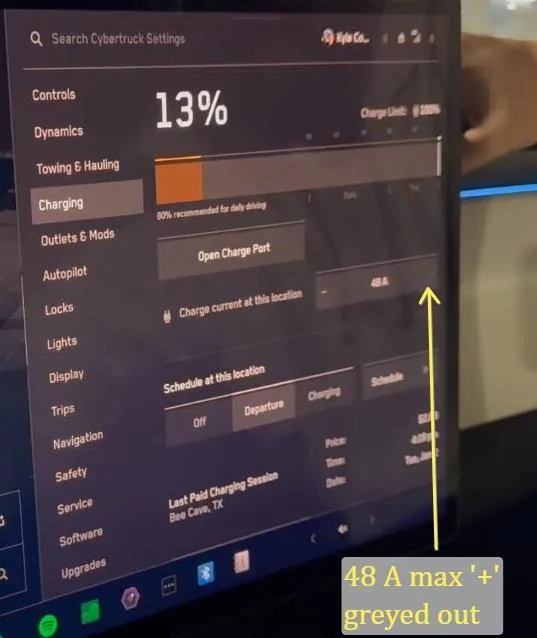

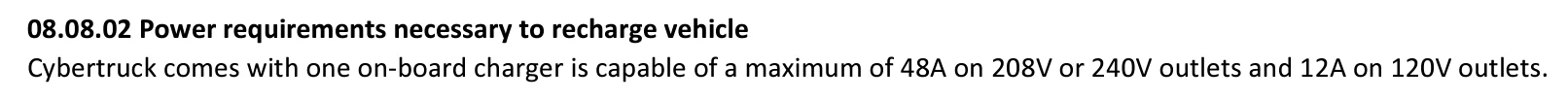

Certainly, you realize that you are a corner case?
40K miles/yr @ ~250 work days is 160 miles per day.
It used to be that the average persons daily drive was < 40 miles (1/4th).
I can appreciate your situation but I suspect Tesla would not account for corner cases like yours.
I would guess they have standardized on 48 amp ... but then again there are some first on the CT including bi-directional charging.
The universal wall connector that explicitly mentioned the cybertruck says 11.5 kw & 48 amps.

Wow constantly amazed at the quality of information that’s available on forums.
Thanks so much for taking the time to answer my question and for providing the source documentation!
As well as the Powershare connector
Powershare | Tesla
In a video, the Tesla team indicated that the built the onboard charger as bidirectional, 11.5kW in or out.
