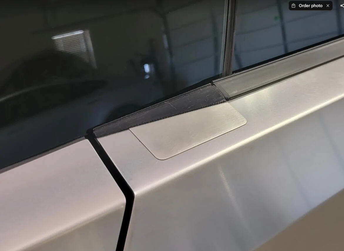

Update: I went through a few more iterations and finally have a decent model for SLM printing in 306 stainless. I printed them with in3dtec for about $60 total for the pair including shipping. The model is uploaded here - use the v3_metal versions for metal only (design rules are somewhat different for SLM than for FDM printing).
I got two pairs so I could put one on while I experiment with sanding the other to match the CT finish. However, the standard glass-bead finish that they come with doesn't look too bad:

I don't know if anyone else printed the metal version of the mirror delete covers. I designed and uploaded a new trim version (_v4) which I think looks better. It extends the trim taper all the way to the edge of the door instead of stopping at the edge of the cover.

Yes but only print the covers in metal (306 SS) and get the glass bead finish (free). The trim pieces should be printed in PETG or TPU. in3dtec does offer FDM PETG printing but I've always done the trim on my own printer so have no experience with in3dtec on anything other than SS. Can't imagine they will be any problem for them if I can print them on a consumer machine, but they might has some obscure design rules that I am not meeting. Let me know if they have any issues and I will fix it.
I went ahead and ordered two of covers for each side (half the cost is shipping anyway). The glass bead finish from the factory looks pretty decent (see my 8/21 post above) but I got a second set to try sanding down to match the truck finish.

Dang it! I *did* see that same 0.5mm DRC message and I fixed it. However, it appears I forgot to update the file on the Prusa site. Delete the _v3 you have and download the "vSS" models I just replaced them with instead.
TPU is a great choice for the trim since it is flexible. The only geometries I found <0.8mm were at the logo and at the notch for the cover (see below). I don't think we want to increase that notch since the cover is only 0.5mm thick. I uploaded a _v4b set of trim pieces with the logo removed. You can see if they will accept it. If not try PETG - that may not have the same 0.8mm rule.
