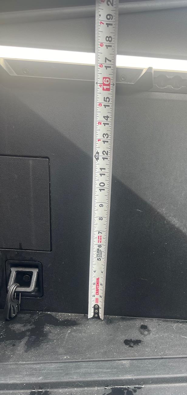

Has anyone measured the height below the cyber tent when it is deployed. I'd like to know the maximum sized items I can slide underneath it. I know the Tesla Bins fit, but I can't for the life of me find their height listed anywhere. Can someone give me some better info on this?

Same as when it’s folded. The brackets all sit at ~16” above the floor. Subtract 1/2” for the raised ridges in the floor and about 3/8” for the how the tent floor sits in the bracket gives just over 15” of true clearance. I have a Dometic cooler (CFX3) that is 16” tall. It bumps up the tent floor just a bit when deployed.

Thank you for confirming this. It looks like 15 inches is the reliable max height of objects underneath then. Sounds like anything larger than 15 is slightly risky depending on if it sits in grooves or not.

You stated your Dometic CFX3 bumps up the floor? As in if you lay in the tent it is putting all the weight on the Dometic? How has that worked out? I was thinking of trying to fit an Dometic under it.
