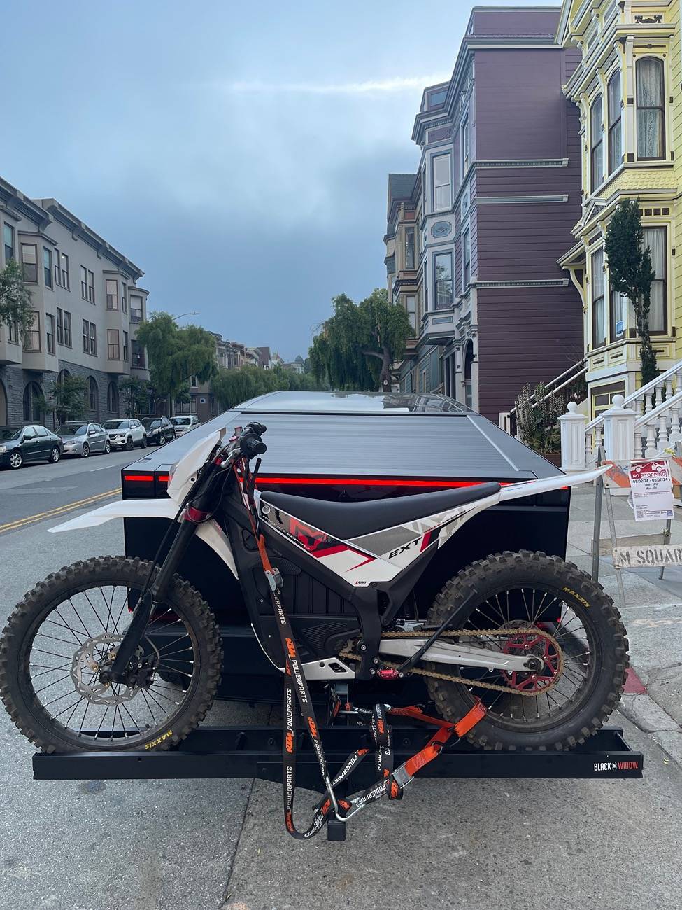

And before I get attacked, this is the reason I’d like to know.
Yes, loads like this are what the vertical load limitation applies to.
That looks like the wheel carrier is quite a ways out from the vehicle and the moment created by what looks like a hefty bike is pretty large.
Now drive down the street and hit a bump, the moment on the hitch may surpass 1,000 pounds.

Here's an example, get a gallon of milk and hold it in your hand, now raise your arm straight out.

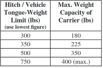

Boss Truck Accessories - Hitch Mounted Motorcycle Carrier -Instruction manual
https://www.discountramps.com/images/art/04100 Boss-instructions.pdf
* Do not overload. Maximum capacity is 350 lbs. on a hitch receiver with maximum tongue weight rating of 500 lbs. Maximum capacity is 400 lbs. on a hitch receiver with maximum tongue weight rating of 750 lbs. See chart below
Do not exceed the tongue weight limit for your vehicle or the tongue weight limit for your hitch receiver.
These may be two different figures. It is your responsibility to ensure that your hitch receiver tongue weight limit is equal to or less than the limit for the vehicle. This should have been determined at the time the hitch receiver was installed.
To determine the maximum weight capacity of your Hitch Mounted Motorcycle Carrier, see the chart below:

I really don't think there should have the difference between vertical weight limit and tougue weight limit from the basic physics standpoint.
Woodrick
3,540
2,231
Gainesville Ga
It's the moments, a very basic physics issue.
Classically explained as Archimedes said "Give me a lever long enough and I can move the earth."
100 lbs at 1 ft from the attachment point it 100 ft-lbs of force.
100 lbs at 2 ft is 200 lbs.
The center of gravity of the bike is probably 3 ft from the fulcrum and is 300 lbs.
Go over a bump and then dynamics kick in and the load goes much higher.
