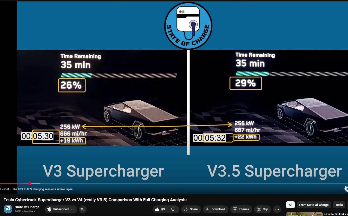

V3 vs V4 (v4 ped & v3 cab = v3.5)
The 325 kW doesn't amount to much at all. At this point in the video (256 kW), their charging curve was virtually the same. It shows 3% diff in that screenshot but most of the time it was 2%.

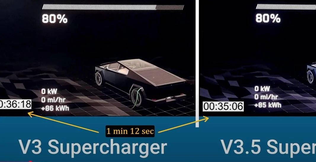

A minute improvement is still a minute improvement. We've seen a bit faster than this test, but so far we have seen roughly a 10 minute improvement of 10-80 since release. This being 10% of that. Odds are when the 500 kW charging gets released it'll be another minute or so. Maybe a bit more since there seem to be a amp boost profile related to something in the stack that we don't see on 800+v chargers. We're in the realm now that a Cybertruck is 10-80 as fast as a LG pack 3/Y. With 500kW (assuming the boost profile issue isn't there is like other higher voltage chargers) were going to be in the realm of a Panasonic pack 3/Y. A minute here or there doesn't sound like much until they are stacked. Which has happened since release here... pretty much exactly following the 3 path with V3 superchargers.
