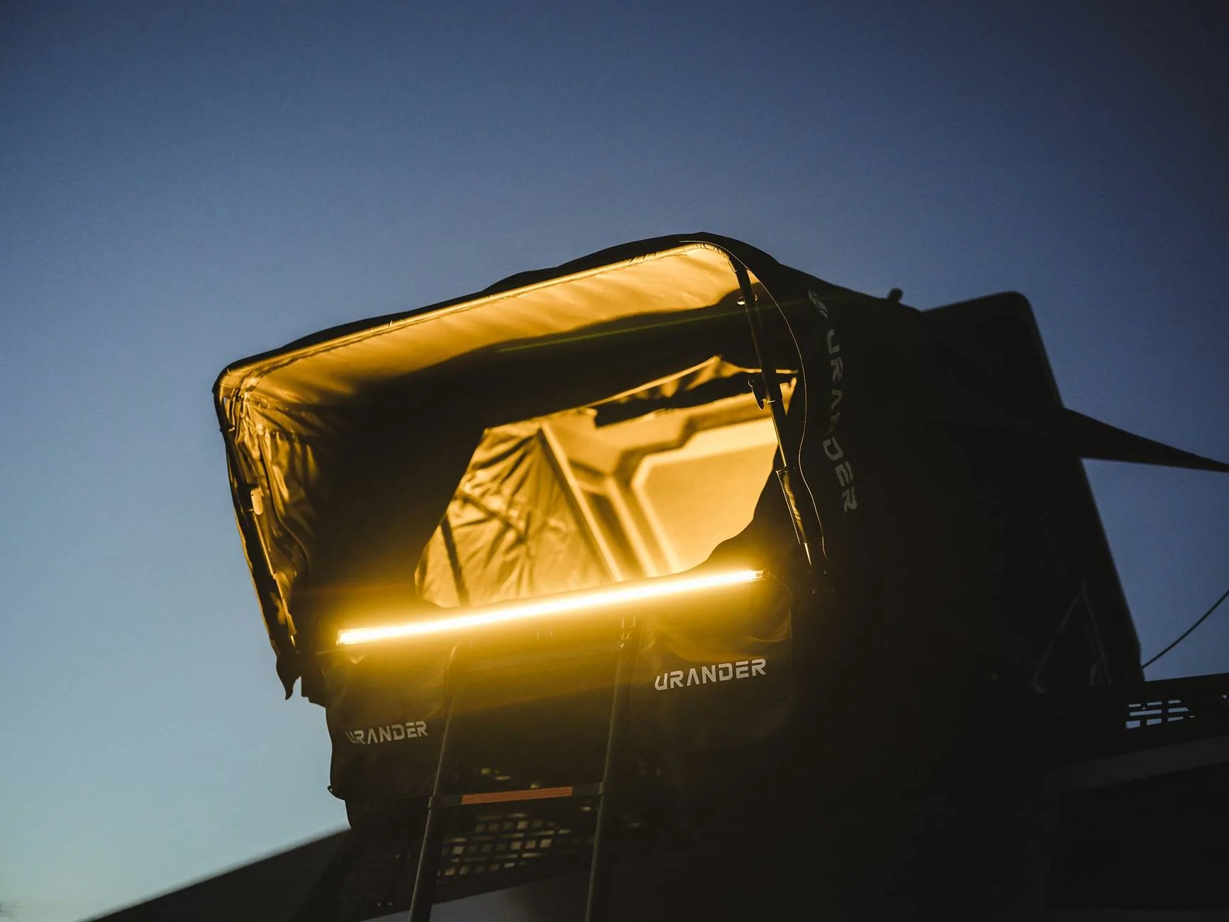

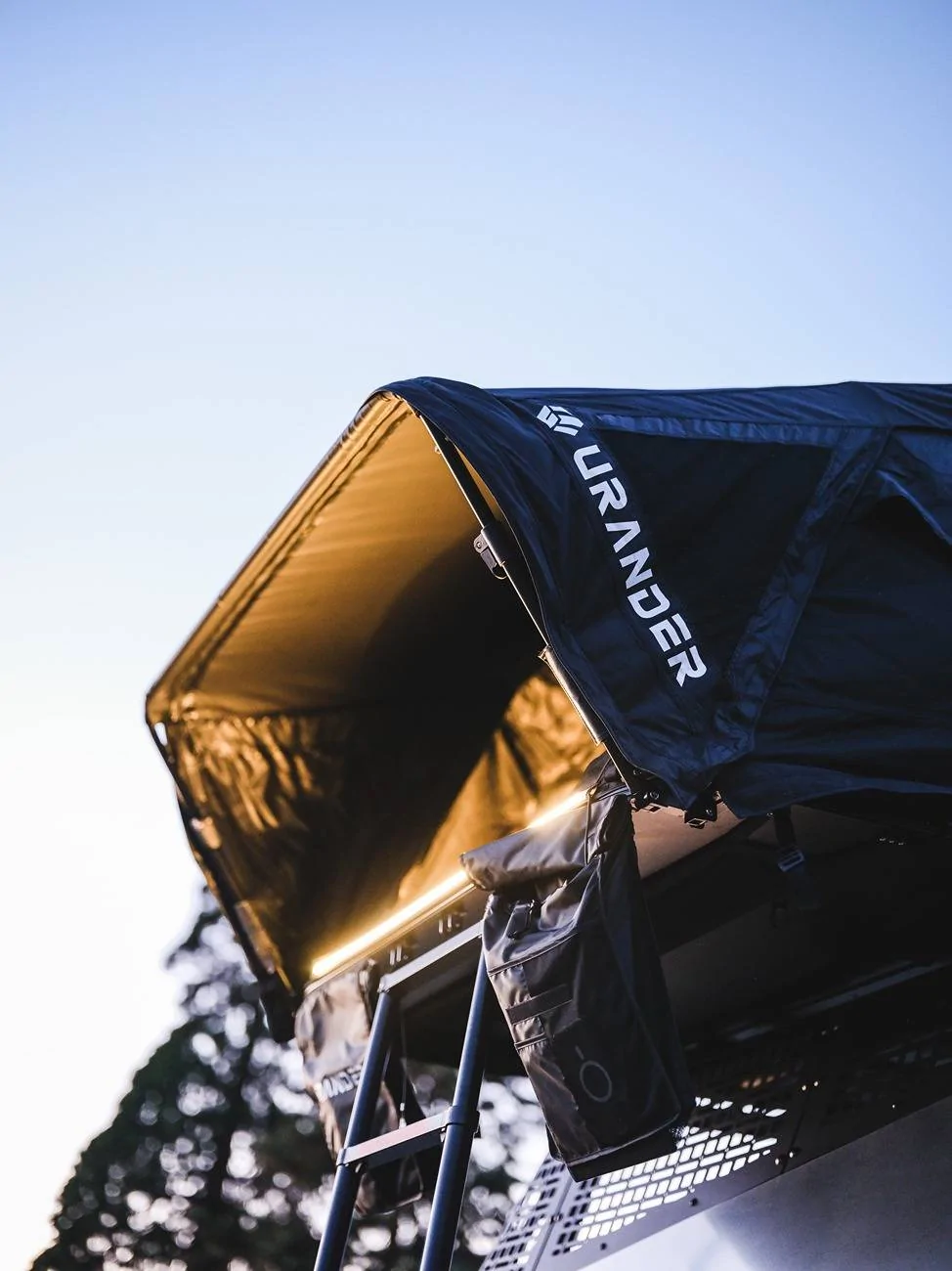

Here are some photos of our awning paired with our first rooftop tent, mounted on both the MOLLE panel rack and the flat panel rack. The setup fits together easily—no rubber riser needed.

Looks like very sturdy, larger cross-members directly under the tent lift the tent above the curved lip of the awning so that the tent and awning work immediately together without the need for additional engineering.
Nice!
