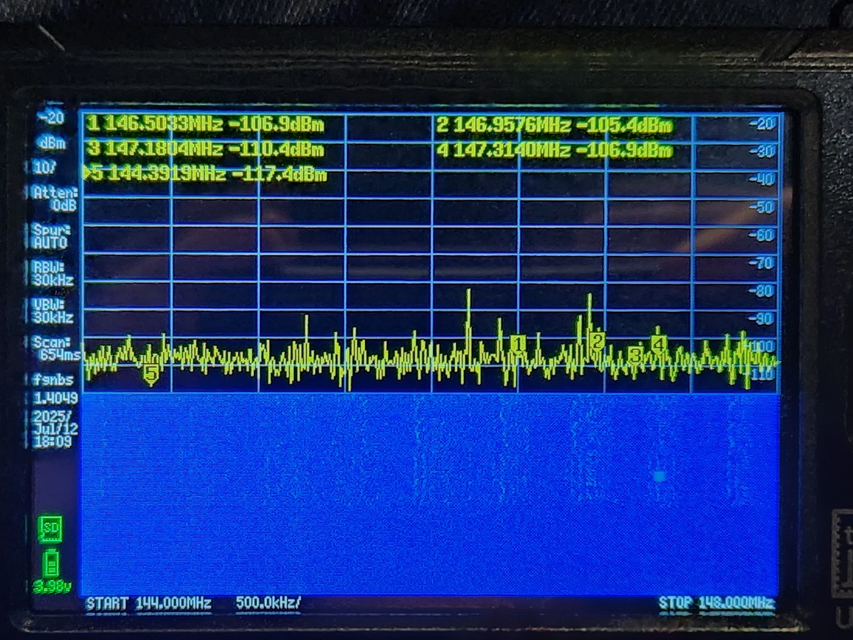

When I installed my VHF radio in the truck, I was initially happy with what I thought was a fairly quiet truck. I didn't hear any birdies I typically have come to expect from computers and inverters. But then I noticed that weaker signals often had noise on them... just a seemingly higher noise floor with random static. So I got out my trusty TinySA Ultra and sniffed around a little.
I did not see any obvious noise on the display, but then I set it to also show a waterfall. At that point I realized that I could cause seemingly random noise to appear when I turned on the 120 Volt outlets. This is what I saw:
Tesla Roadster 2nd gen Two Way Radio People - Cybertruck RF Noise Inverter Nois
The lower part of the waterfall (blue background) is with the outlets off. The upper area is with them on. Next step was to power my radio from a LiFePO4 battery, to take my 120 V power supply out of the equation. This video shows the radio powered by the battery, with nothing plugged into any of the sockets. Sockets are on at the beginning, get switched off and then back on again. Note the background noise that pops on and off with the sockets:

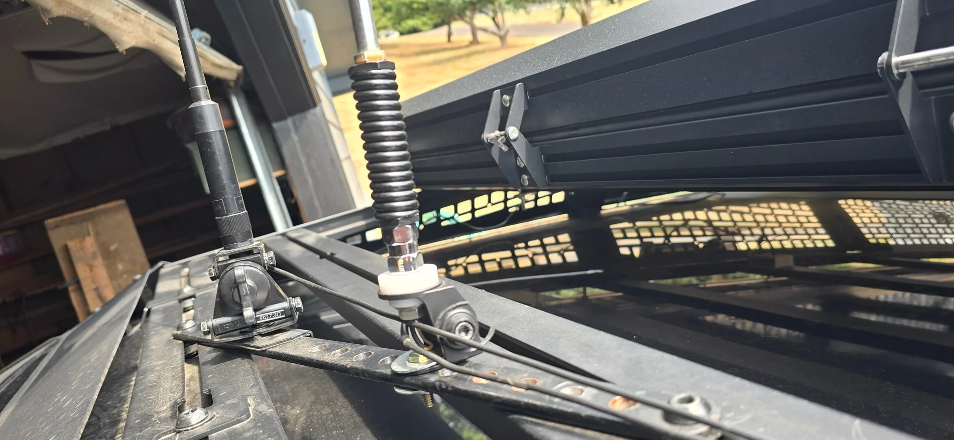

I added a well grounded cross members to mount antennas to my rack. I Duplex in the radio side and on the antenna side so that only one feed transitions from inside to outside.
Power is a normal bench supply secured with the body of the radio within the added center console. I have holes drilled for wiring an heat vent.
HF performance is poor. I think this is the inverter generated noise, though it could be the computers, compressors, heating and cooling of cab and/or batteries, etc

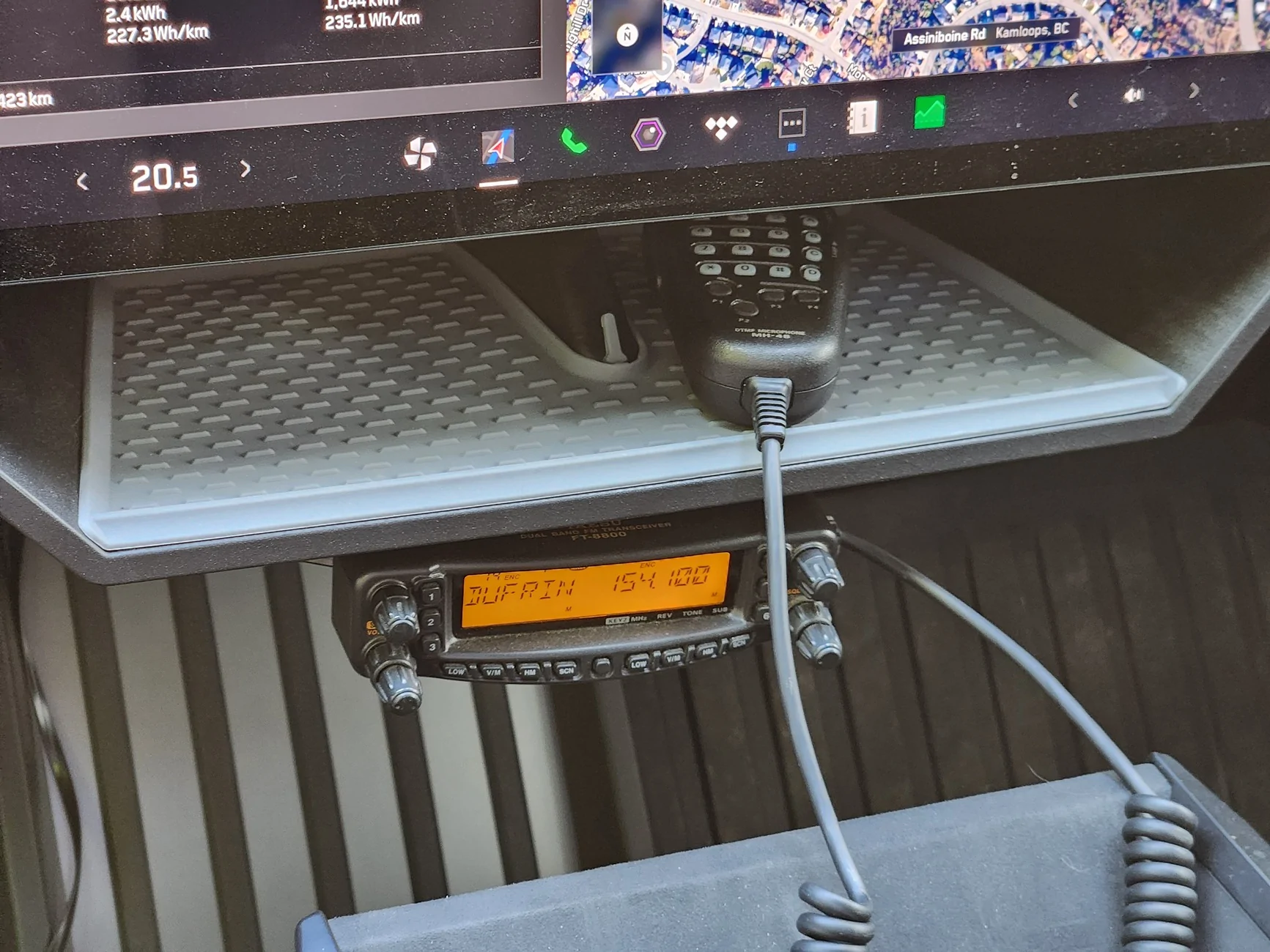

I ended up mounting my radio control panel to an aftermarket underscreen shelf. I added a little steel plate above and below the shelf to stiffen the shelf and transfer load from the bolts, then attached a small tripod ball head to the bottom. That allowed me to connect the control panel and tip/twist it to a position that works for me...:
Tesla Roadster 2nd gen Two Way Radio People - Cybertruck RF Noise 20250801_101320
I tried the whole radio in that position, but the weight made things a bit bouncy and I decided I didn't like that. The body of the radio is now under my seat and I have a LiFePO4 battery in the yacht floor area between in front of the console. I'm watching for a storage solution in that area that would accommodate my battery, but it isn't small (50 Ah).
