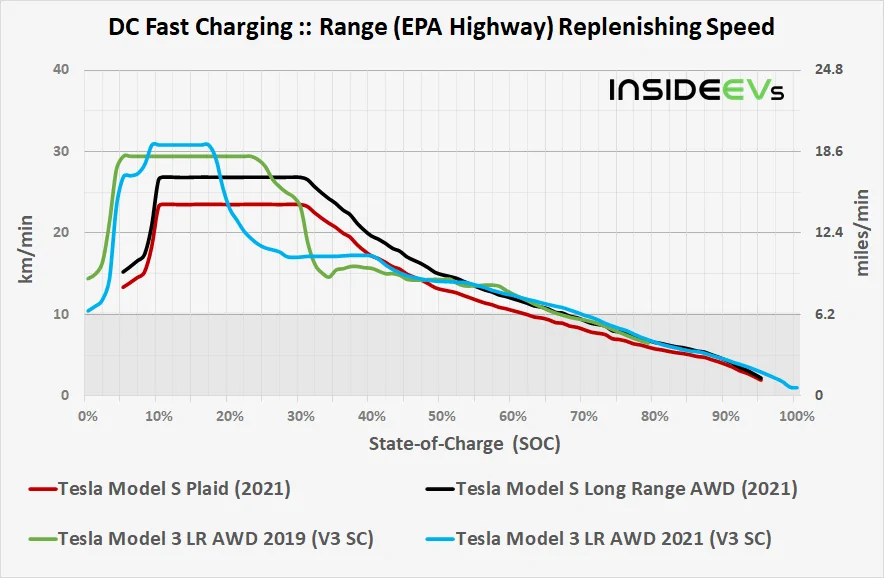

Comparison of range replenishing speed
The new Model S replenishes range very quickly. The peak rate is not as high as in the case of the more efficient Model 3, but it's very quick.
We applied the same charging results to the Model S Long Range AWD, which has a noticeably higher EPA range and a higher range replenishing rate.
Tesla Roadster 2nd gen Tesla Model S Plaid Fast Charging Results Amaze: Analysis -dcfc-range-replenishing-speed-comparison-20210622
Actually, the average in the 20-80% SOC window is better in the Tesla Model S Long Range AWD than in the Model 3 that we analyzed before. Because the tests are affected by many factors, we would say that it's comparable.
Of course, the Hyundai Ioniq 5 is offering the best rate of all EVs tested so far:

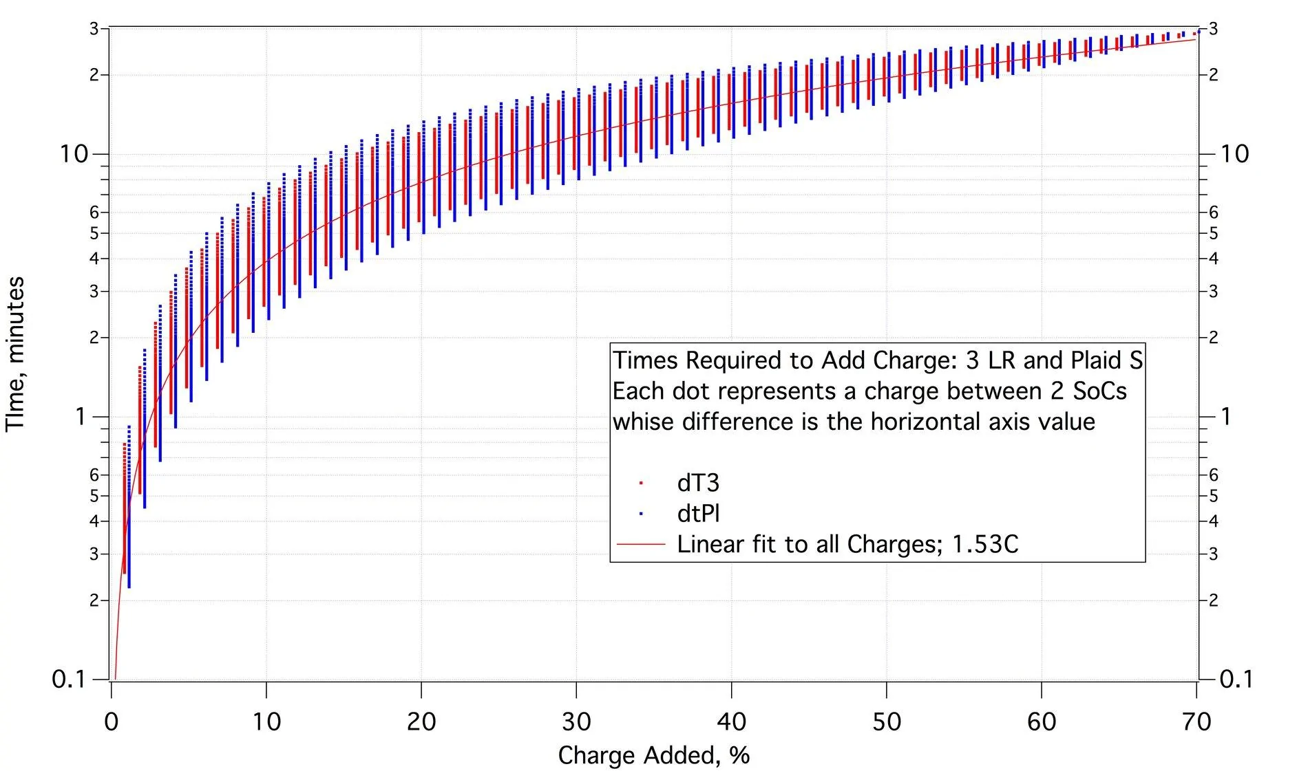

Thanks for posting that. After all is said and done the Plaid exhibits an early charging rate (to 30%) of 2.5C, a 20 - 80% rate of 1.26C and a high end rate of 0.43C. As we saw in another post on charge data for Teslas these numbers are similar to those for an X LR+ and a 3 LR if slightly better. The X showed 1.11C and the 3LR 1.17C in the 20 - 80% SoC range. The rule of thumb I originally proposed was .01 hr (.6 minute) charging per percent SoC added in the 20 - 80% range because that is so easy to use. It looks, as more data comes in, that the actual number is smaller. 1.25C is 0.008 hr (.48 min) per %. We want the ROT to be very easy to use so, for the moment, we propose 0.5 min per %. Thus if you want to add 40% to your battery in the nominal operating range it would take 20 minutes (as opposed to 24 under the original proposed ROT). So I suppose we might modify the ROT to say "It take from 0.5 to 0.6 minutes to charge a Tesla per percent of charge taken on" with the caveats that it will take a little less time if you terminate at low SoC and a little more if you terminate at a high one. The nice thing about this is that the ROT doesn't say which model Tesla nor which version of the SC (though the Urban SC at 70 kW is out). Another caveat is, of course, that it is early days in terms of the number of Tesla vehicles examined. It appears that Tesla's charging philosophy is to maintain an average charge rate of about 1C with a certain amount of taper. A new battery, such as the ones used in the CT might allow for more aggressive charging by which we mean average rate higher than 1C realized by less taper.
All this is based on the curve these authors derived from a single charge. They, wisely, caveat the data because of this and mention some of the things that change rates so that the ROT needs refinement by looking at a number of charges. While looking at a couple of charge histories suggested that the X rate in 1.11C looking at an ensemble of charges suggest that the actual average rate is 1C after all.
Anyway, nice to have more data confirming the hypothesis.
The article says, based on the usual kW vs SoC charging profile for the Plaid
If we look at the charging curve, we can see that the new Model S appears to be much more capable than the Model 3 Long Range.
It is a common misconception that a charging curve that breaks later gives "much" better charging performance. It is not that which is important but rather the SoC vs time curve (which can be derived from the kW vs SoC curve). When we looked at the Plaid SoC vs time curve above we found that it is only slightly better than the Model 3 LR curve.[/QUOTE]

And the question there is where is the Plaids extra performance coming from ...
The thing is that there actually isn't any extra performance. Overall the Plaid exhibits average charging at 1.53C which is, to two decimal places, the same as the long range 3. Even my ancient (2 yrs) X does 1.34C.
So that all depends on how long your measuring stick is though? ;-)
That might be true for a 95% SOC but not for between 10-30% SOC? The argument being that frequent low SOC charging equates to shorter overall long trip driving times, if they are beyond the range of a single "tank".

No, they are very close to being the same for small, large and intermediate charges.
Easy to say but to show that I have prepared a graph which illustrates it:
Tesla Roadster 2nd gen Tesla Model S Plaid Fast Charging Results Amaze: Analysis Logrates
This graph is the same as the ones I have posted earlier except that I have put every charge I calculated (5,041) for both the 3 LR (red dots) and the Plaid (blue dots). I have also plotted the linear fit to the Plaid which has the same slope as the linear fit to the 3 to 3 significant figures. That alone says that on average the Plaid's charging performance is not better than the 3's. Note that this is a log plot so the linear fit does not appear as a straight line.
As mentioned when I first presented this plot type in another thread, the vertical extent of a column indicates the range of charging times to take on a particular % change in SoC. Thus the Plaid can take on a 30% charge in as little as 8 minutes (0.27 min/%) but it may take as much as 17.6 minutes (0.59 min/%) depending on whether you start at 10% or 60% SoC. The corresponding rates for the charges are, respectively, 2.25C and 1.03C. The linear fit line appears to cut the column just about in the middle and this is a log plot that implies that the best fit line represents the geometric mean. The geometric mean of 2.25 and 1.03 is 1.52 and the slope of the fit line is 1.53 (. 39 min/%). As this is a log plot the vertical extent of the columns of dots represent the ratios of maximum to minimum charge times. What these data show is that while on overage the two cars charge almost identically the ratio of rates is higher in the Plaid being 2.19 relative to the 3 where it is 1.84.
Now the ROT for these two cars is 0.39 minute per percent. The chart shows that for very small charges (around 1%) the maximum rate can be 4 times the minimum rate. As the ROT curve splits this range we deduce that charge rates and thus charge times can be as much as double or as little as one half what the ROT predicts. For more reasonable charges (take on 30% or more) the extremes differ by a factor of 2 and so the range of expected charging times could be expected to be as much as 141% (sqrt(2)) of what the ROT predicts or as little as 70.7% (1/sqrt(2)) of what the ROT predicts. The picture clearly shows that as we go to higher charge increments the vertical extent of the colums diminished so that, for example, at 50% the extremes of charging times would be with about ±20% of what the ROT predicts.
I think it is appropriate to mention at this point that we (or I) are mining a lot of conclusions from two curves the provenance of one (the 3) is unknown. But what we have learned should be, at least, representative of what we might expect to see in the real world.
