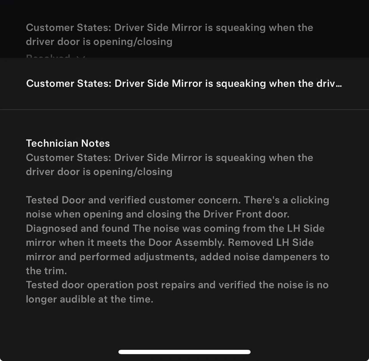

Anyone else’s side mirrors squeaking every time they open and close the doors? Would love to know a solution…
That is one of the long list of things mine is in service for this week. Here are the technician notes.
