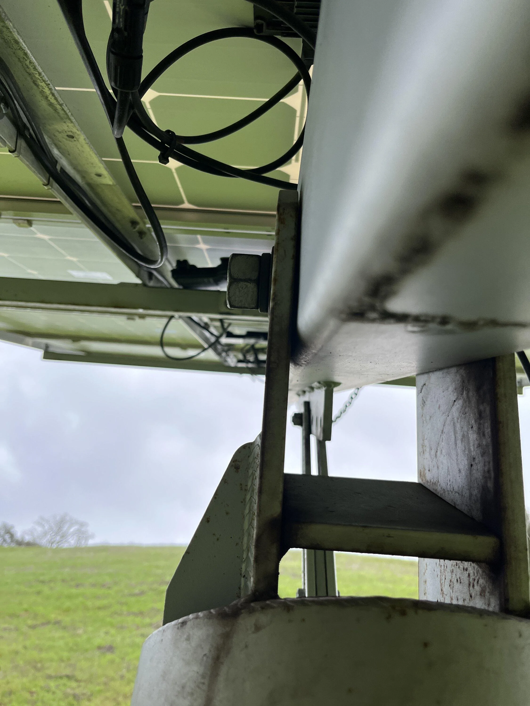

Just make sure they're beefy. Here's what mine were doing yesterday in the "Bomb Cyclone"....... (never seen it like that before).
I assume they are engineered to withstand winds up to a particular range of wind speeds, no? It looks to me like it was only gusting to 60 mph, or so.
Are those mounted on mono piers because they are tracking arrays? I thought PV had become so cheap it made more sense to simply over-install fixed panels facing a range of directions and not worry about maintaining tracking hardware.

The one on the left looks pretty stable, but the right one seems to have a fair bit of slop in the mounting hardware.

yes, gusting to 60 MPH I think. They did have a tornado (official now) down in LA, but that is 200 miles away.

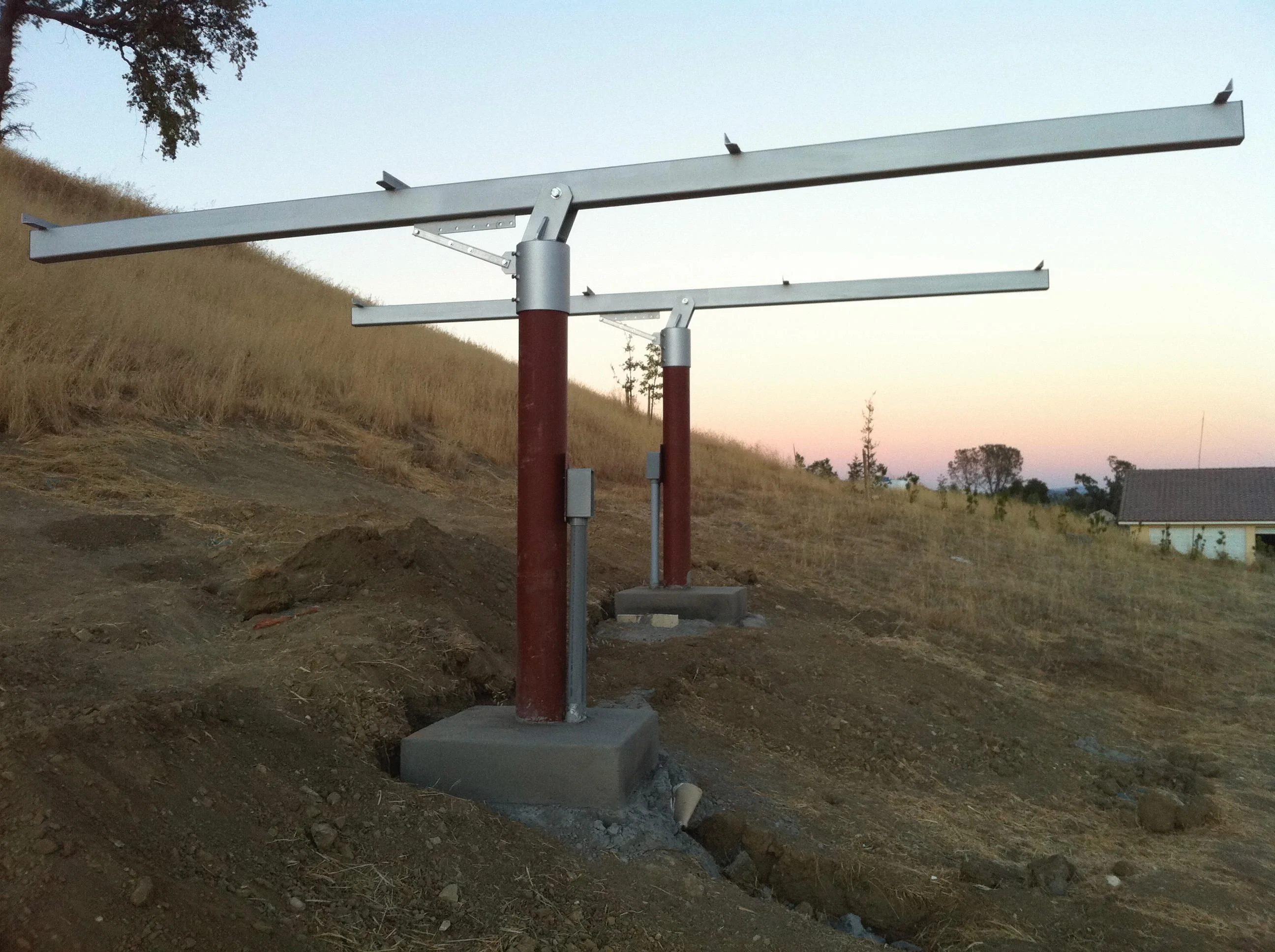

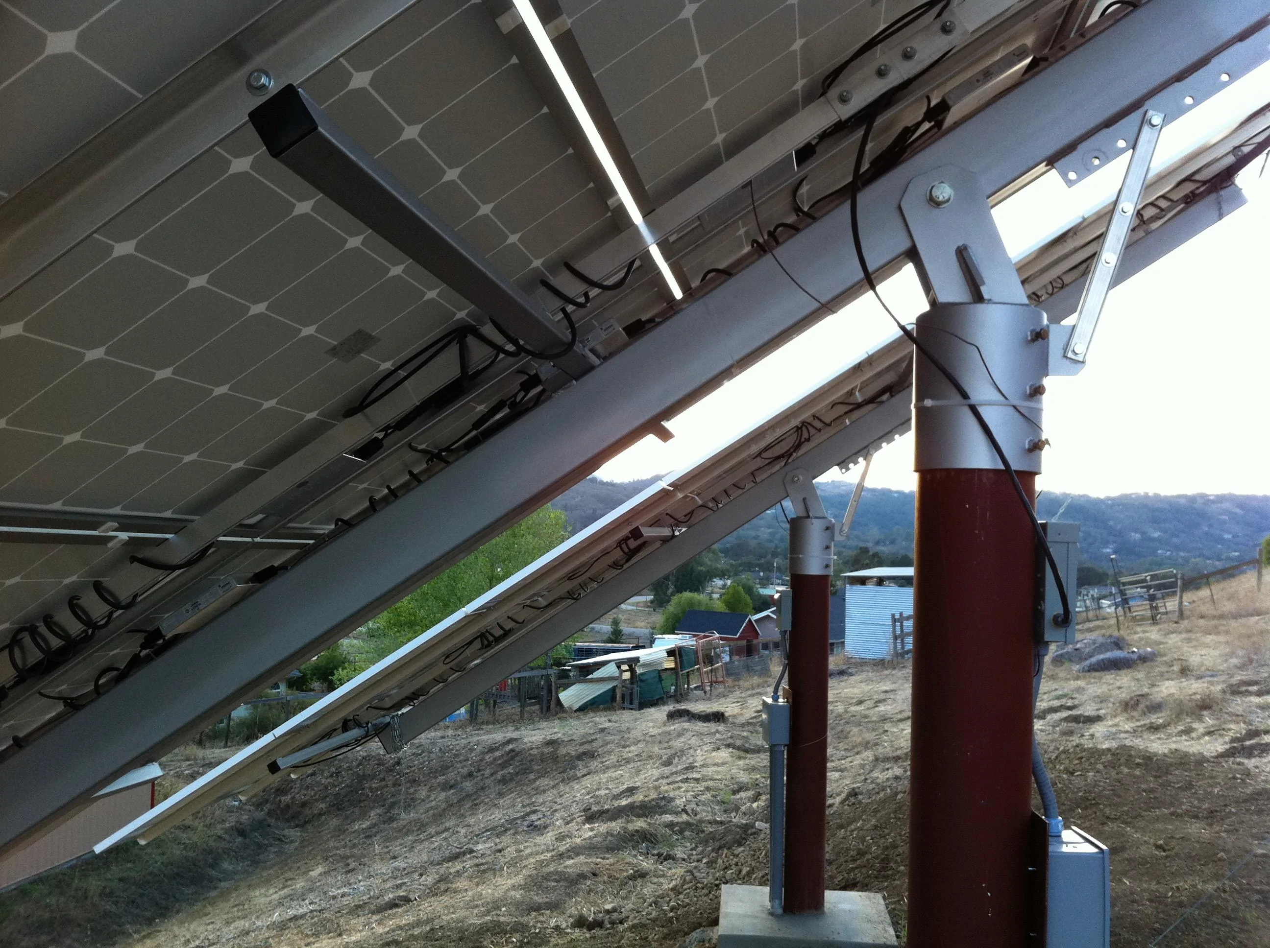

They are definitely engineered for wind loads, footings are 3 foot diameter x 7 feet deep, poles are 8" diameter. So I was quite surprised to see (heard it first!) it doing that.
Angle didn't help either. Tilted at 35 for the winter, but yesterday should have been the day (equinox) to re-position to 15 degrees. But I'm recovering from surgery and plus the weather has kept us from getting up there.
Yes, when we did the install, even in 2010, the analysis was better to add more panels than pay for solar tracking. So these are a compromise, they have one axis of tilt, and it's done manually at the equinoxes So 15 degrees for summer, 35 for winter. About a 10% increase in output. It's a two person job (one to remove and reposition the bolts and one to pull on the chain to perform the tilt). I need to come up with an "old age" strategy for doing that once JR is gone and we're too old to handle it ourselves. I've though about a boat winch, etc.
So something is loose I think, just need to find it. A visual inspection looks good. It could just be a whole bunch of "slightly loose" that adds up.

Culprit identified. Center pivot bolt on the beam was not torqued down, visible light between the members! ?
It is VERY tight now.....
