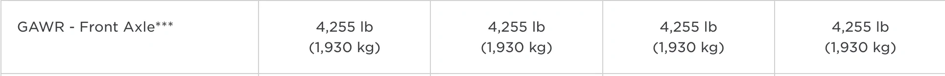

Of course, the other consideration is, what is the front-axle weight rating for the CT. I have not seen that, but it is something to validate before you put up to 1000 pounds hanging on the front. I know the frunk is limited to somewhere between 400 and 500 pounds.
Others may have more information or better information.
Front Axle GAWR on the CT is 4255 Lbs.

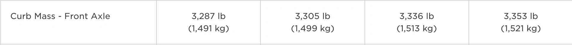

Curb Mass of the Front Axle is 3287-3353lbs.

So the CT has between 902-968 lbs that it can handle... so as long as he chooses one that weighs within those parameters along with the mount, he should be ok.
