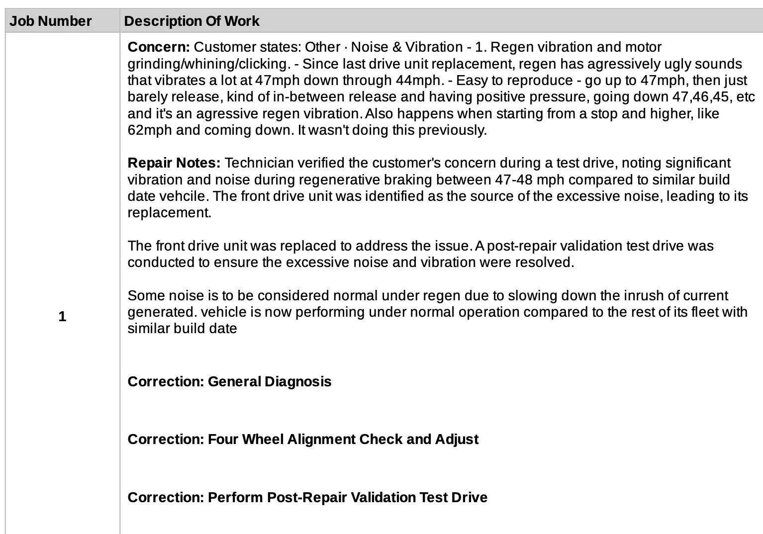

Also, here are their notes.
I also added my service replies to the app, said "Like you said,it's still easy to reproduce at 45 and 47 and you mentioned your service center won't review it anymore right? I'll monitor and if issue arises, is it fine to take to another service center?" LOL. I know I can, just wanted to see if they feel any urgency to a long term repeat customer.

And Tesla replied to chat, and they said they did, in fact, check both rear and front and only front didn't pass spec which led them to only replace front.
