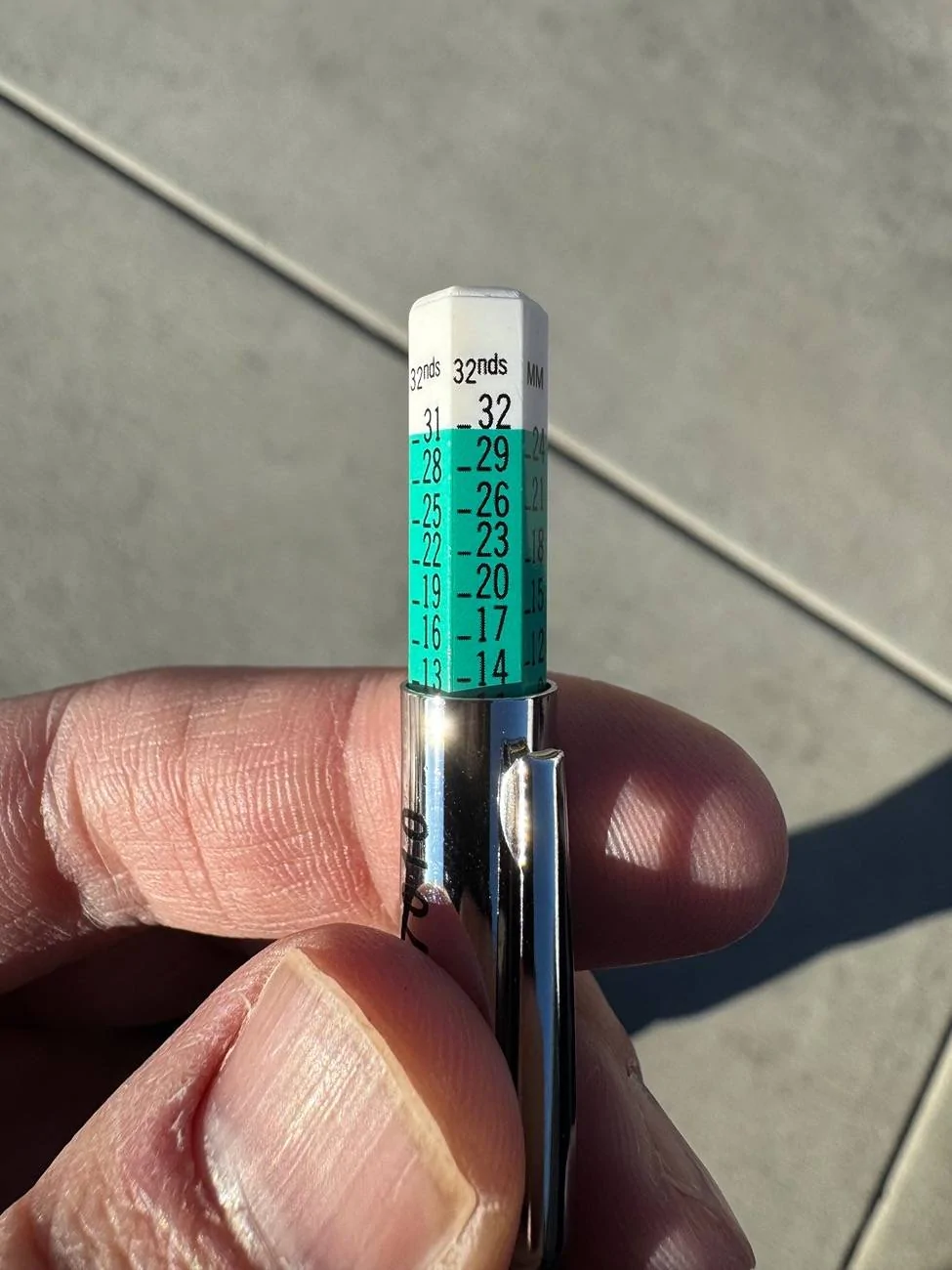

Would you be willing to take a tread depth measurement when you take delivery or shortly after that? I recently picked up the spare tire kit and that tire had 13/32nds new. I’m curious if the new rides with AT have the same.

Update on this... I ended up stopping at a tire shop and asking about siping the AT tires and the guy at Les Schwab east of Spokane, WA said the trouble is that the AT tire is s "summer" rubber compound and basically freezes at temps below freezing. Whereas a dedicated winter tire has a different rubber compound that is made to stay soft at freezing temps and grip the road better. So I ended up putting the 275/65/20 Nokian LTs after all.
Also to answer the tread depth question my OEM AT tires measured at about 10/32nds tread depth.
