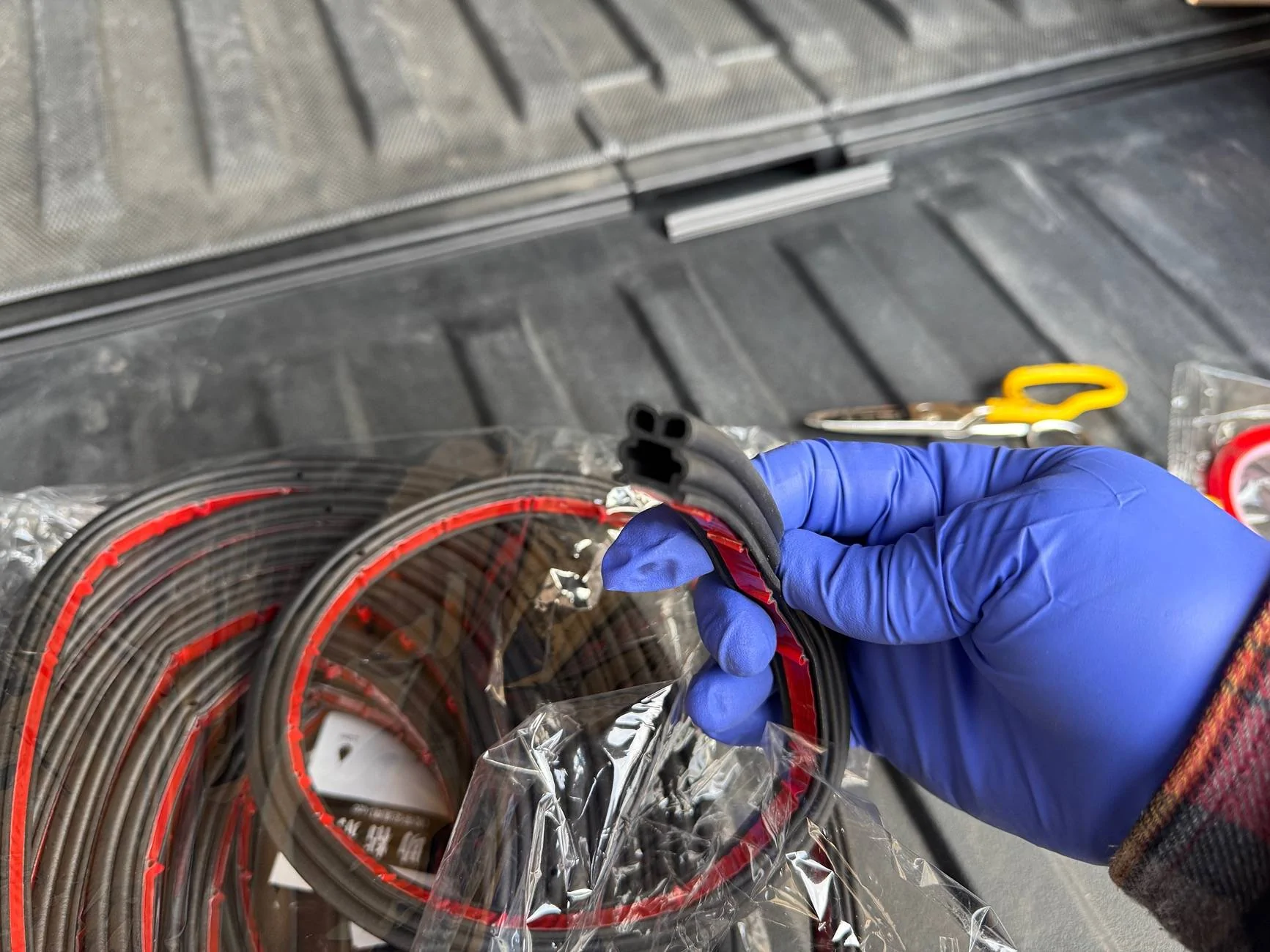

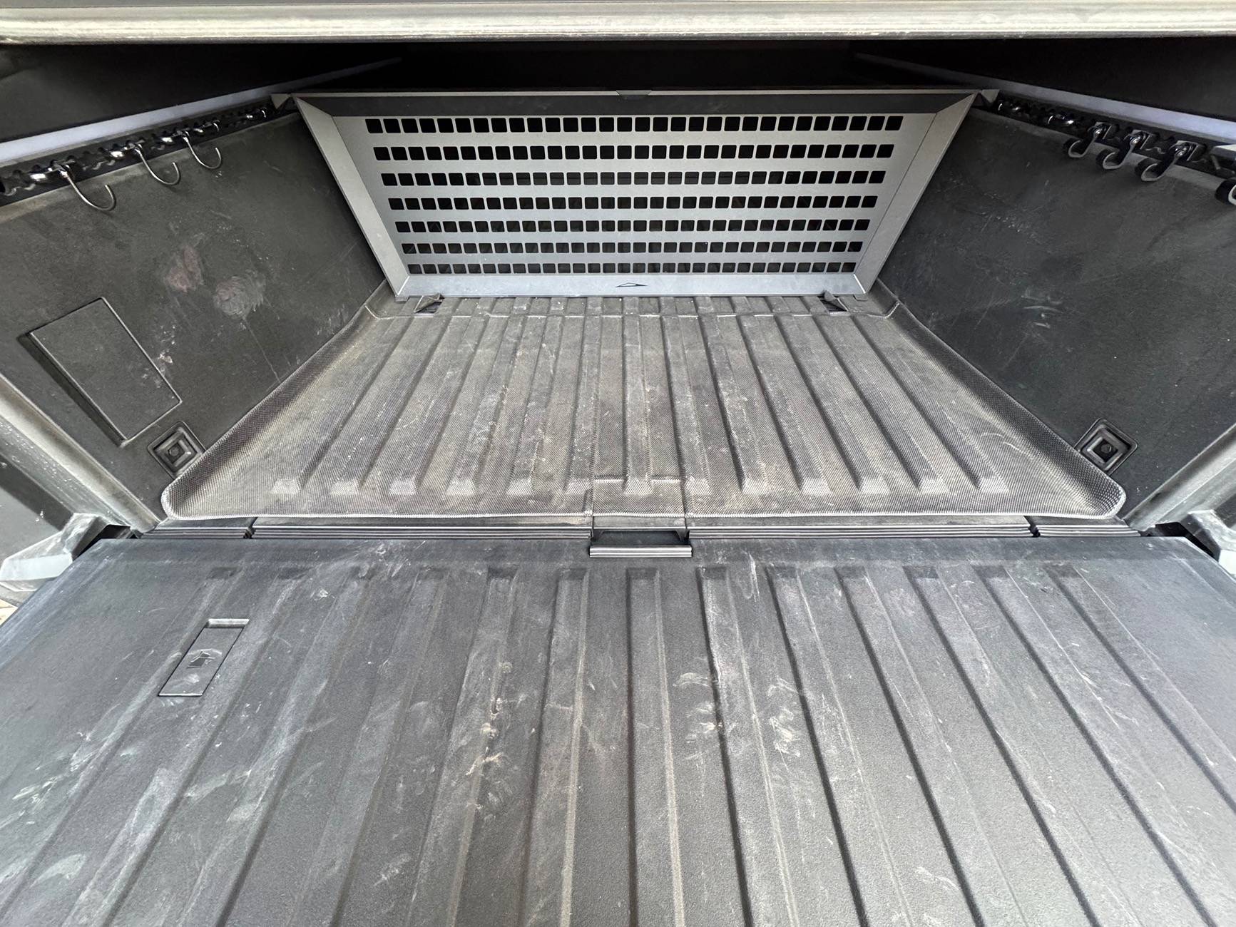

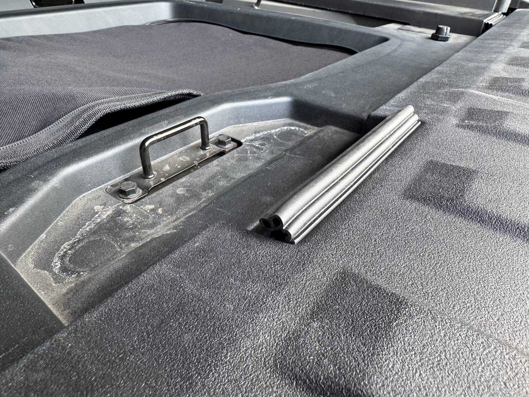

I was inspired by @ogdobber's method but wanted to use weather stripping instead of adhesive foam strips. After doing some brief research, I found some 15mm thick strips that works well. There is a small amount of pressure applied to the weather strip when the tailgate is closed which is why I prefer it compared to foam as the weather strips should continue to spring back to shape. Overall, it took about 15 minutes of cutting and placing onto the right locations.
Weather strip: https://a.co/d/hnYIe5j

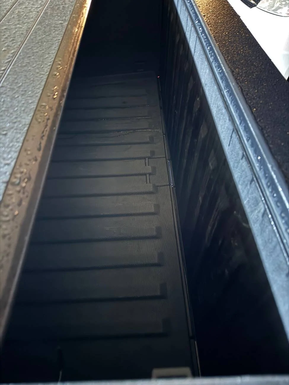

@devdrone6 I was in the rain for most of the evening tonight both driving and parked. Checked the bed after getting home. Other than some water that came from the front of the bed, the weather strips held up great with no water or dust in the rear by the tailgate

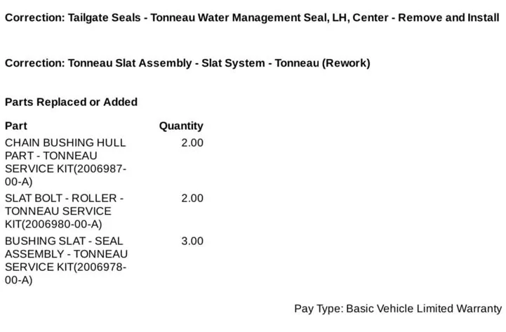

Service center will fix the cover to make it water tight.
under warranty too
