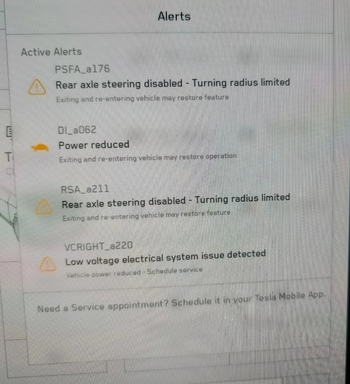

I just got this error today. Is this the same problem? I get a prompt to accept the override whenever I drive using the buttons on the mirror. Then the screen flashes red to pull over immediately. I have only tried to move slow to change parking spaces so not sure if the speed is limited to less than 50 mph as the other problem mentioned here.

This is NOT the same error and issue that I had which has been fixed by Tesla Service.

UPDATE: Service Center resolved it today by replacing the PCS. Done in 1 day.
