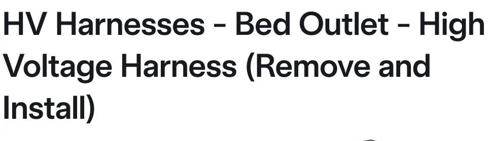

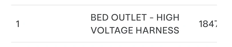

I'm not quite sure about the second set of contactors though. The bed outlet doesn't really show any control lines, although they could indeed be coming from somewhere else.
HV Harnesses - Bed Outlet - High Voltage Harness (Remove and Install) (tesla.com)

Isn't that pretty much what I said?

I'm not talking about the 120/240V bed outlet, I'm talking about the extender outlet.
Did you even look at the link?

I just clicked on the link in your response. It sent me to the right page as shown in the left-hand side index
What do you mean "right page"?
The bed outlet harnesses connects to the 5-20 / 15-40 outlets (line above the highlighted one) and AC junction box, not a range extender (which would be at the front of the bed, not rear).
