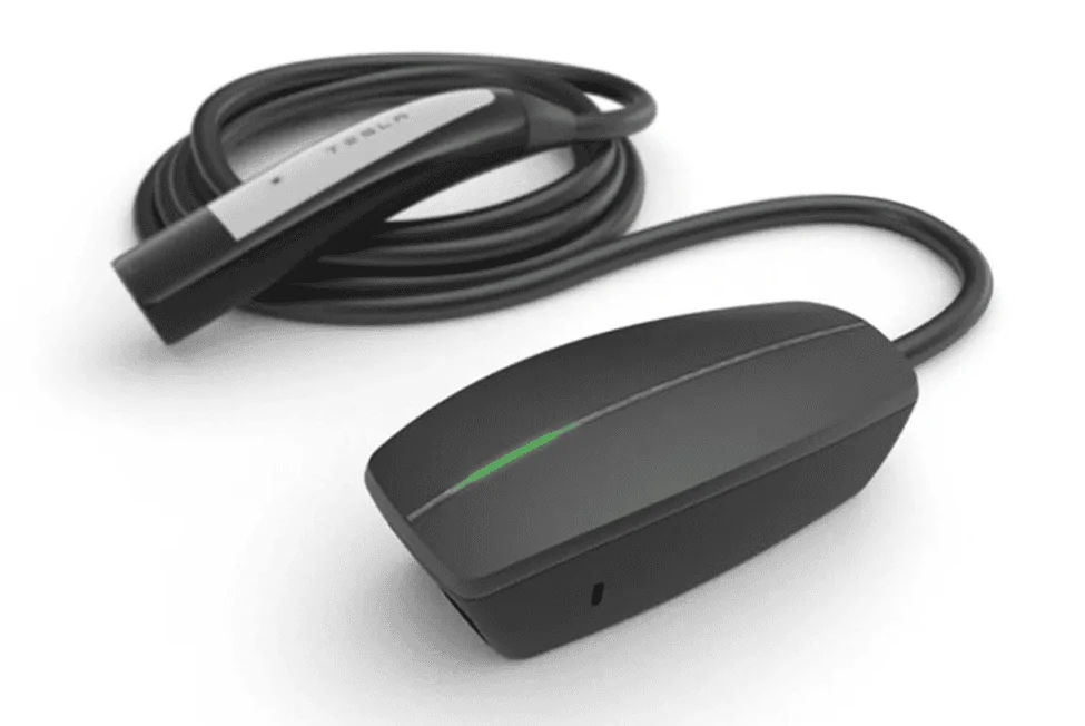

Gen 3 PowerShare Mobile Connector (PSMC) is the unit included with the FS series charging equipment. This is supposed to allow for charging other EVs (Mobile PowerSharing) from the vault outlets. The Gen 3 connector functions the same as the Gen 2 Mobile Connector in the Tesla Shop to charge while you're at a location without a Universal/Standard Wall Connector, or without a charge station nearby. The Gen 3 that comes with the CTFS includes (1) 5-15 adapter, and (1) 14-50 adapter. However, Gen 3 is a different unit than the Gen 2 in the Tesla Shop:
Gen 3 PSMC received with CT FS:

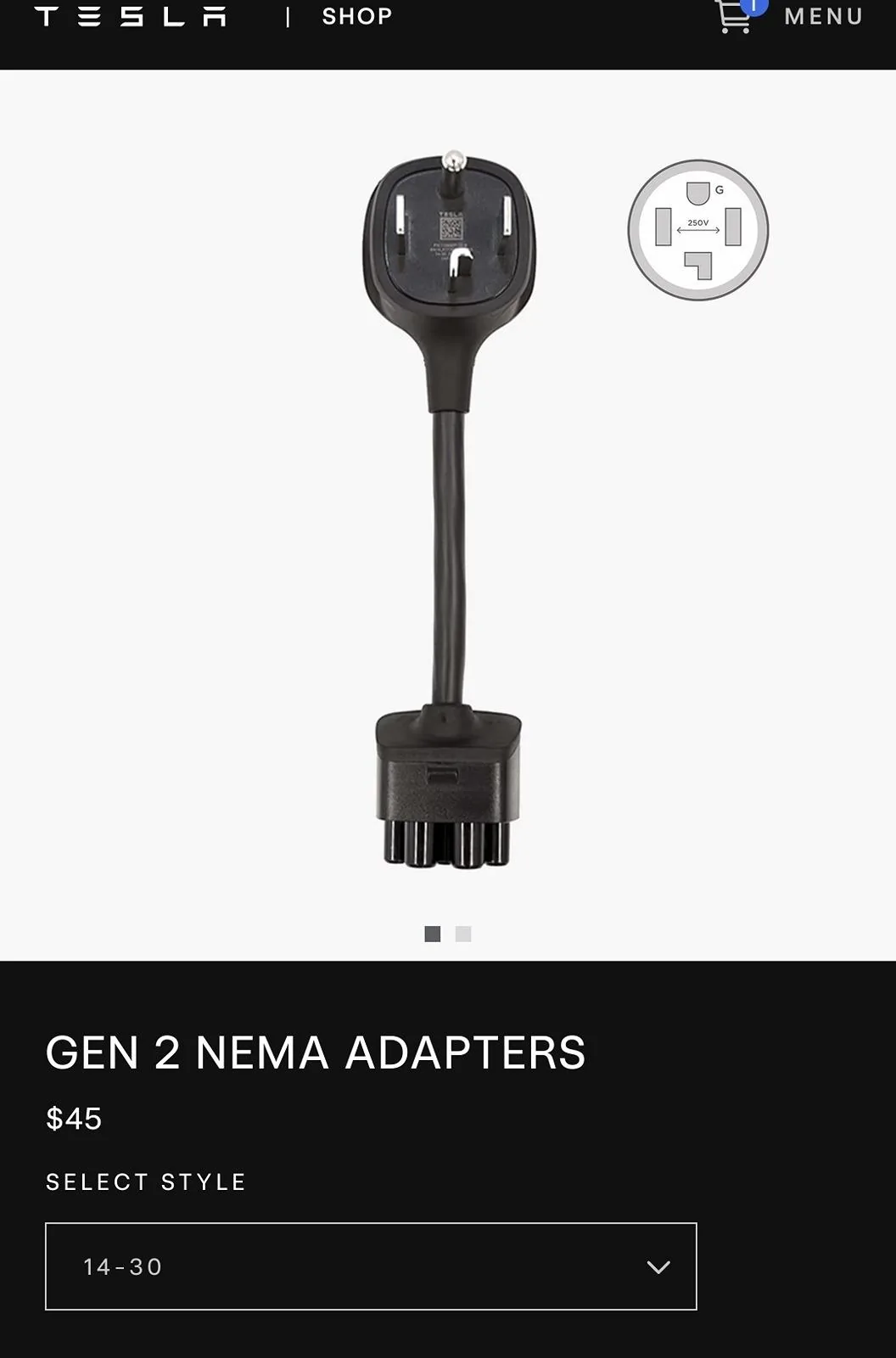

Gen 2 Mobile Connector (Tesla Shop):

I finally caved and purchased (1) 14-30 adapter from the Tesla Shop, since these are the only adapters available for purchase at this time. Unfortunately, upon receipt and testing, my excitement was immediately deflated when the PSMC did not work with the 14-30 adapter direct from Tesla. I had hoped it was a programming thing with the generic brand 14-30/14-50 adapter I purchased from Amazon not talking to the PSMC, but the Tesla 14-30 direct to PSMC didn't work either.
