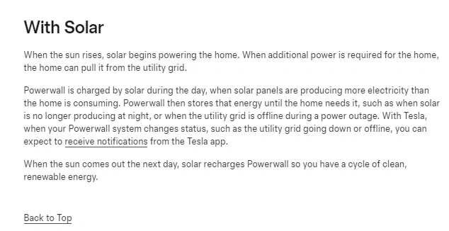

Why would it ever be compatible with Solar panels?
What would be the benefit of having them connected to your Solar panels.
The Powerwall Gateway yes. Because it is used to change direction of energy flow.
if it was your panels. It would send energy back to your Battery or Home. Not your panels.
Let me know if I’m overlooking something.
From the Powerwall Tesla website:
Tesla Roadster 2nd gen PowerShare Gateway Not Compatible with Solar yet!? 1722603473984-4
Ref: How Powerwall Works | Tesla Support

The only plans that I know of is Tesla solar with Powerwalls.
