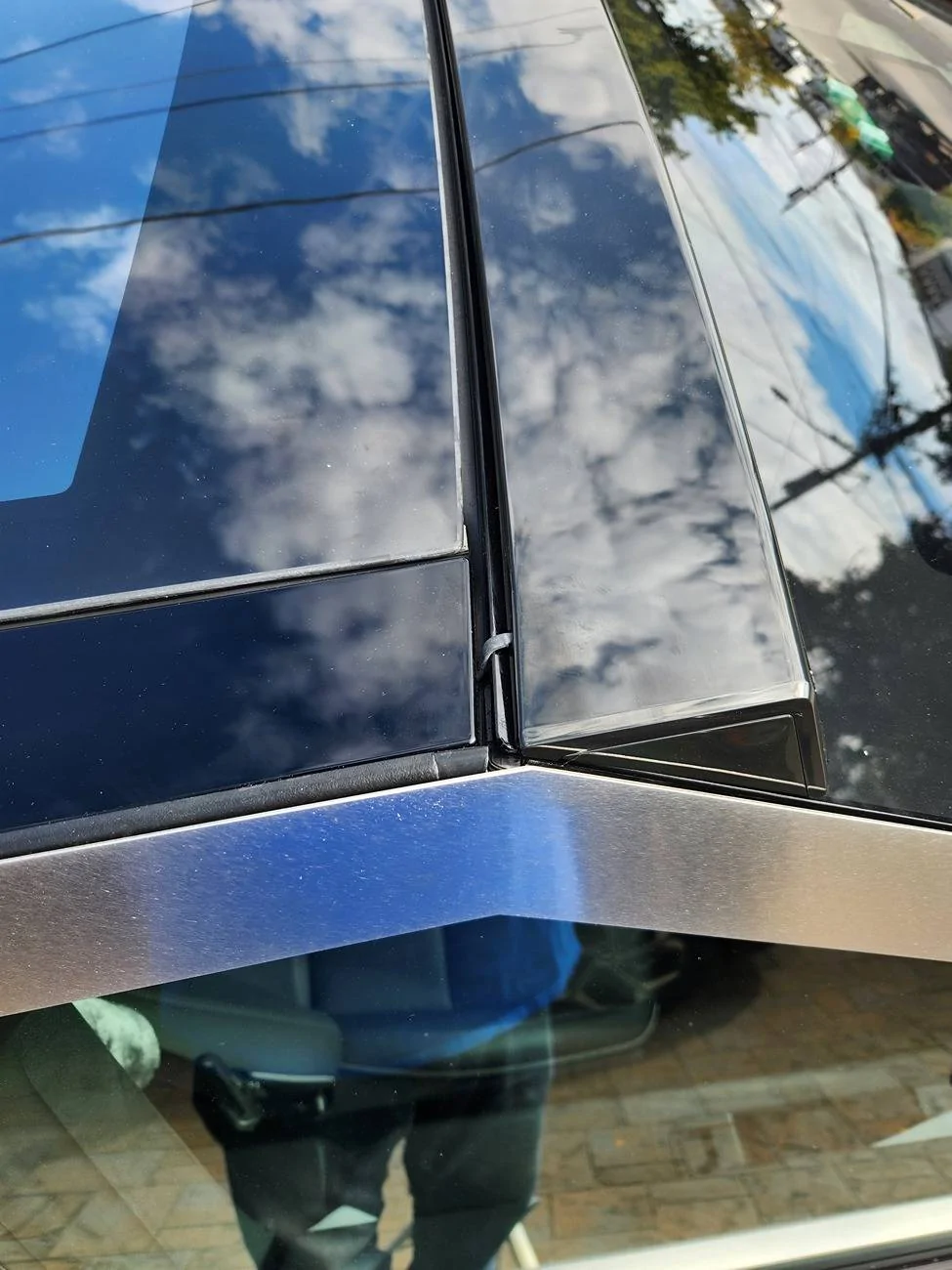

Did you measure the gap between the windshield and the lightbar? I got mine yesterday and i have 3.95 mm or 5/32 inch. According to Tesla, it should be flash and about 1 mm gap.

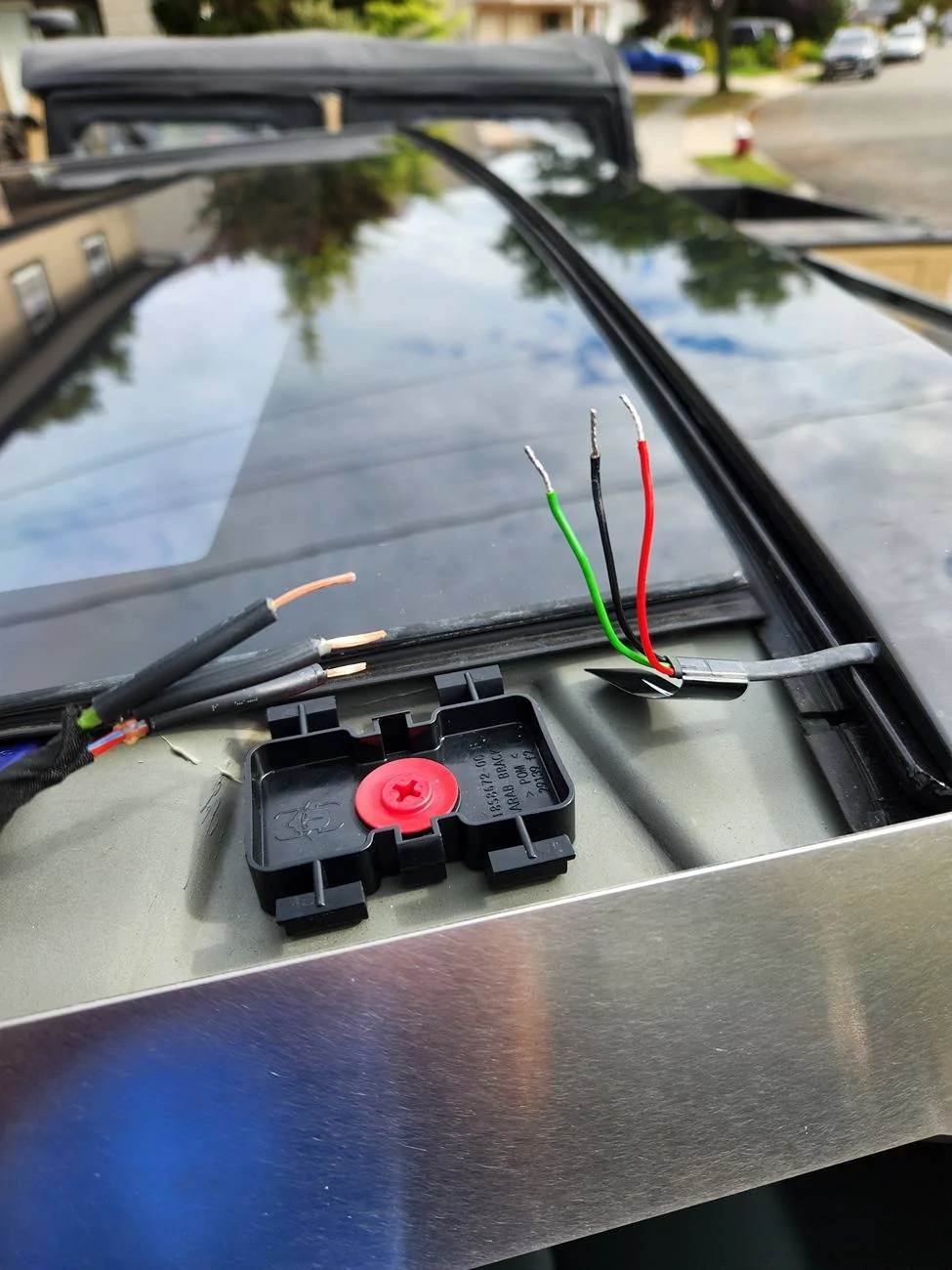

Connected & working. Here is how I did it, not a recommendation:
Lifted the roof applique using plastic trim tools. Rolled up a towel to hold it out of the way.
Removed the shrink tubing from the lightbar side and stripped back the insulation from the vehicle side to expose wires.

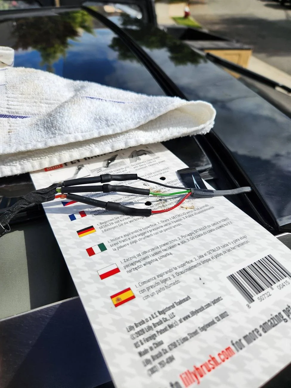

Soldered the appropriate wires together: red to red with blue stripe, black to black with blue stripe, & green to green.

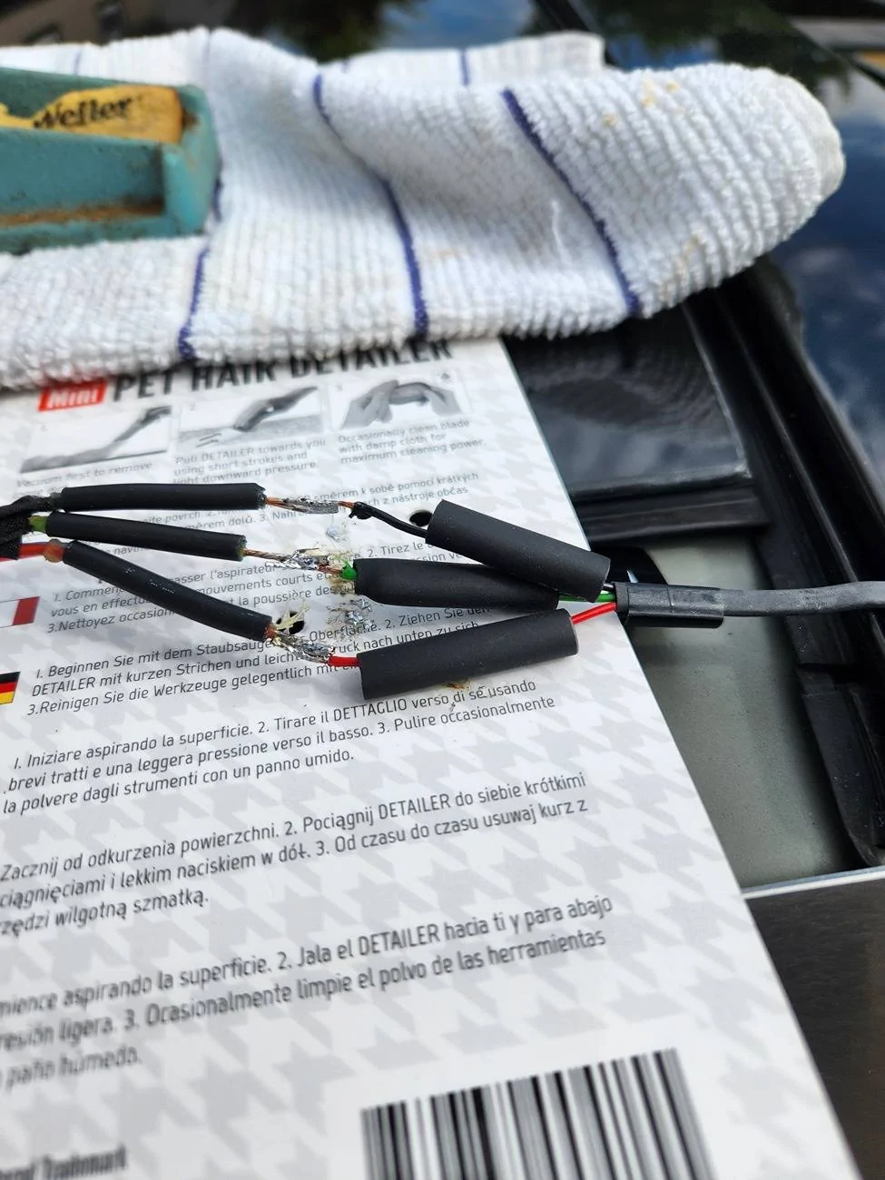

Slid heat shrink tubing – 3/16” (previously put in place) and shrank it using a heat gun.
Slid a large heat shrink tube – 3/8” over the 3 connections for added abrasion protection and shrank that down (probably over kill)
Routed the cable neatly alongside the clip receptacle, checked the wire from the light to make sure it doesn’t get pinched. Snapped the applique back into place.
Tested the light as I went along (after steps 3,5, & 6)
Hi Beastew, did you measure the gap between the windshield and the light bar? mine is 3.95 mm. I'm wondering because Tesla says it should be only 1 mm

I didn't measure it but it definitely look closer to 4 mm than 1 mm

The instructions say 2 mm down from the top of the windshield
