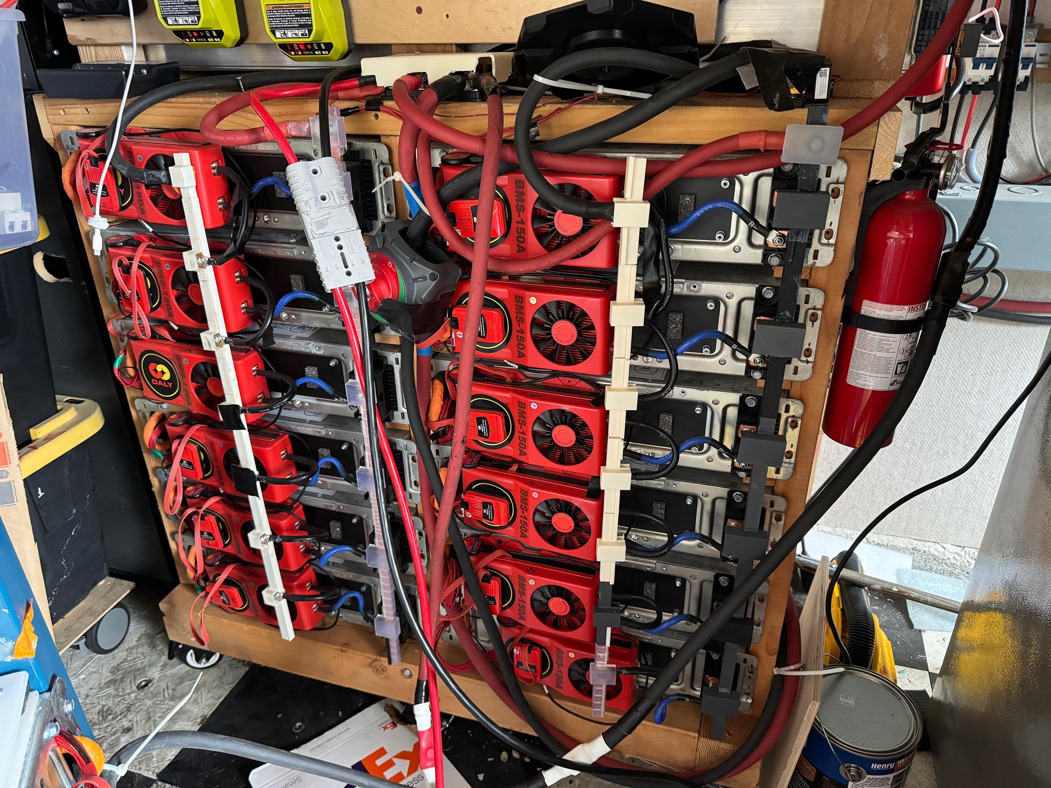

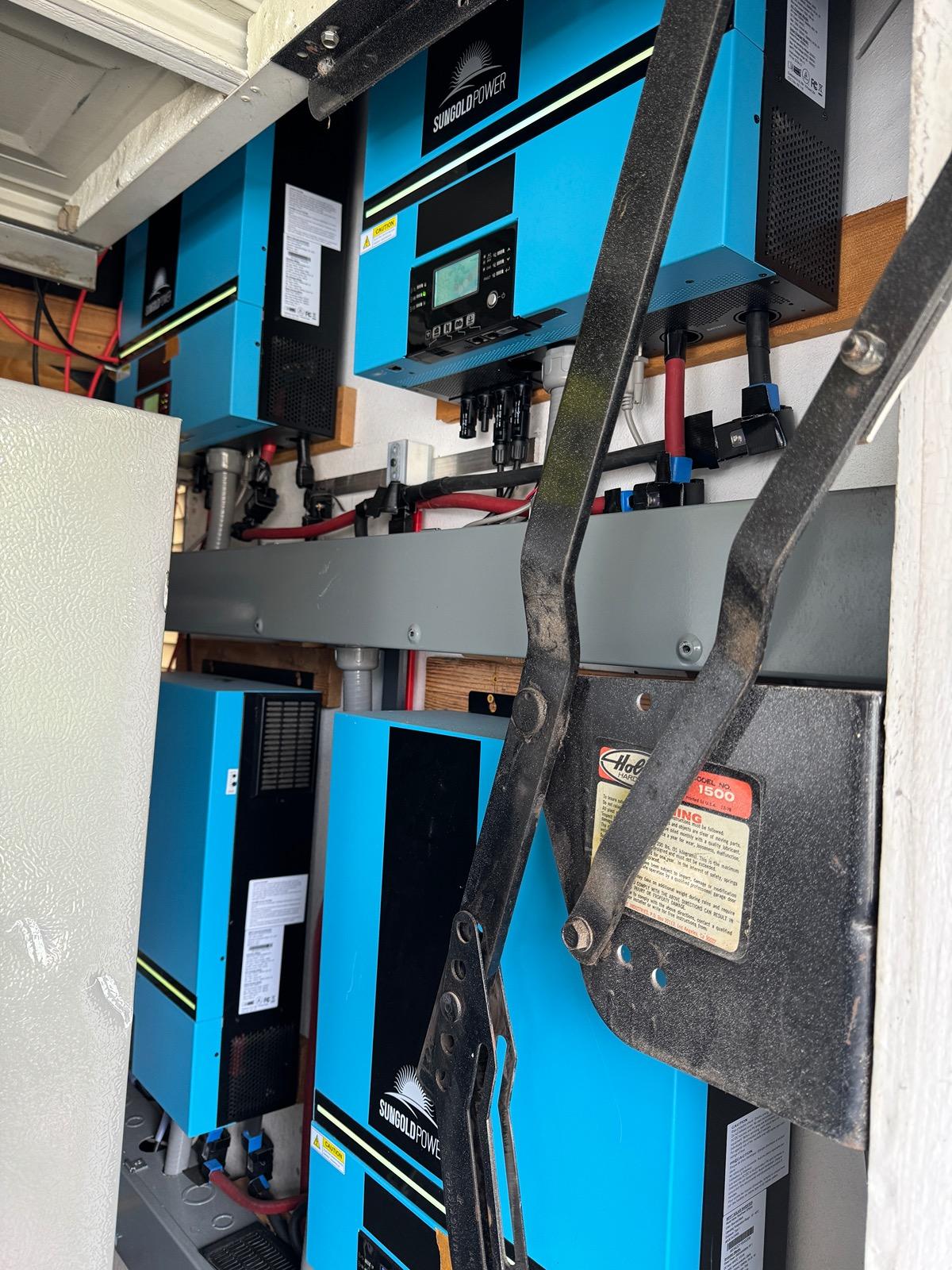

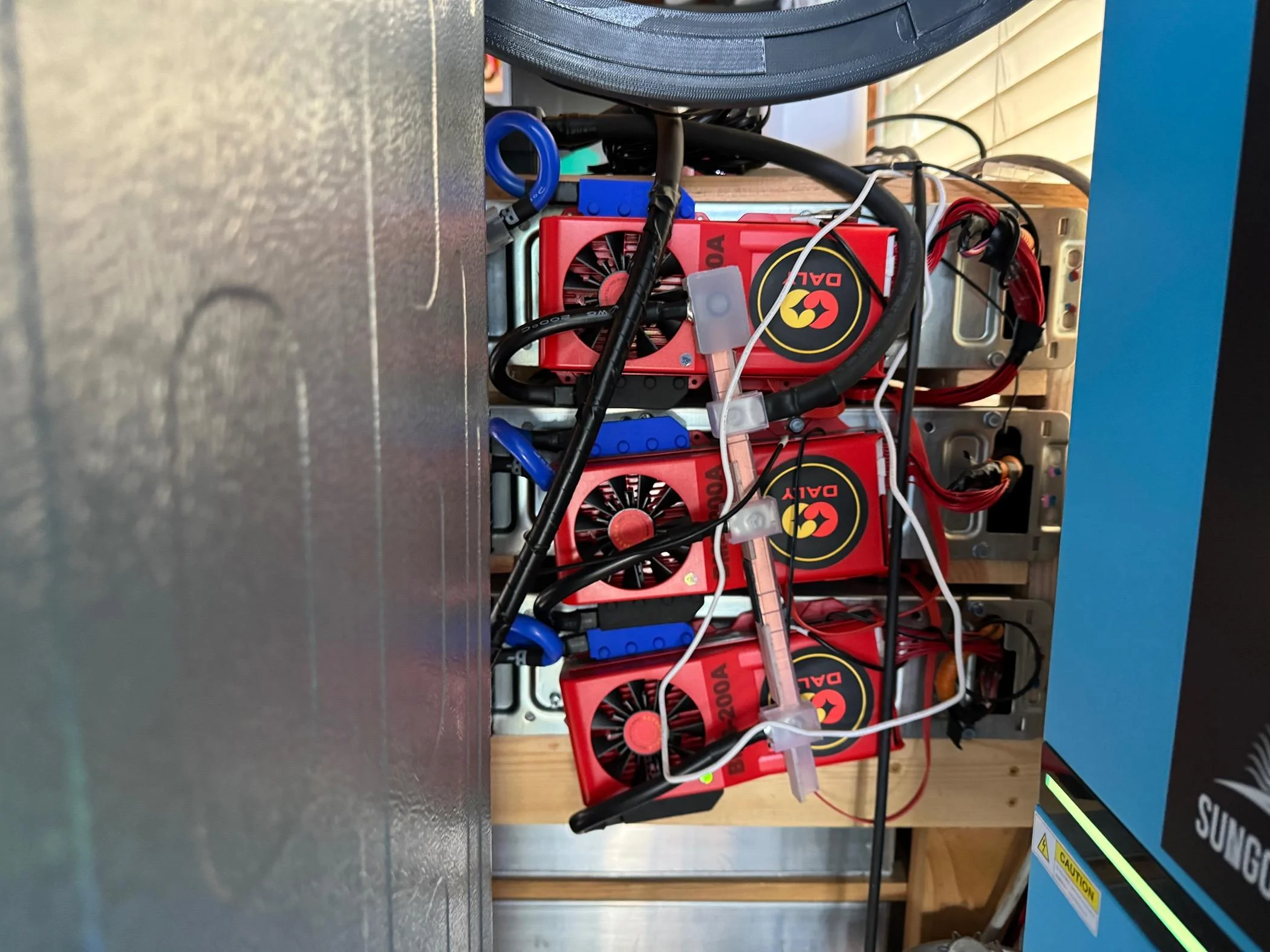

Hey All, Just want to share my CT experience as a power generator. I did all the electrical myself. I live in the city and grid power is not any issue except when there is a power outage (seldomly happens). I have decided to go off-grid experience for myself. First off, I have 10kw of solar on my roof and a 150kW of 48 volts battery pack and distributed by 4 6500watts inverters, connected in parallel to provide a 240volt to my main panel. See pictures.

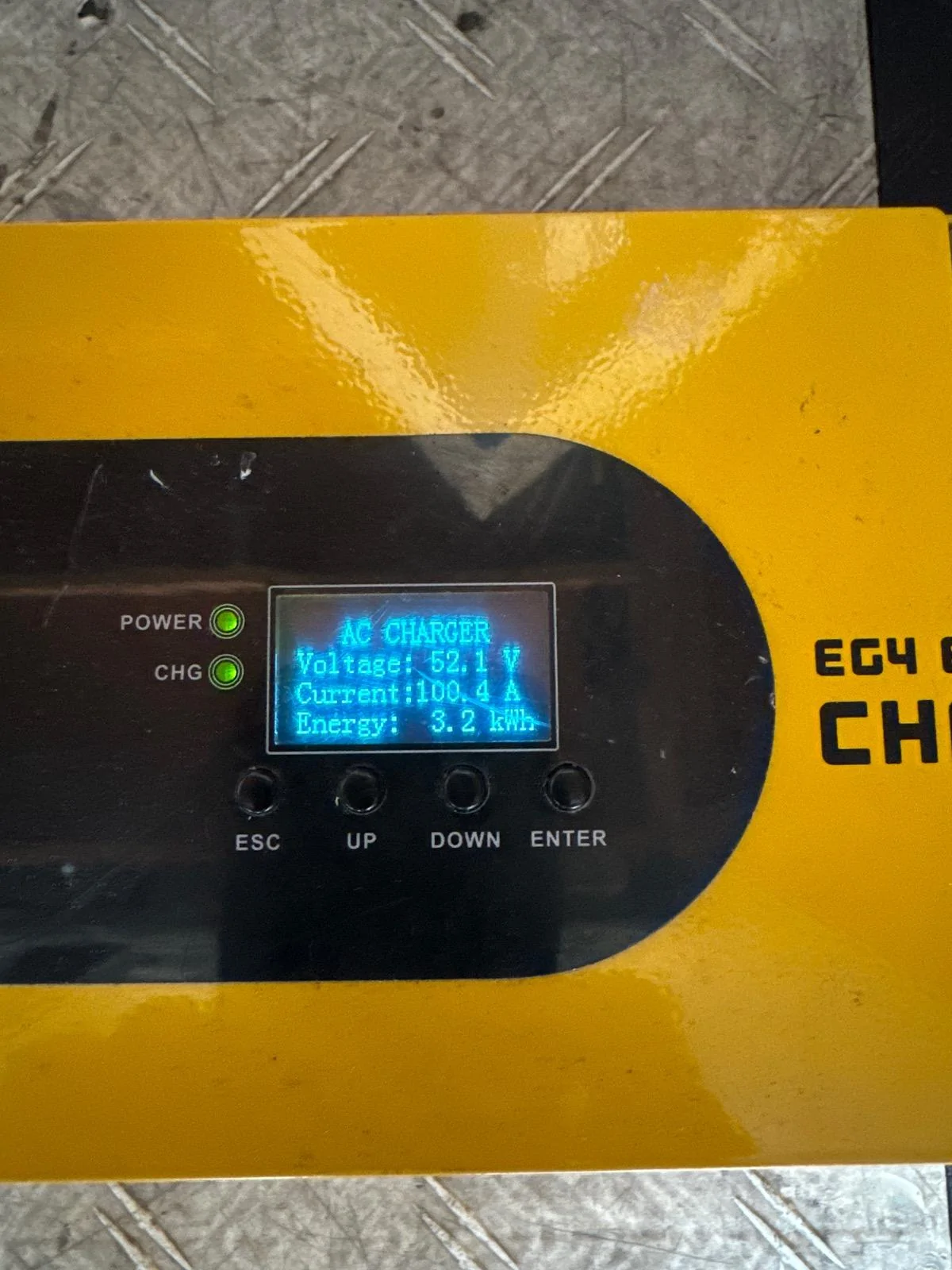

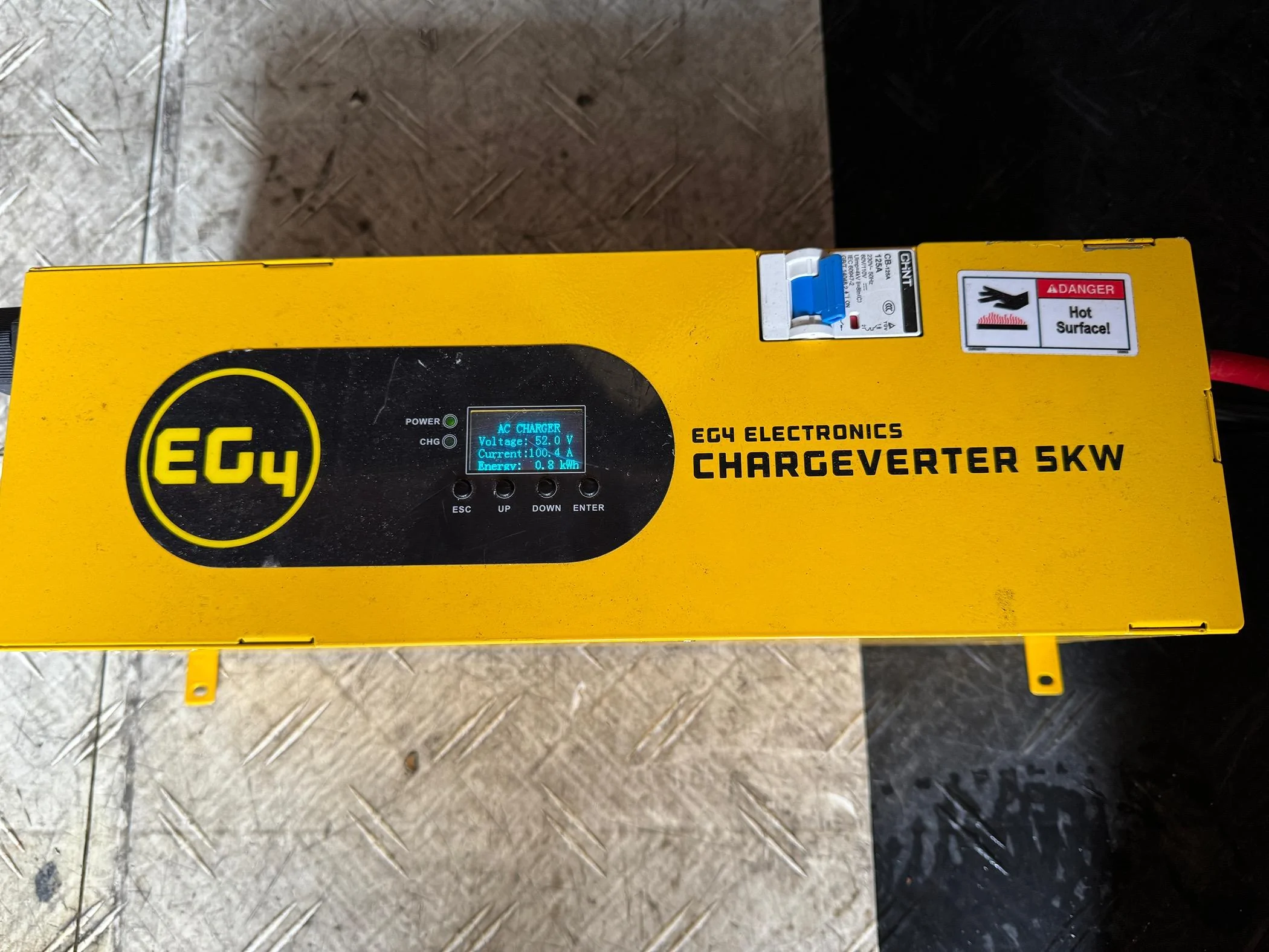

I also have a Champion generator (12500 watts), only 8500 watts out with propane when in use. It’s also loud even with an insulated box. No where near the the CT 240v outlet. CT is giving me 100AMP of charging power and only draw 5.7kW. This is super impressive to me. All my battery pack have their own BMS. I knew all along, the CT is my ultimate tools/vehicle for me. I would say, for my use, worth the $112k spent.

Impressive! The wall charger is providing 57v@100amps? Or is the wall Charger providing the max CT output for PowerShare of 11ish kw@240v? I didn’t know the wall charger could provide 57v… 57v based on 5.7kw@100amps in your example.

Thanks. I was using 48V 100AMP charger using 240v AC. As you could see, I max out the amperage on the charger and it only draw 5.7kW from my CT. I have a 12500 watts gas generator and it could only gave me 30Amp, and it was disturbingly loud. The CT 240v outlet (14-50 plug) is a game changer for my off-grid system. Supercharge my CT when I need to bring power home. It's like going to the grocery and bring home food. I could of gone with powershare but the quote I got was way too high of a cost, so I canceled it. Thanks to the $400 charger I spent 2 years ago.
