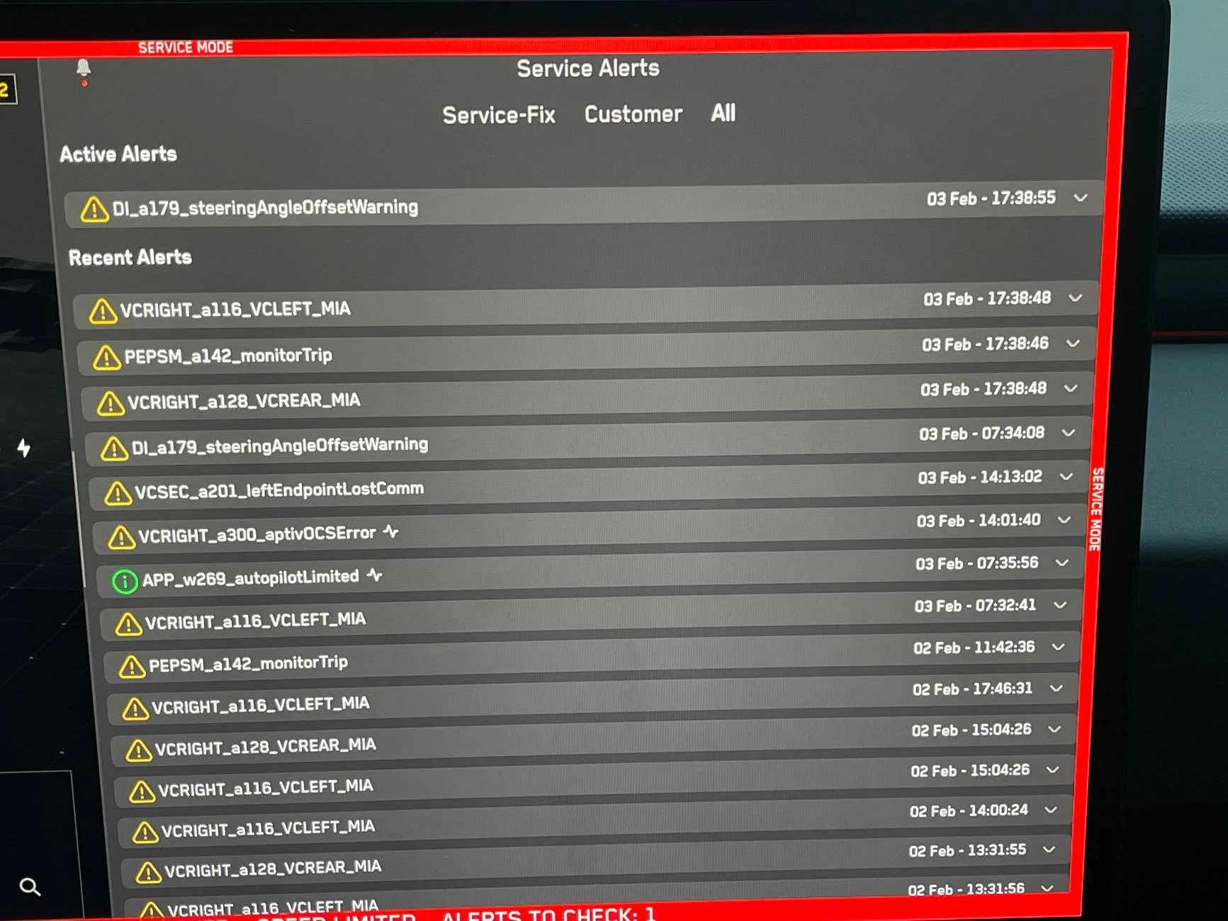

Reading online I learned about the Service Mode and the Steering Alignment Offset. I thought about resetting it as described on the page but I decided against it since I have a service appointment tomorrow. While in the Service Mode I took a look at the Service Alerts page and was quite disturbed.

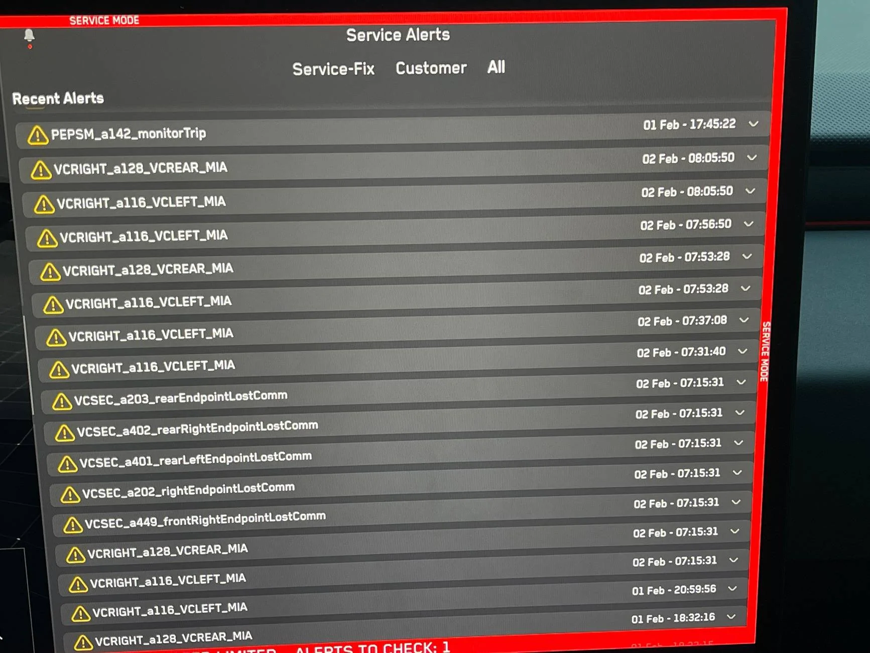

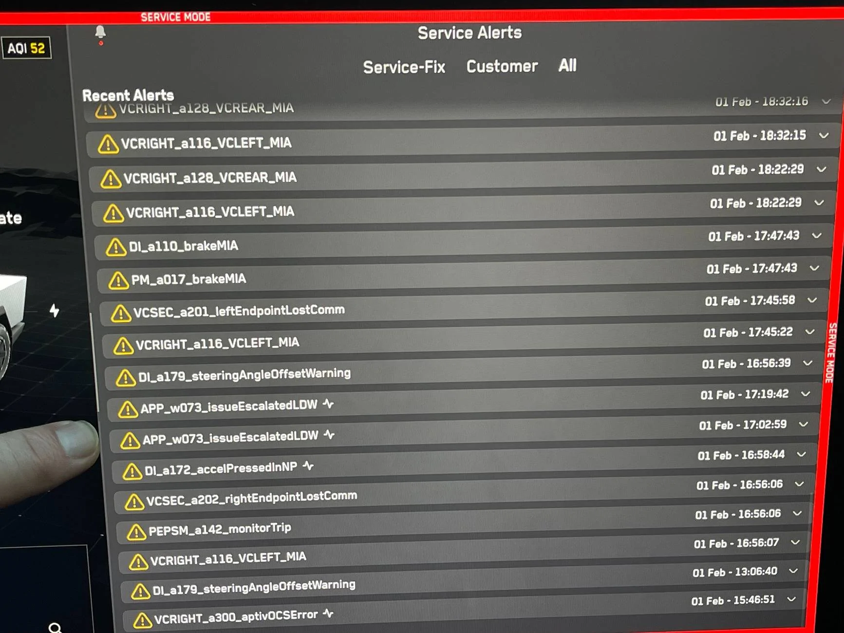

4 pages of Alerts that go back to the 1st. I am assuming that the Service Alert display only goes back so far. Since I don't see any alerts from the 30th or 31st and I know the Steering Alignment Alert that is showing active was there on the 29th and was cleared, then re-appeared on the 30th.
Are all these resolved MIA alerts for ECU computers normal? Or is this indicative of a serious problem?

I assume u did scroll reboot and still see same errors ? Worth a chance to call 800 number and see if they can push software to you versus taking into service …what is ur year and VIn range ?
8,529
10,726
Weird getting a “version mismatch” straight from the factory, but the first update should take care of that.
Keep in mind that Service Mode is not intended for casual customer perusal, and logs rather verbosely.
Activate FSD while braking?
Alert.
Drive without a seatbelt?
Alert.
Open a door with the latch?
Alert.
If there’s a real problem requiring your attention, it will be displayed on the main screen.

Those alerts seem to be 'normal'. Whenever I look, I've got dozens just like that, it just seems to be very chatty. I asked the service guy once, but this was early on, and he said they were still dialing in the benchmarks to make the alerts less chatty.

I thought as much looking at the alerts. Its like they are not giving everything enough time to respond. Just wanted to know if it was normal given the other real issues I was seeing.
I did have a real problem however. The steering angle offset alert was actually for the yoke not the wheels.
After a re-alignment of the wheels, calibration of the yoke, and re-flashing the truck drives straight, FSD no longer hugs the right line, and auto-park no longer has to back in and out several times to park.
