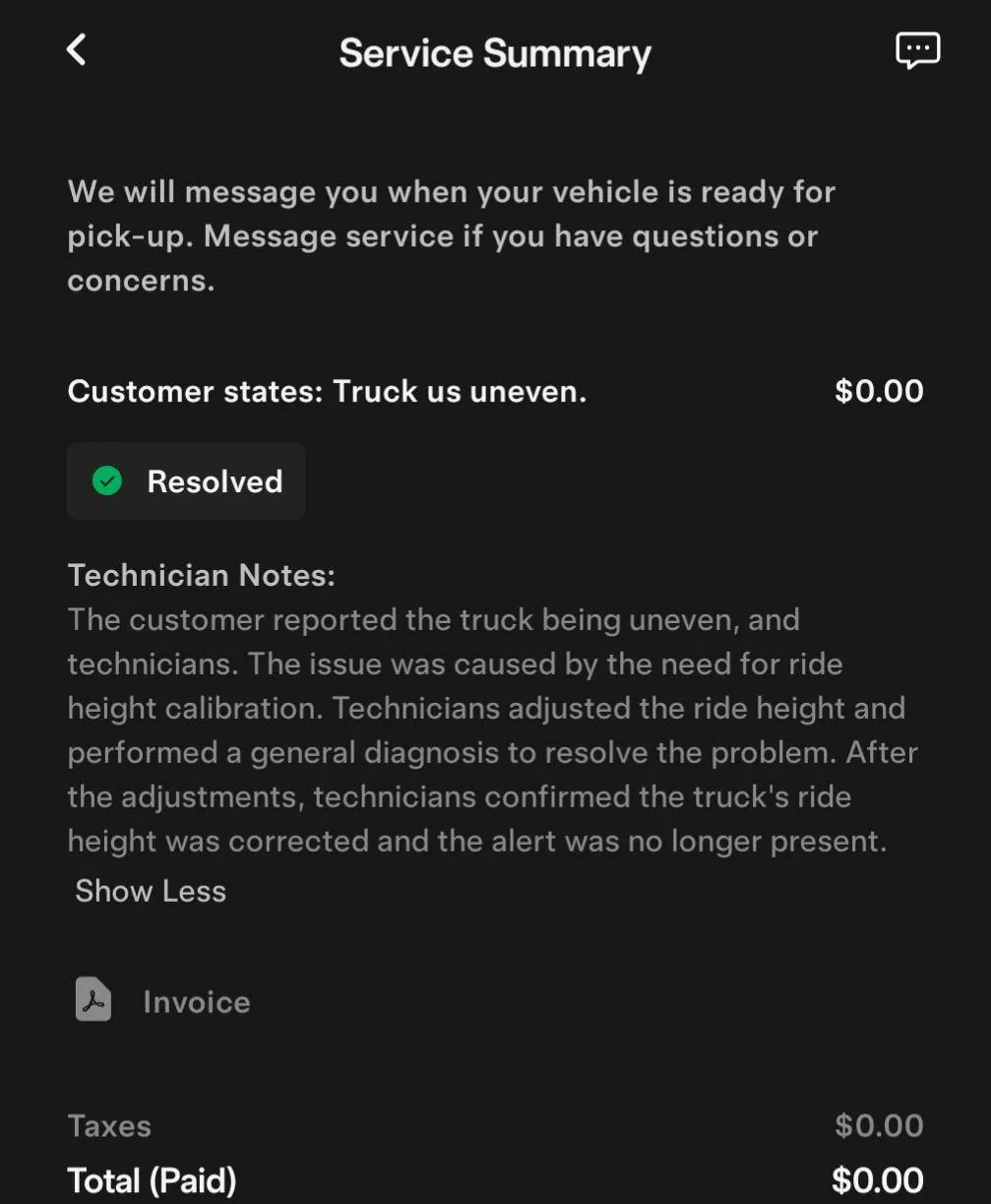

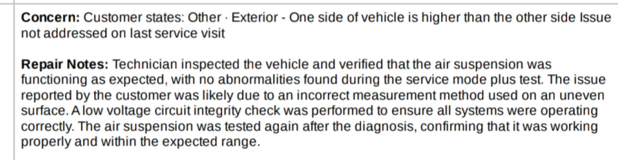

I don't understand how this can be within spec either.... I can only hope they are looking at the same thing but they didn't mention these tests, they just mentioned they measured the rear wheels... They said the did tests and they passed so I have no clue WTF is going on at my service center

And they keep putting these lies that the issue is fixed with every service I have....
Tesla Roadster 2nd gen Need help !!! 1000011149
Or that I don't know how to measure something correctly....

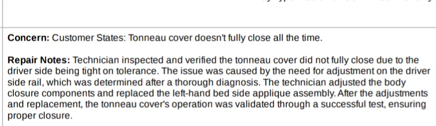

Side note.... I have had continuous issues with the tonneau cover due to an issue with tolerance issues related to the driver side ...
The first service report says that they did need to calibrate ride height. It was only correct afterwards.
It might be losing calibration, or there is an issue with the reference point itself causing the calibration to be wrong. I don't know if the reported values are direct from the sensor, or after calibration offset is applied.

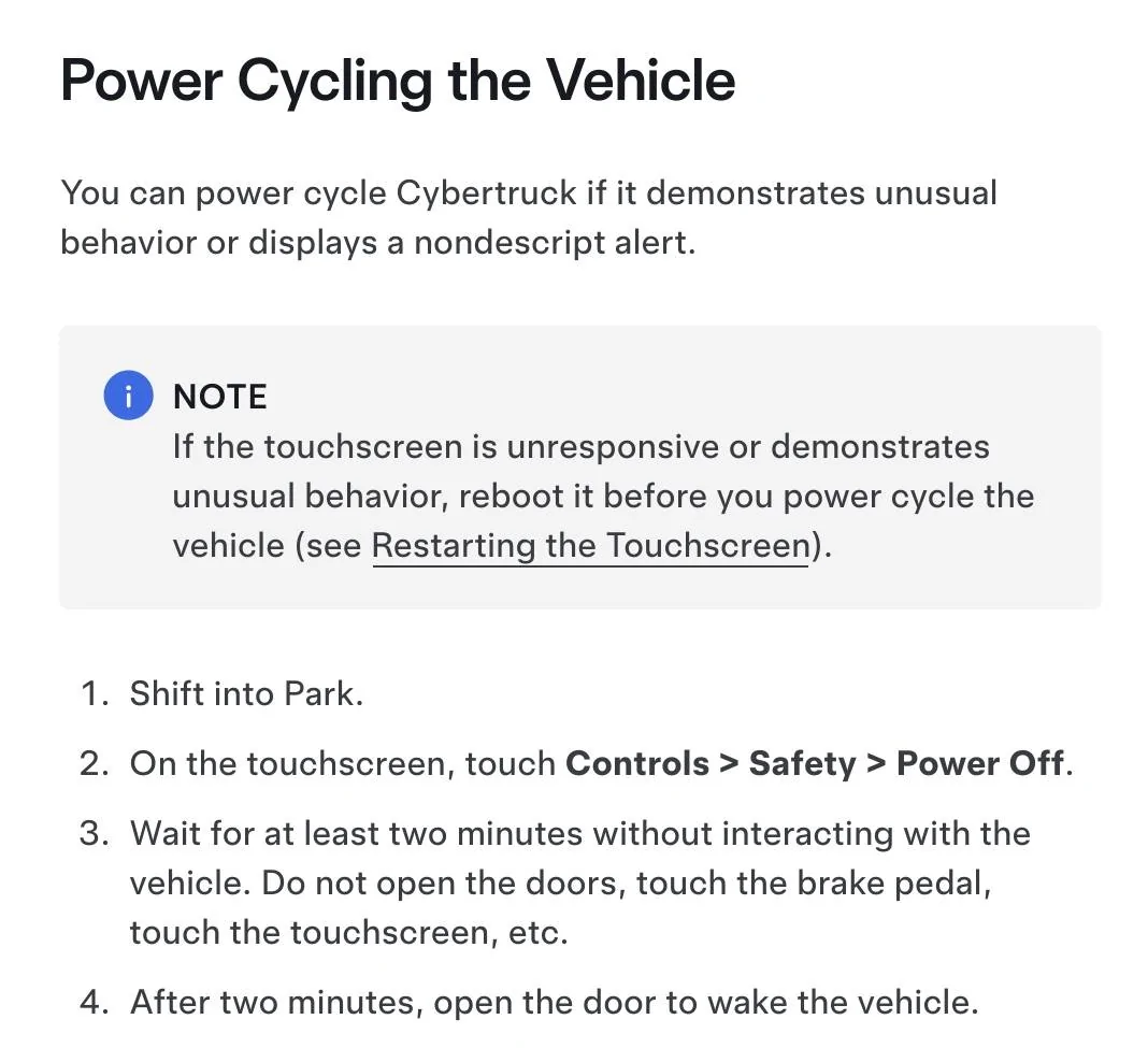

Have you tried rebooting the truck?
Start with touchscreen reset. If that doesn't work, try power off.
I will give it a shot, but I dont know why they put these notes in the service call as the service manager herself told me the issue was not fixed.
