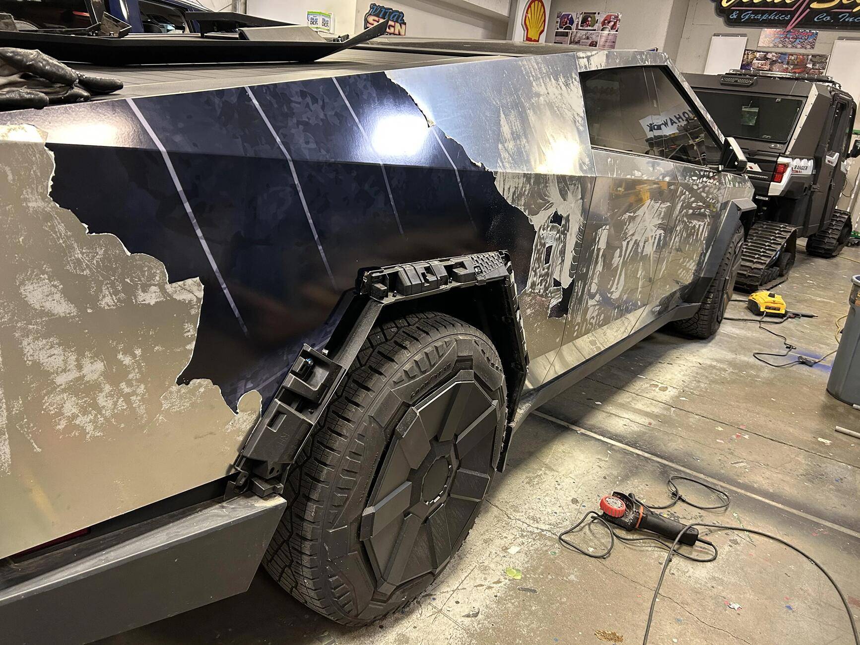

Does anyone have experience with removing the wraps (vinyl or PPF)? I've seen horror stories of the adhesive sticking to the panels.
Vinyl wraps can be tricky to remove - you need to heat it a lot and remove slowly, and still depending on the vinyl it may not work out so great.
We do PPF wraps though and here is what removal looks like:
With that said you still need somewhat warm environment - best done in the summer after the CT has spent a few hours in the sun, otherwise heating is still recommended if the wrap is not pulling well and leaving glue lines.
