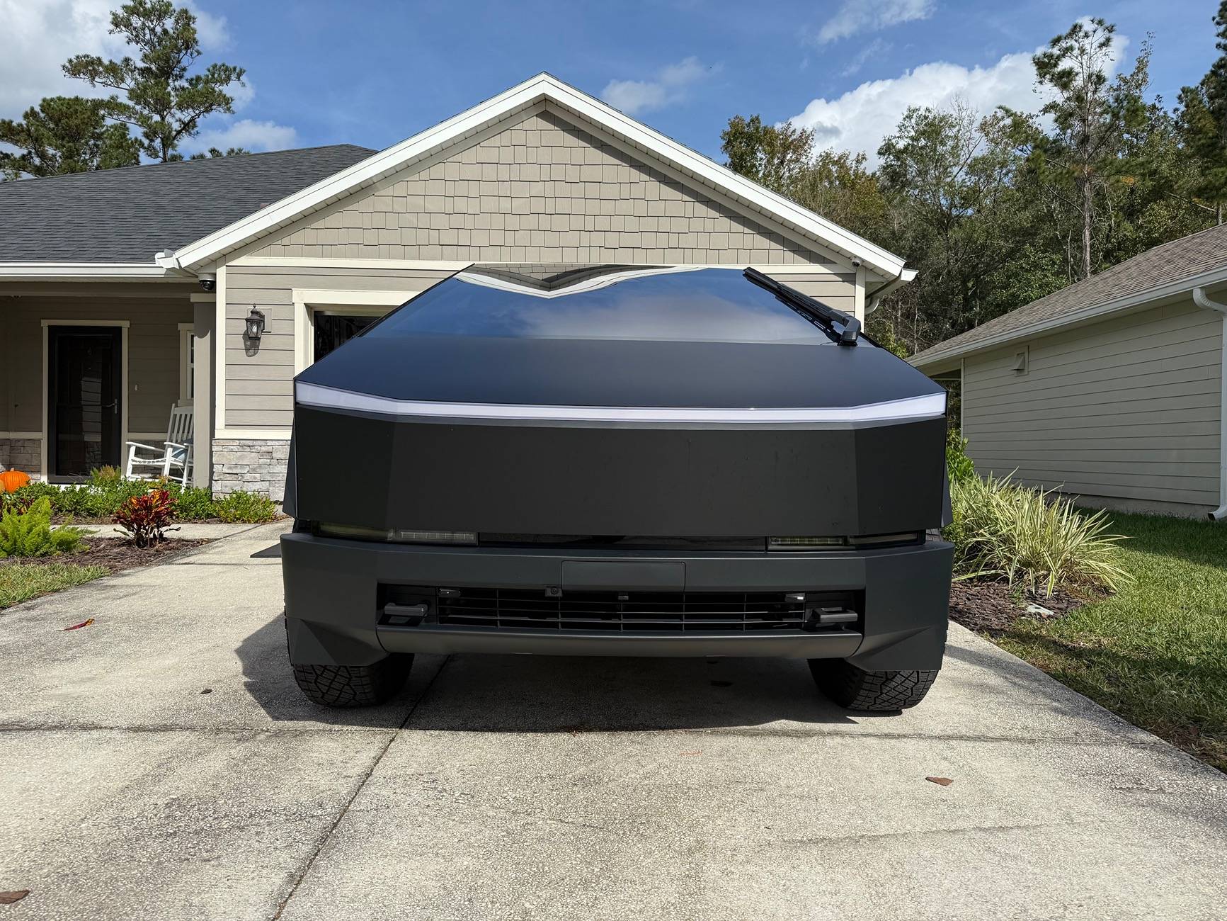

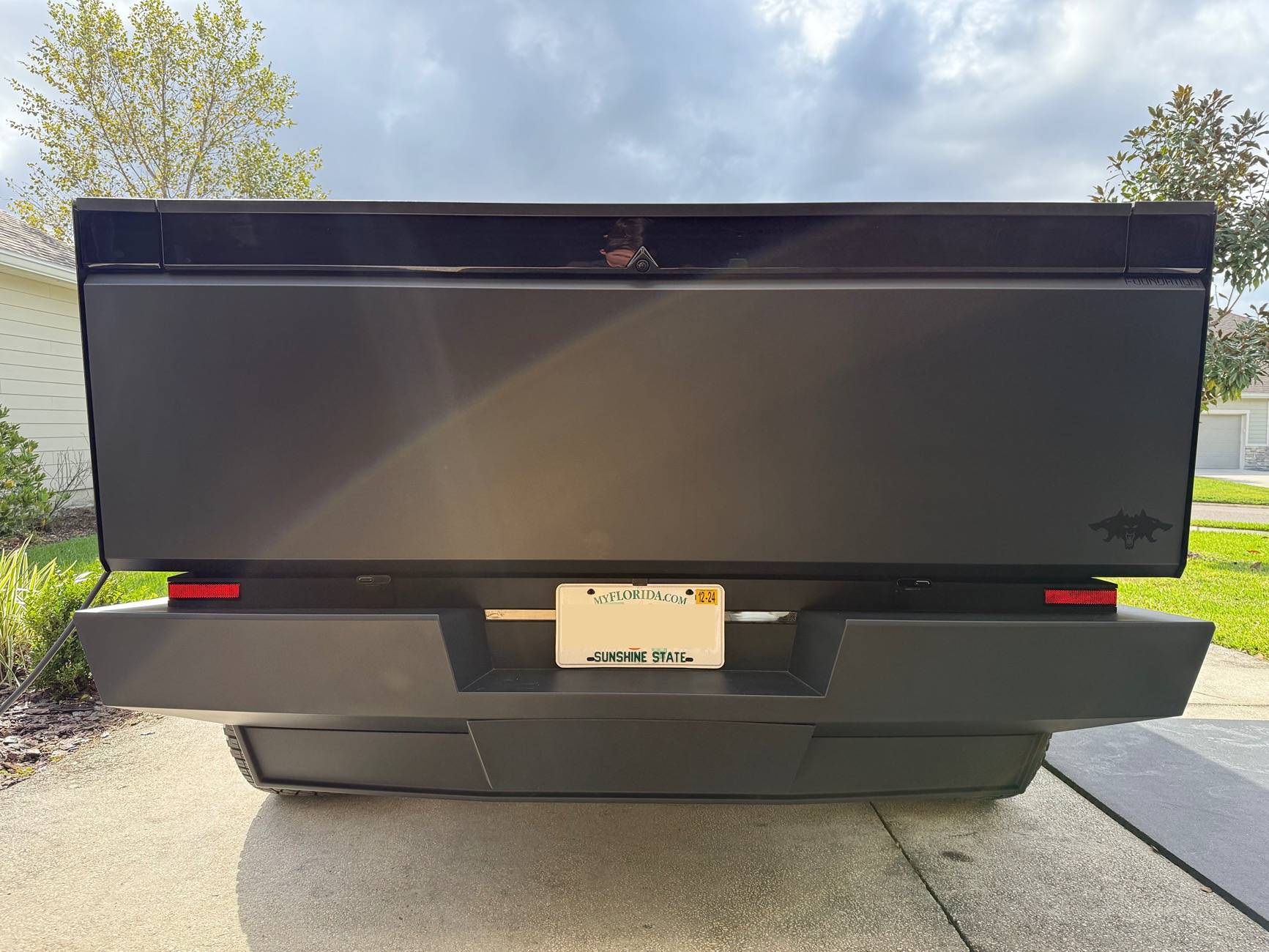

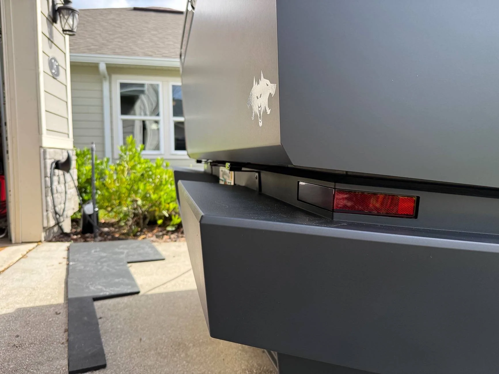

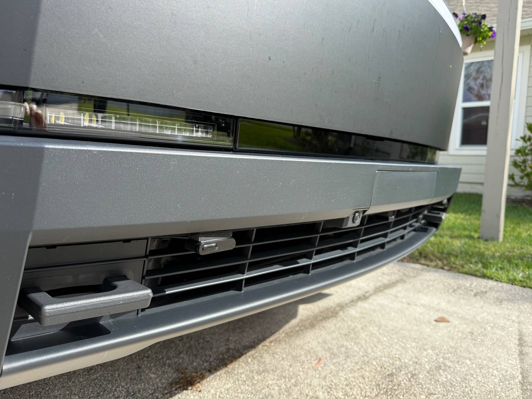

Here are the long awaited pictures. Sorry about the delay. I had a cold for what felt like a month and couldn't seem to shake it.
I drove down to Tint World in Orlando to get this work done and they did a fantastic job! Man I am so impressed with the quality of the install.
The interior install is so clean. You can see the controller below the screen and the other LED on the far left. I might move or remove that LED. need to live with it for a bit first.
The CPU and wiring can all be accessed by removing the kick panel below the console. It's the panel thats completely horizontal (like a ceiling) and has a cut out for the LED footwell light on the passenger side. I LOVE this. it's super easy to access and work on if needed.
They installed 6 laser heads and 2 radar heads. The laser heads are visible and the radar heads are behind some trim pieces. The radar heads can see clearly as long as there isn't any metal in front of them (i.e. they have to be behind a plastic bumper, not metal). The radar heads are not as sensitive as I remember them so they might be partially eclipsed by metal. As a result, I may move them around a bit but more testing will be required.
Regarding powering the ALP, I know they took a constant power source from the trailer power (the circuit that powers trailer lights) and then used another circuit for the switch wire of the relay but I'm not sure which circuit it was. They intended on using the rear view mirror power (since it's unused) but it turns out that Tesla changed that one to be always on via a software update so they had to go to Plan B.
I was happy with this since the truck should already be expecting a variable load from the trailer lights and the other circuit is just used to trigger the relay. My ALP system turns ON and OFF with the center screen.
Here are some pics of the inside and the outside.
Let me know your thoughts! Also happy to answer questions if you have any!
